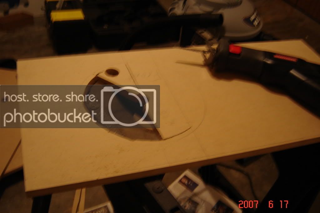

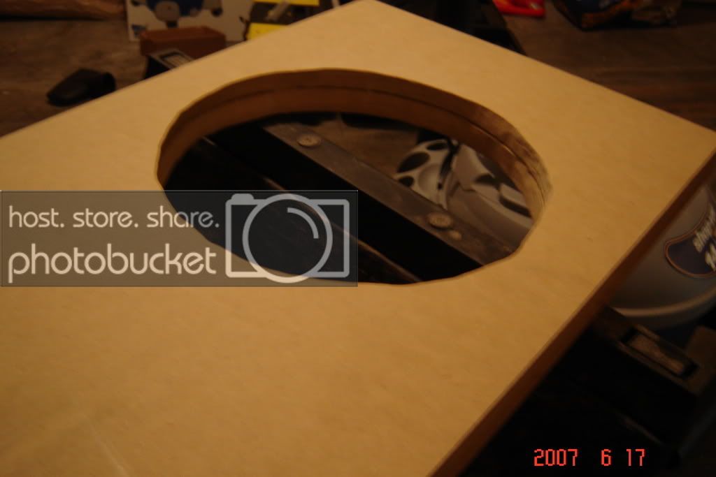

I started on this box yesterday evening, and I finished up on it today. Even after all the careful planning I did, in the end, I forgot to put the braces in. WTF? The design if from Chris (AKA IONSQL), which is pretty basic, but made for my sub. I used a crap load of tools: Dremel, Jigsaw, Sander, Silicone II Caulk, Drill Driver, Hole Saw, etc. Overall, I think this box took me well over 8 hours. I have never done a Vented box before, and now I know first hand, how laborious it really is. Kudos to those of you that do this everyday. Well, here comes the pics.....

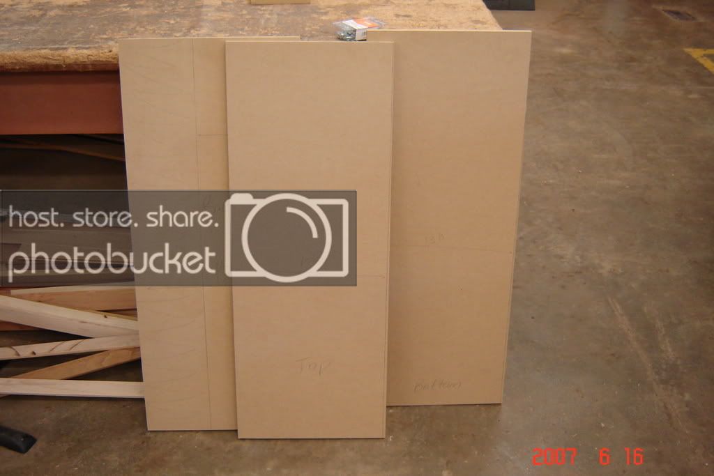

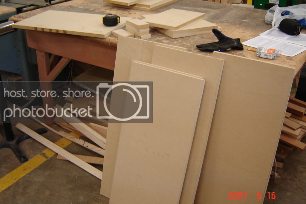

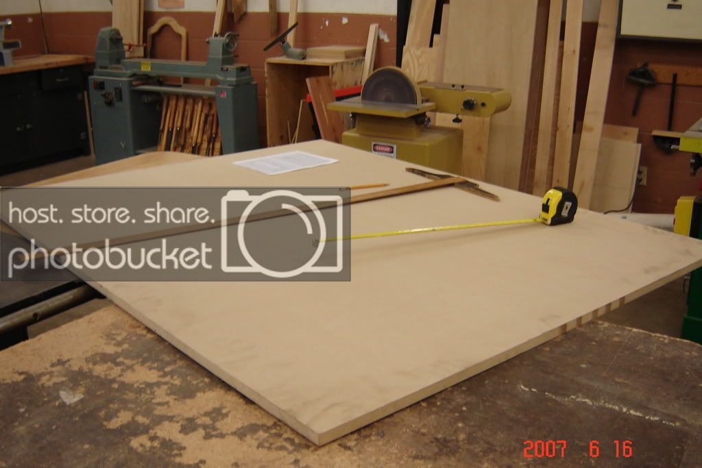

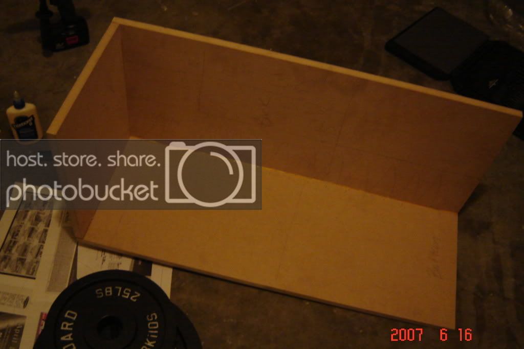

3/4" MDF 49X97"

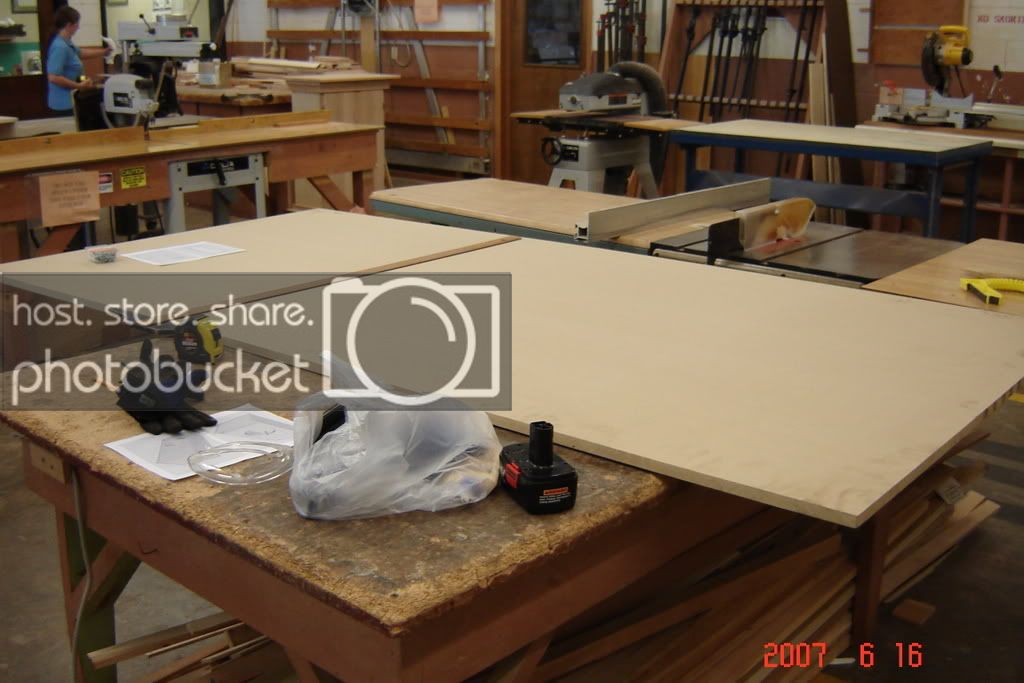

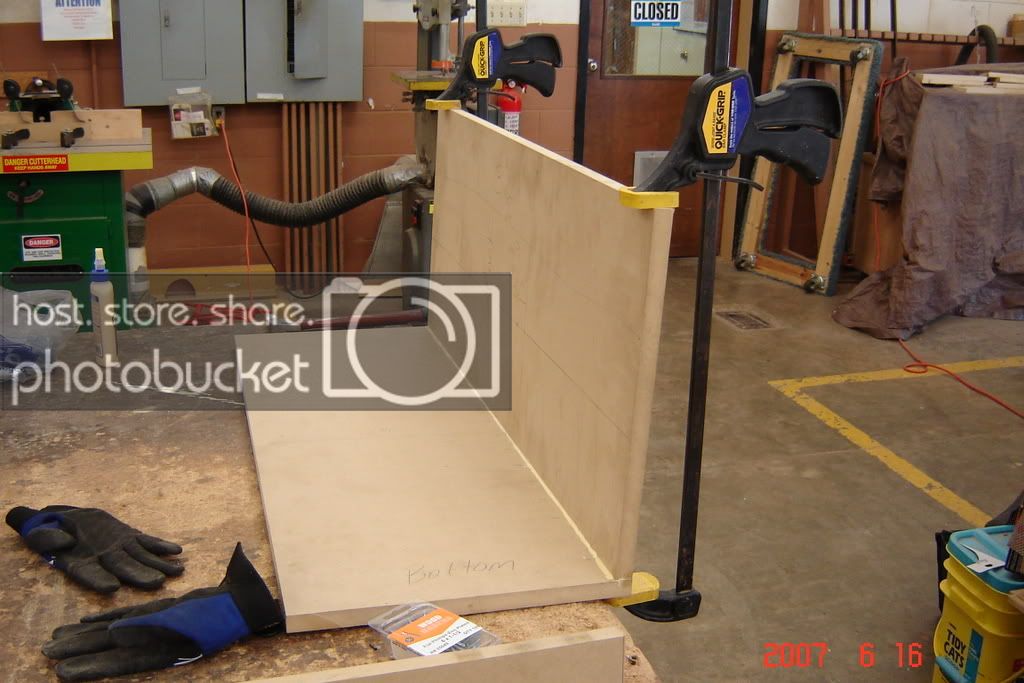

First Few Cuts, using the Table Saw

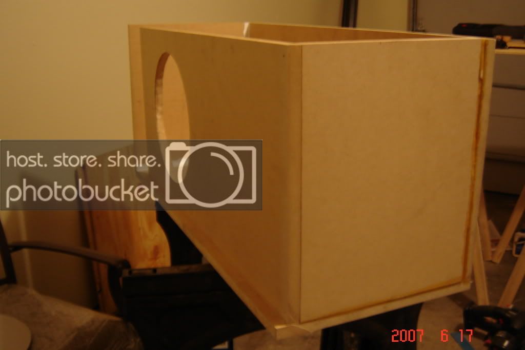

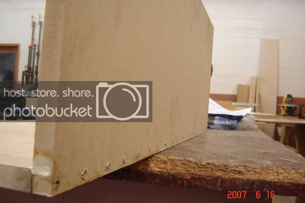

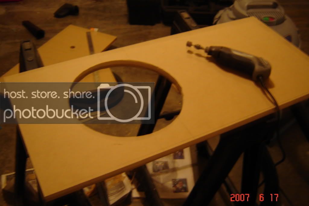

Now here comes the Silicone II Caulk. This stuff is about $5 per tube, but IMO, it is well worth the money spent. Sticks to the MDF very easily.

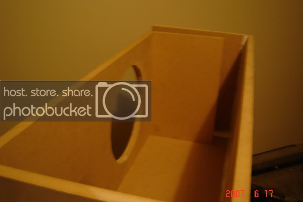

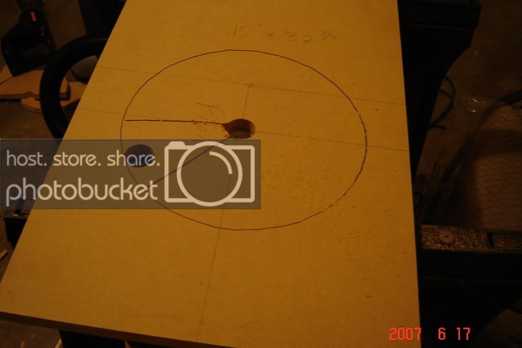

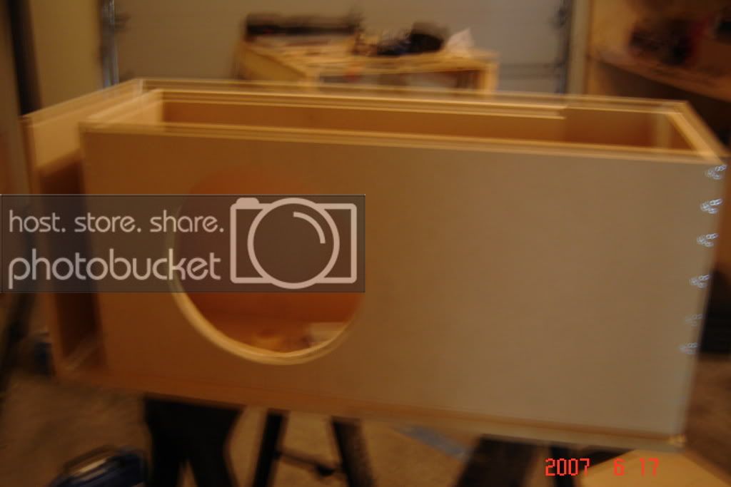

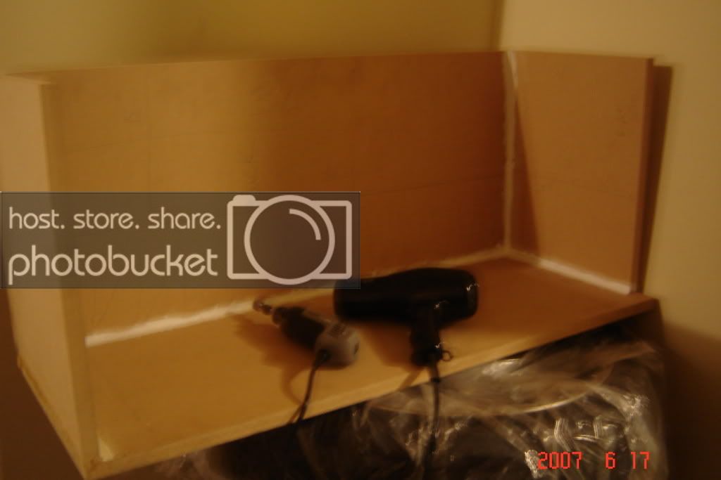

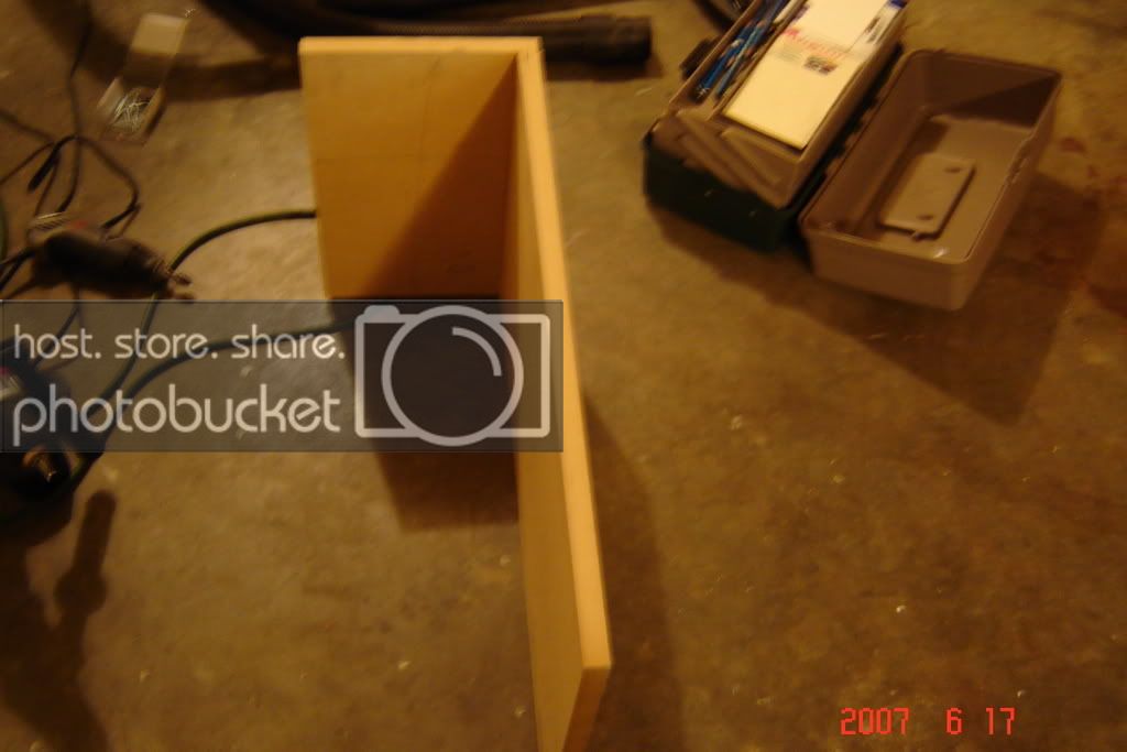

Well, here's the front wall and the port. While doing the port, I almost made the mistake of screwing down the left wall first and then trying to put the rear port in. Well, had I done this, I wouldn't have been able to install the rear port.

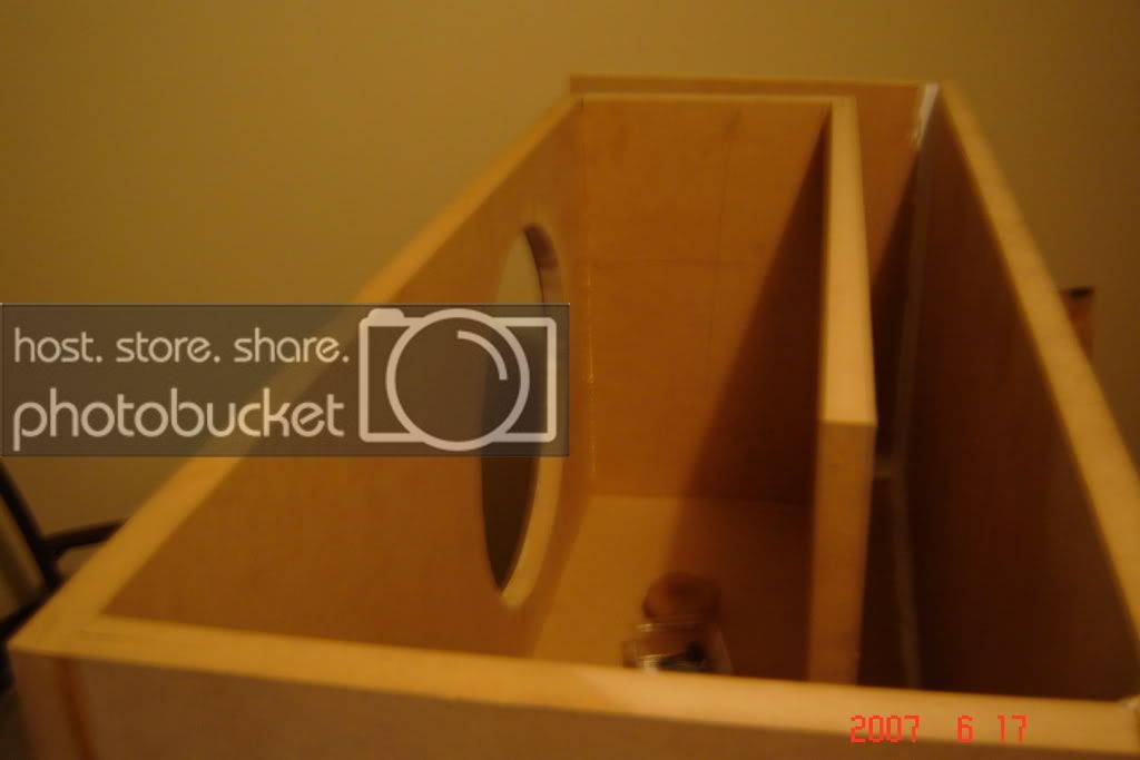

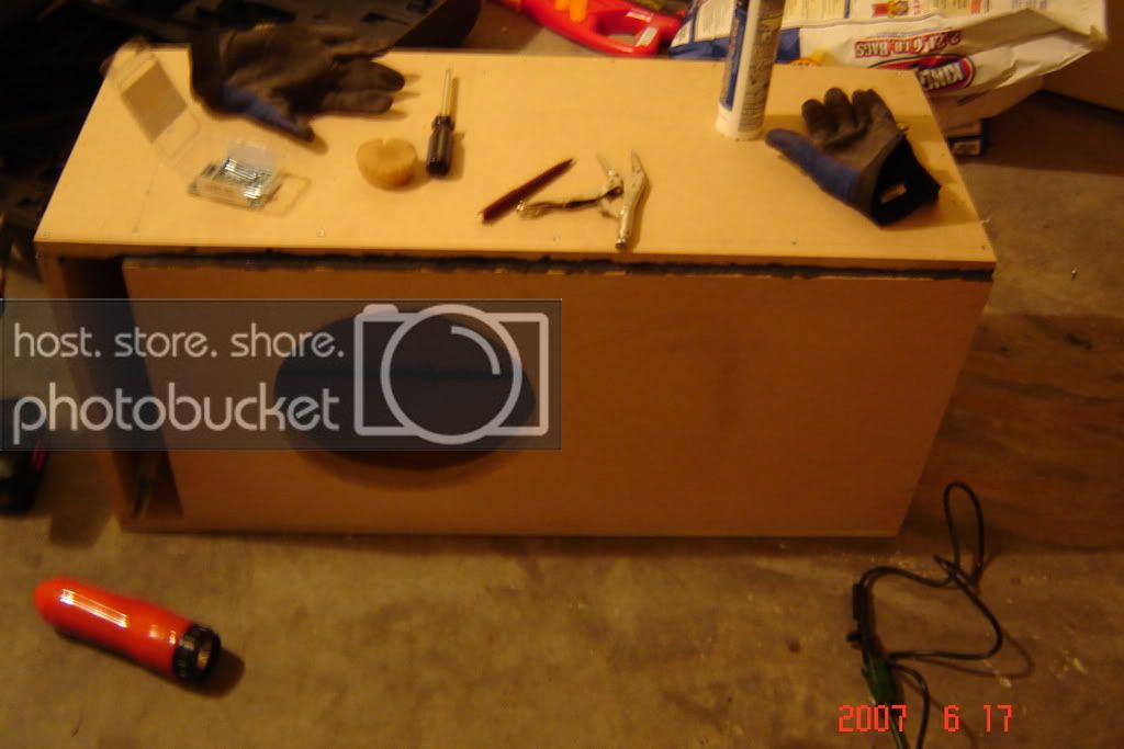

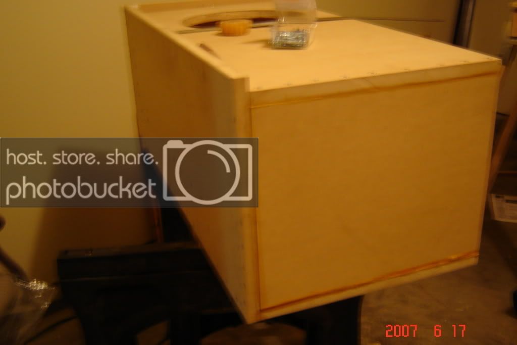

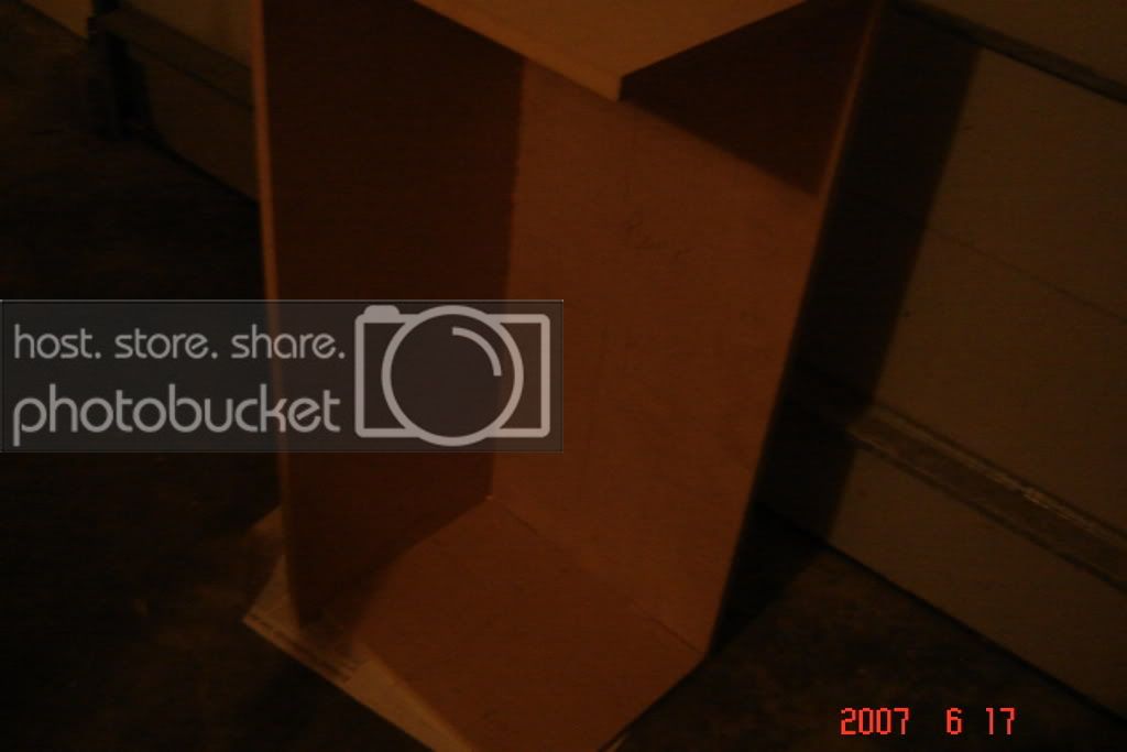

Looking at this pic, I notice two things right away:
1) No, that is not a *****, it's actually a flashlight that my wife was issued in Air Force BMT in 2005
2) I actually had about a 1/4" overlay on that second baffle. It sticks out just a tad bit, and I put a crap load of Caulk up at the top.
Looking at this pic, I notice two things right away:1) No, that is not a *****, it's actually a flashlight that my wife was issued in Air Force BMT in 2005
1) your wife wants you to think she just uses that thing for a flashlight:)
2) the box looks good
