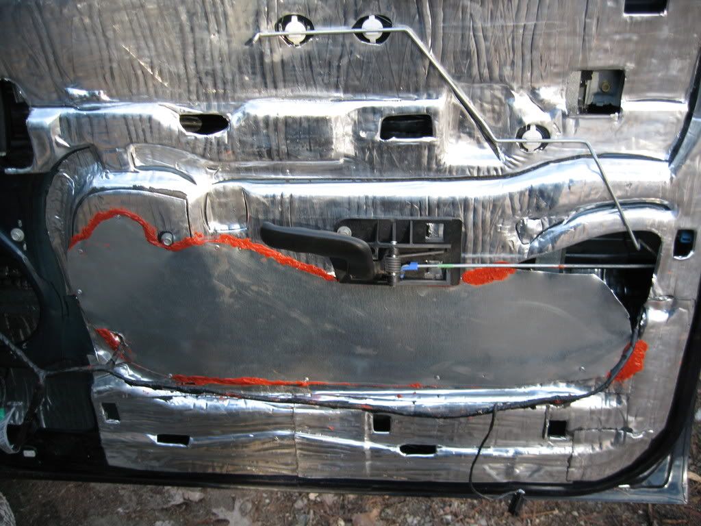

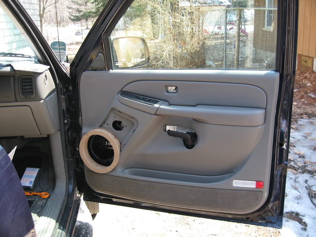

The door is deadened. Except where the speaker will be since I have to cut. Gotta run up to the hardware and grab some flashing for the holes of course. I also have luxury liner from a Limo shop for free so I will use that on the doors as well.
This is the idea basically. Just some cut to fit and paint to match left on that.

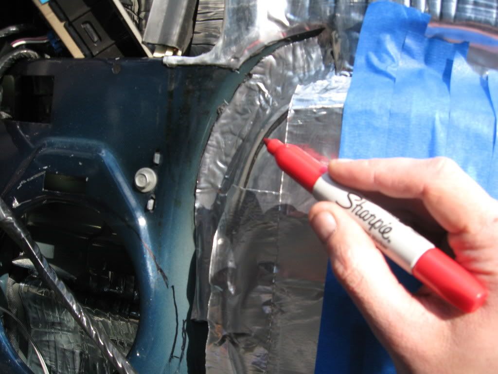

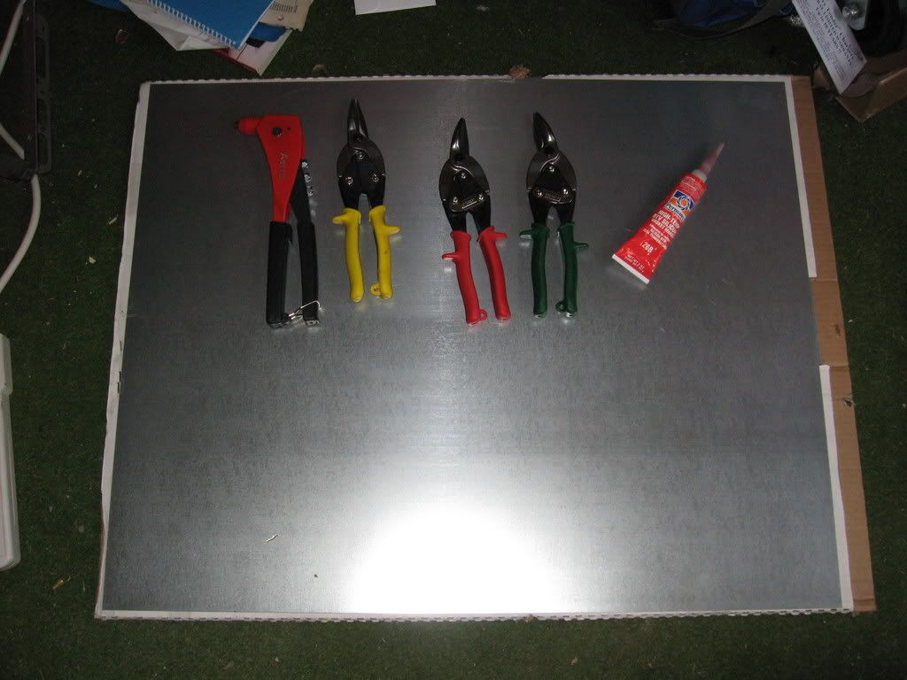

I ran up to the hardware and grabbed some aluminum.

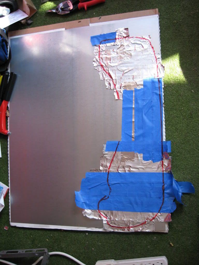

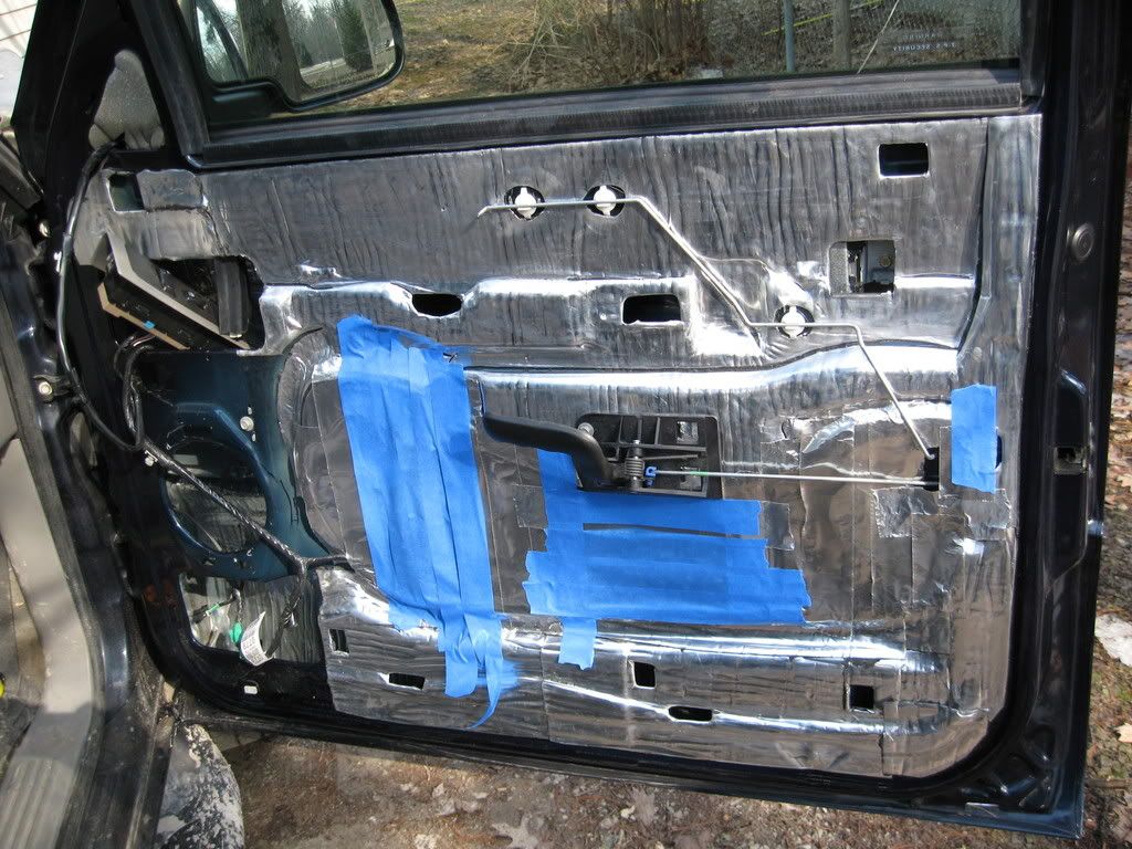

Then I went out and threw some tape on to make a pattern...

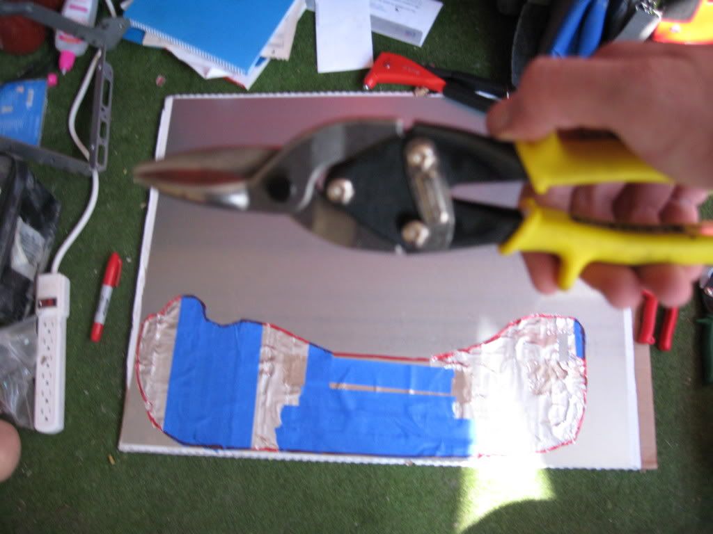

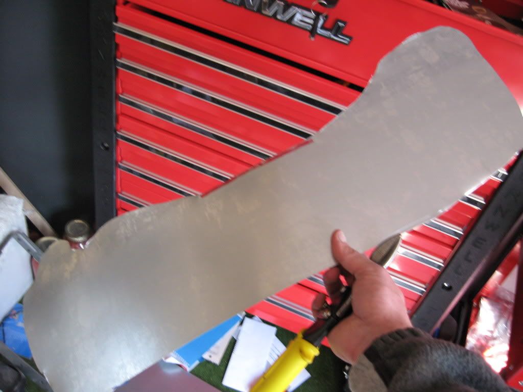

Peeled it off and transfered to my aluminum...
Proceeded to cut it out...

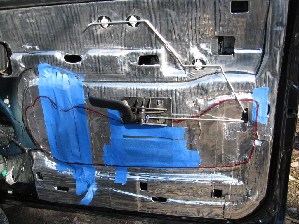

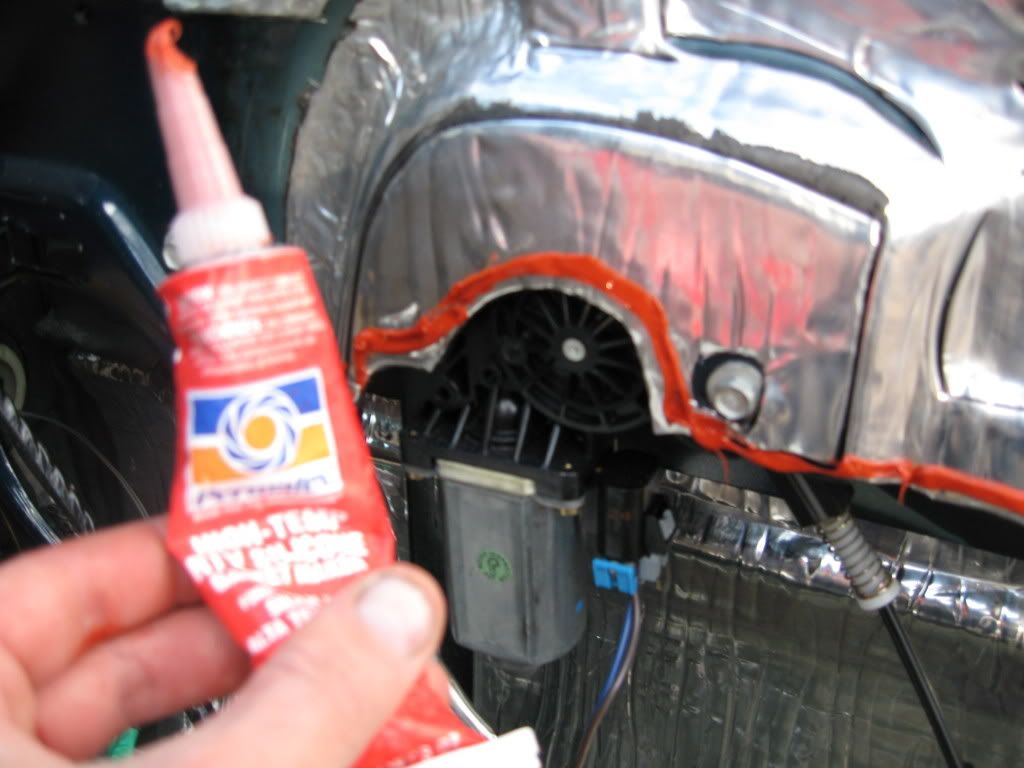

A little RTV to maker bond a little and seal some...

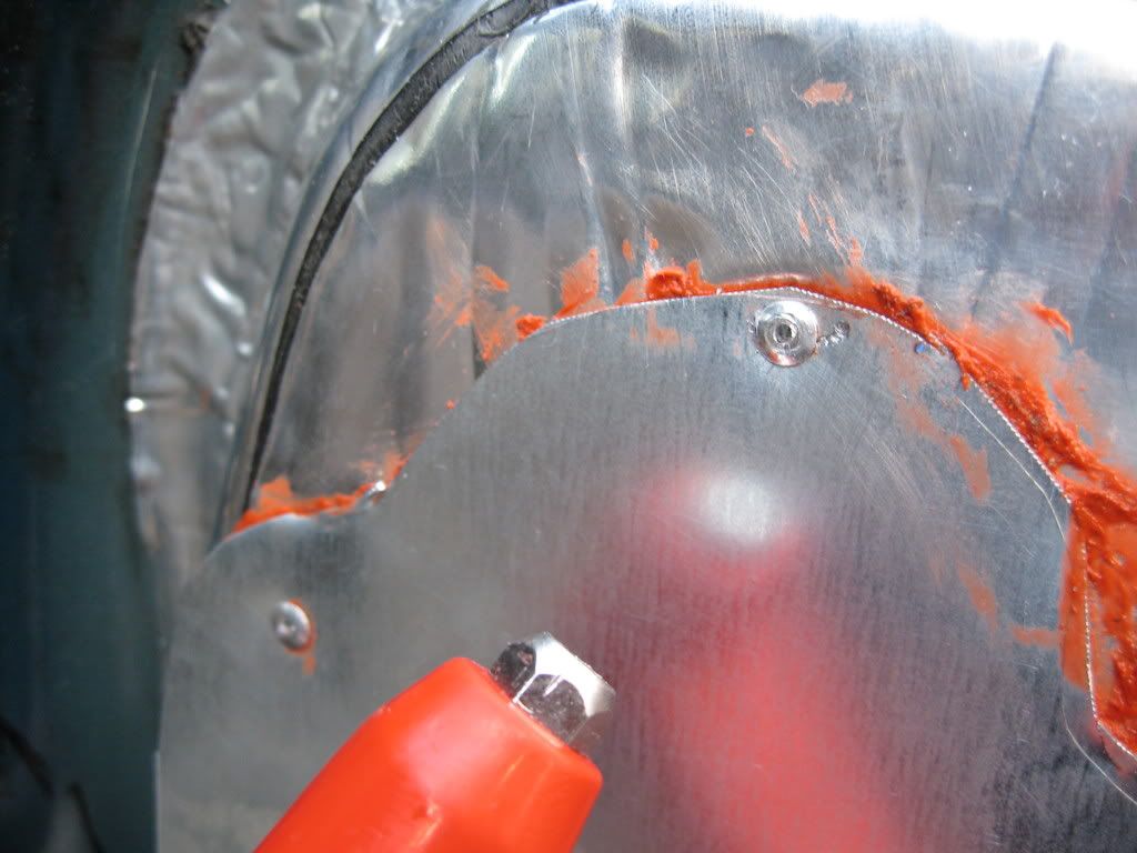

Drilled holes and riveted....
And had to make extra cuts here and there and have to compromise and make some other pieces for the hinge bars and such. This is where I stop for the day.
Good job man! Your going to put deadener over the aluminum pieces right?
Sho nuff! One other treatment of limo head liner too. Nothing like Second Skin its thinner but has closed cell backing and will the do the trick.
