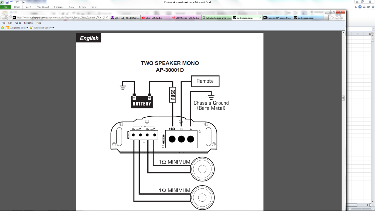

If you connect 2 subs to this amp the manual clearly shows they must be no lower than 2 ohms each. This is because the positive and negative terminals on the amp are bridged internally, so the dual 2 ohm load becomes bridged to 1 ohm. This is exactly what you've been told already.
Ok, you are incorrect as well.
Well I guess the Chinesse cant get the manual right then. Mono means one. This is a mono block amp. This is a one channel amp. It is 2 1500 internally strapped. Strapped 1 ohm amps need a 2ohm load when they are strapped. If you wired it like that it would see .5ohms final
You are completely incorrect, let it go
