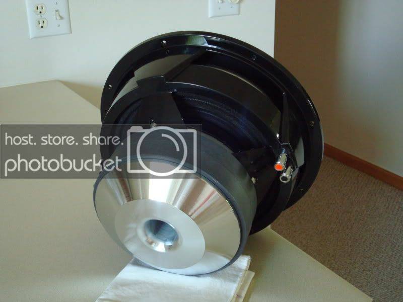

So here's how it stands after about 25 minutes of Mother's on the top:
You can see the difference between the top (again, 25 minutes of Mother's application, I think it was 3 coats) and the bottom (no Mother's, that's how it all looked after I got done scrubbing the oxidation). This stuff is good. I might try the other 2 polishes I have (Nevr-Dull pads and Blue Magic metal polish cream) on the bottom and see how they do, but it's hard to argue with the results of Mother's, even only the little time I put in.

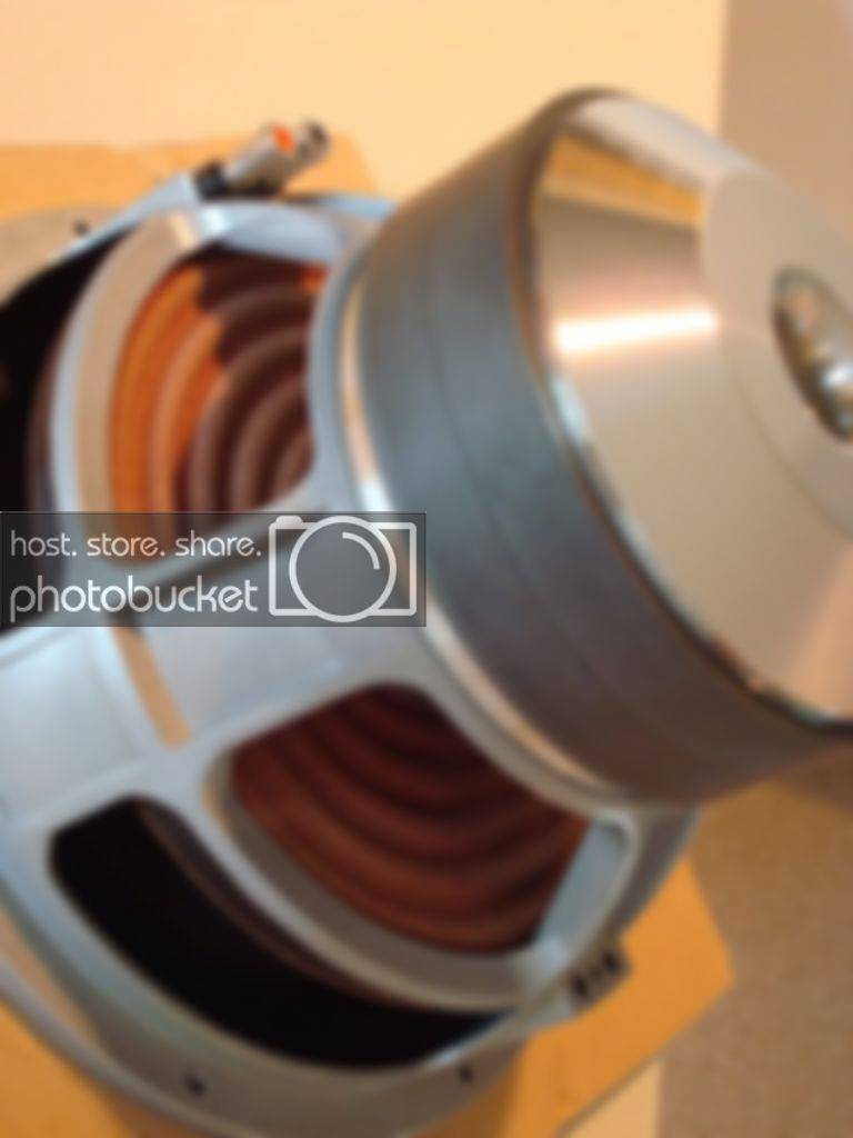

I have those pads and Blue Magic that I'm going to try on the bottom, see which one of these three works best.
Verdict: I like the Mother's the best. The Nevr-Dull is just not abrasive enough, might be ok for a later, final polish step, but not useful now. I really couldn't tell a difference between the Blue Magic and Mother's in the final product, they both did well. The Blue Magic leaves a film on there, which would be good for only a polish on metal in automotive applications, but not useful to me as I would just strip that off before I clear-coat it, though still a plus there. Why I like the Mother's better though is because the Blue Magic stinks really bad, and is also harder to wipe off. Mother's is just easier to work with. But again, couldn't really tell a difference in the polished metal.
