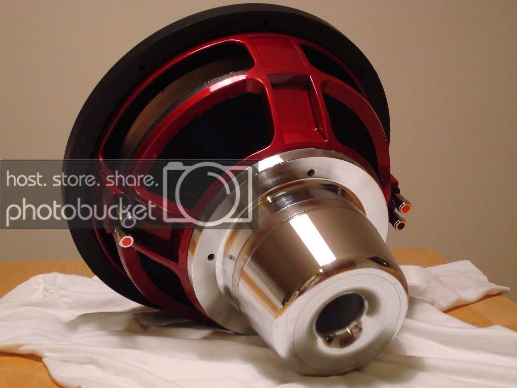

Well I went out and bought some steel wool, still really slow taking that stuff off. The scotchbrite actually seems to work better, which is odd. I've been working on it for literally about 5 hours now, and here's where I am:
Not the best picture, but you can see it's clean on the right side, except for the outer edge, and a little in the middle. It's coming off, but slooooooooowly. My hand is starting to get sore lol.

Looking good. You're gonna be so angry when I tell you that citrus stripper allows the clear coat to be wiped off after sitting for 10-20 minutes, lol. Maybe you can try it on the other one.
It'll all be worth it. When you get the shine you want, you may consider a new clear coat to protect your hard work. Otherwise, it will quickly fade with the condensation of daily use. And don't touch it! You get acid-etched fingerprints, lol.
