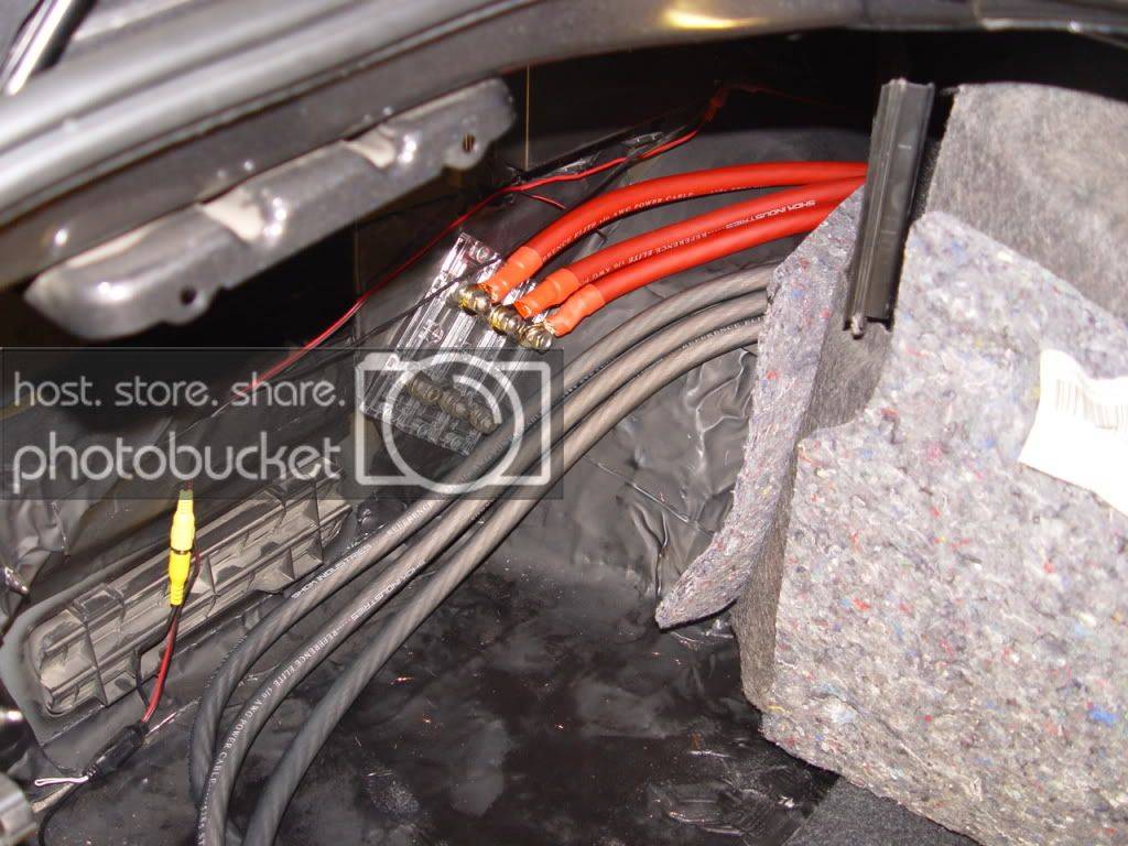

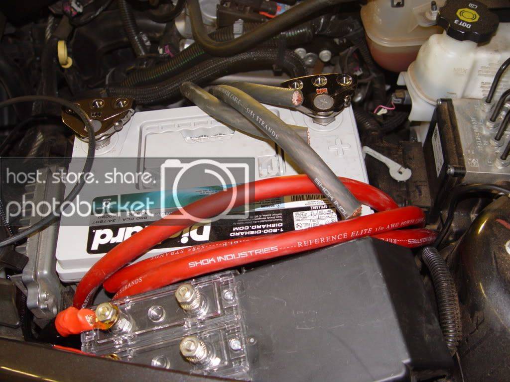

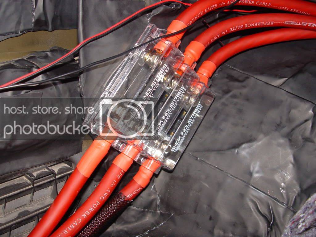

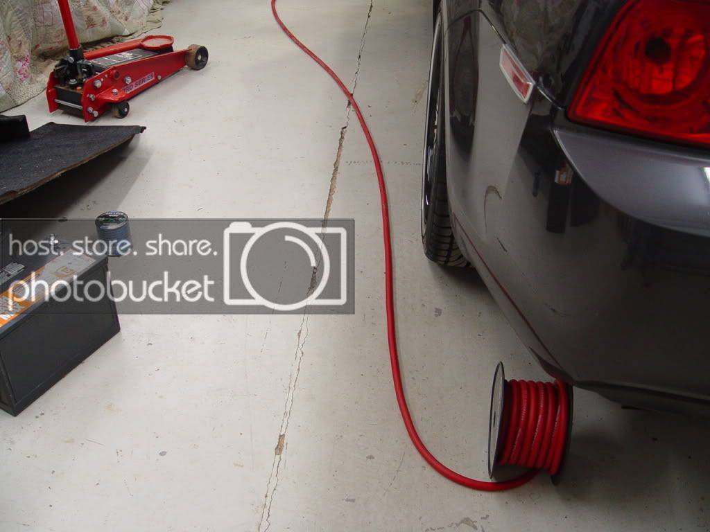

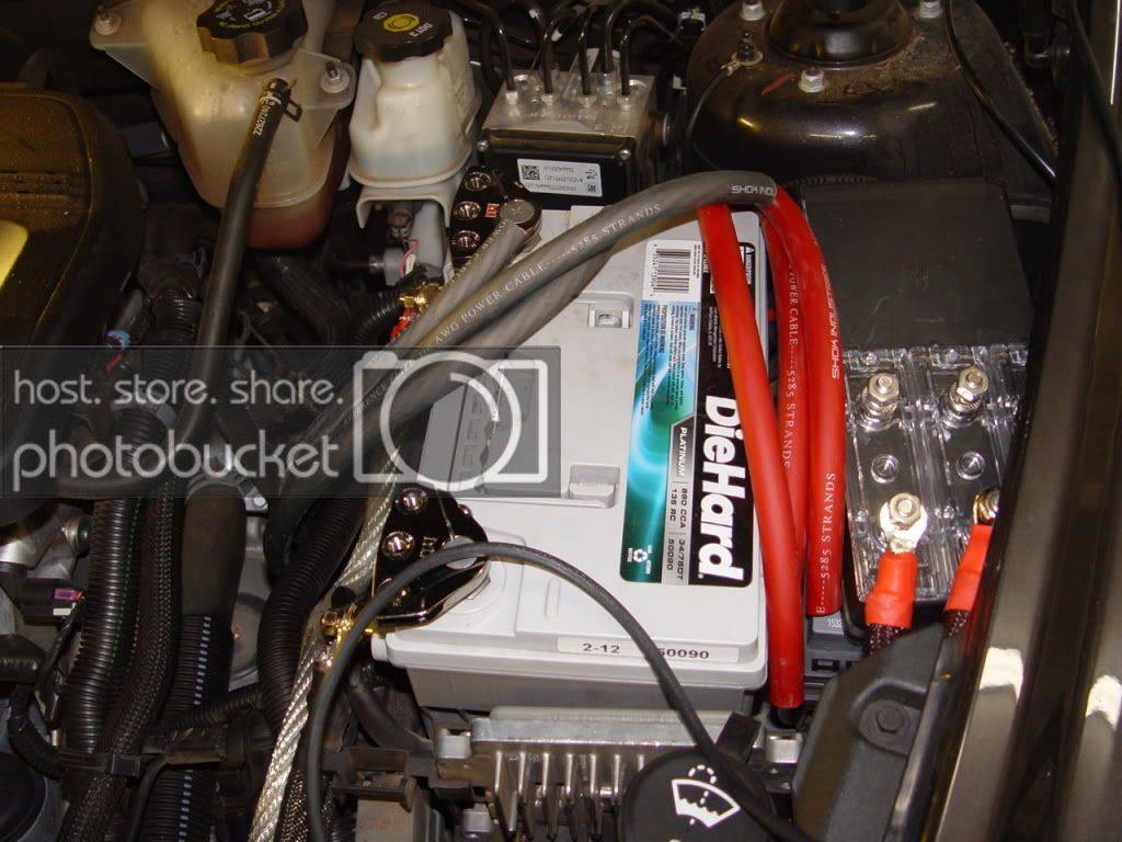

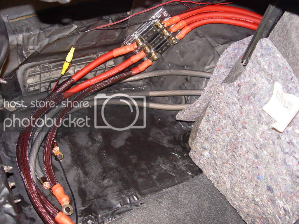

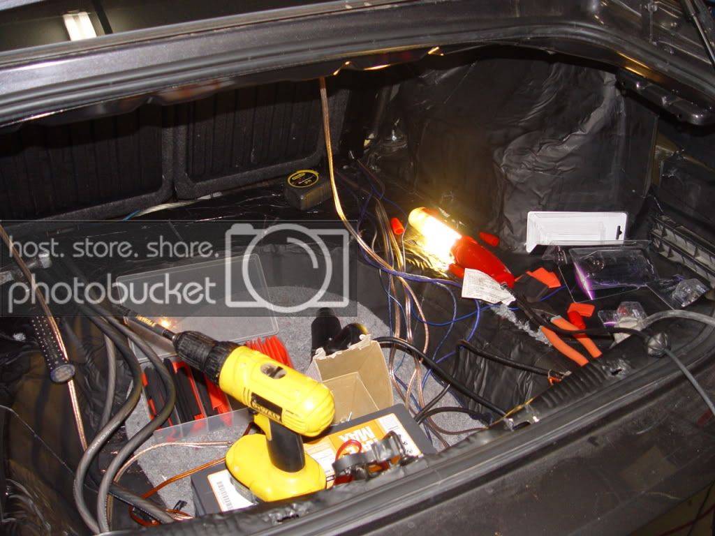

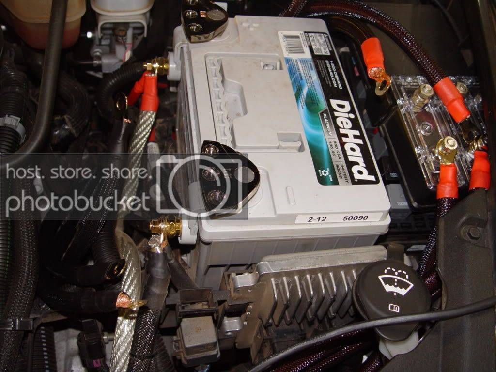

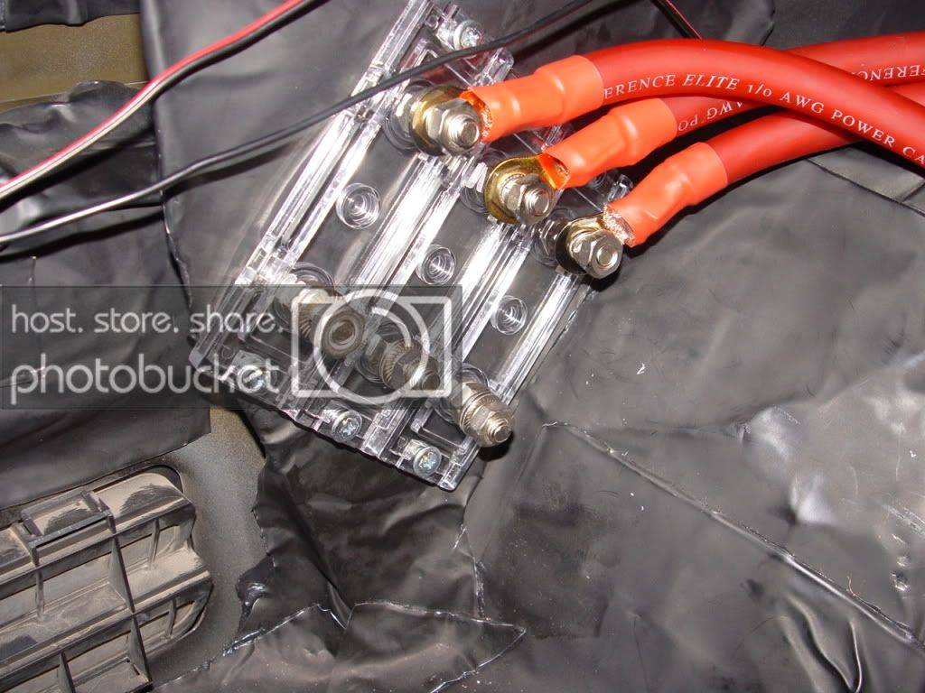

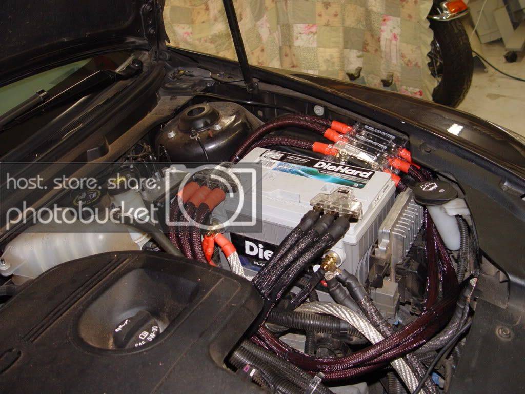

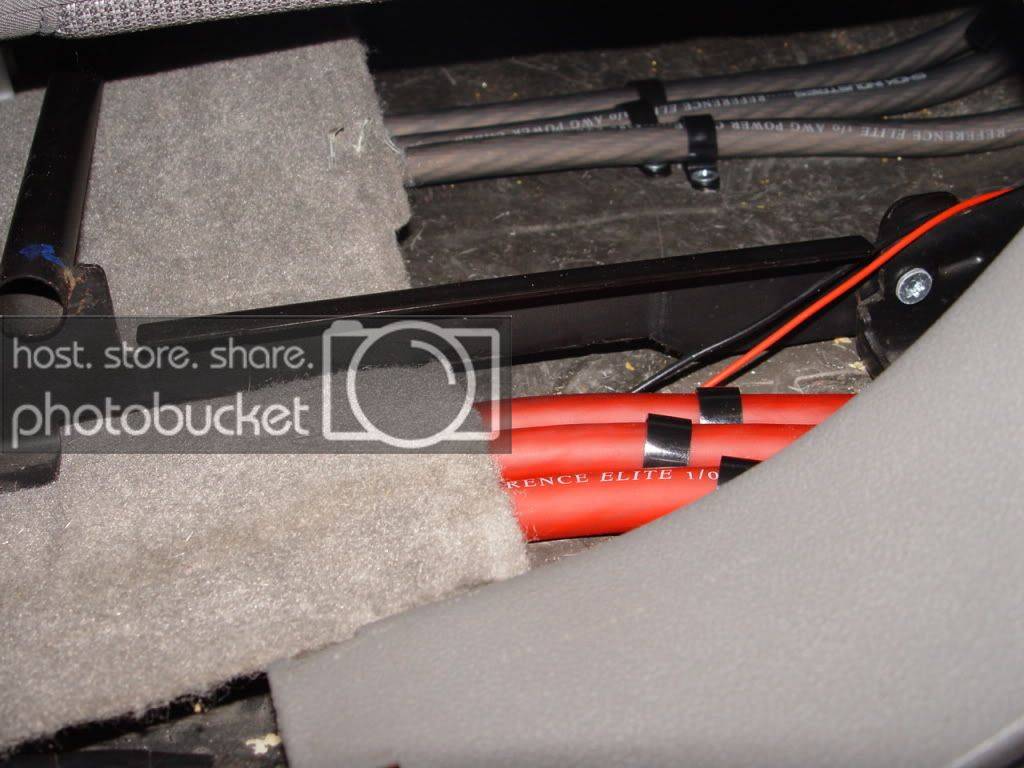

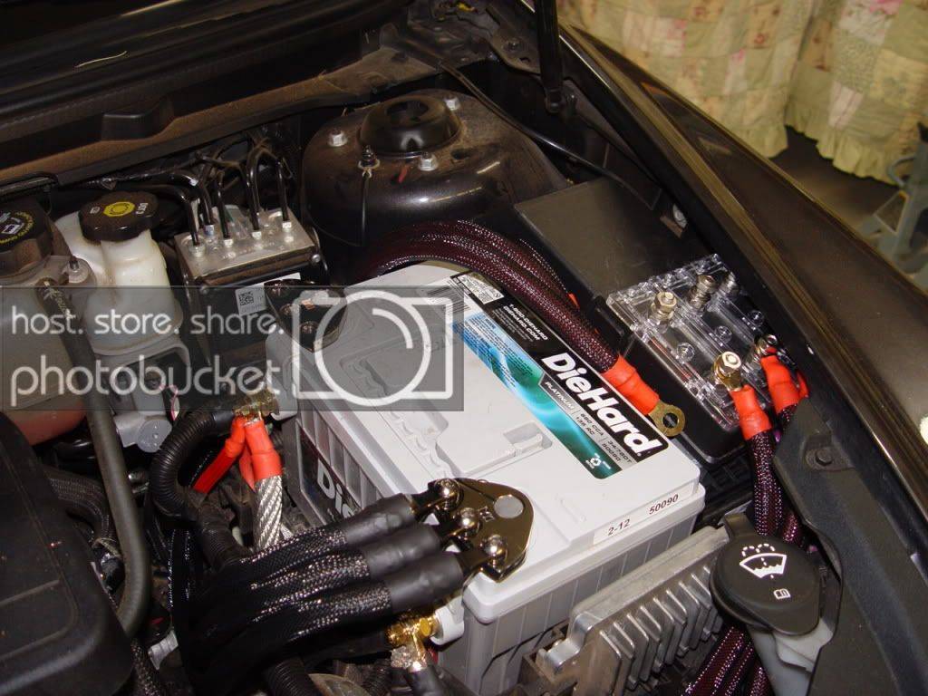

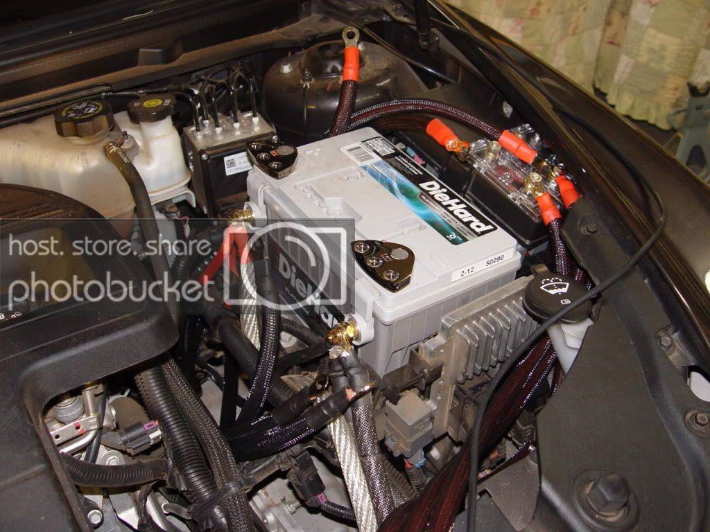

Just a little preview of what's going into a customers car:

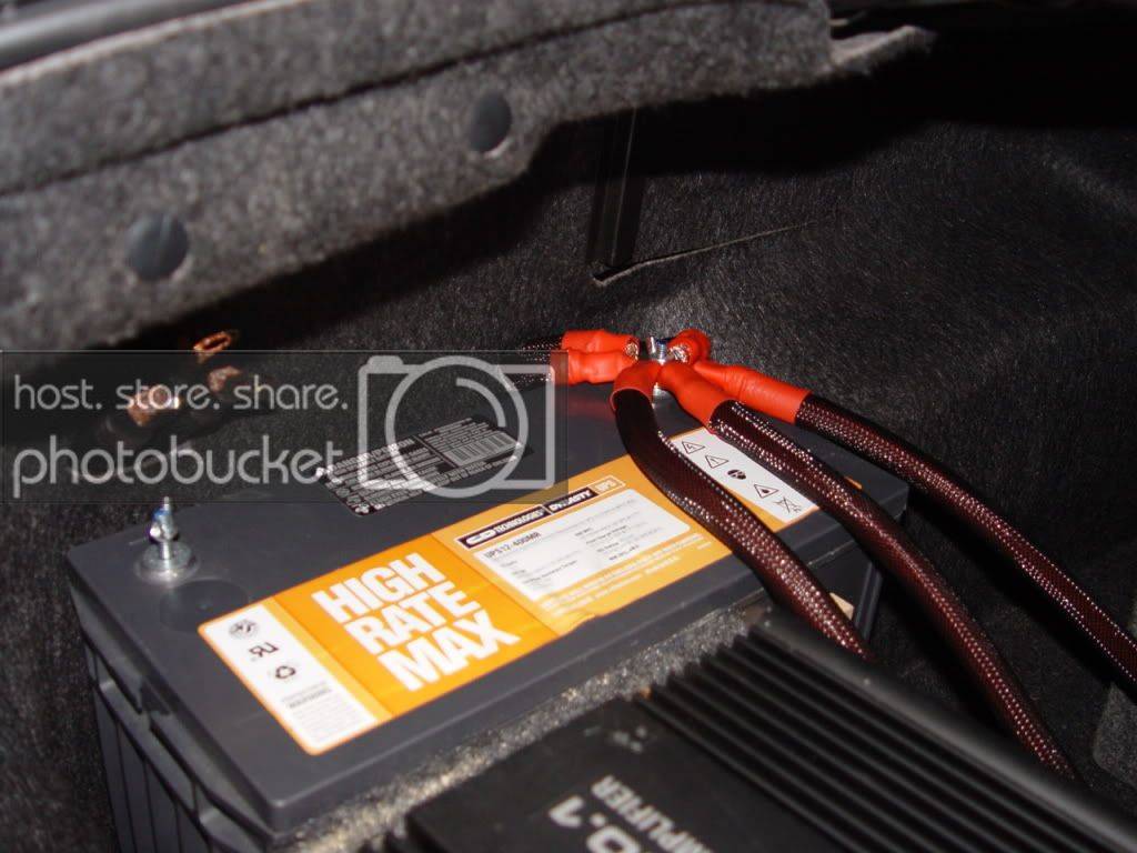

Haha, thanks man, it definitely adds some time but is well worth it to techflex and heat shrink everything. Right now the plan is 2 Shok 2.5k's and a Shok 100x4, we've got 2 75lb deep cycle batt's in the back too.
He actually was running a IA 20.1 at 2 ohms on that one battery and a big 3 upgrade and he was constantly at 14.5 volts resting and high 12's at full tilt, actually a nice battery, might consider one myself.
