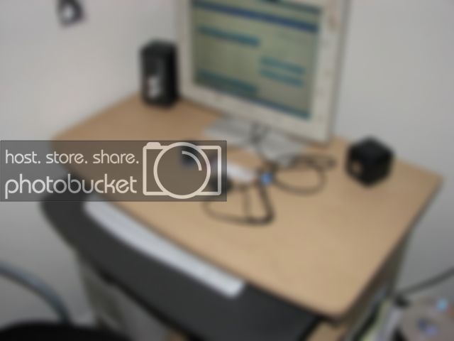

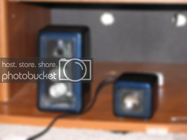

Finally done. The left box had to be reshot since when cutting down the drip in the clearcoat, it ran into the primer. The paint is a little off as it was a different paint that was tinted to match. The left wound up being slightly darker, but it's hard to tell and I like them a lot anyway. They sound really nice too for being such small drivers and the having done absolutely no math/research before building the enclosures.

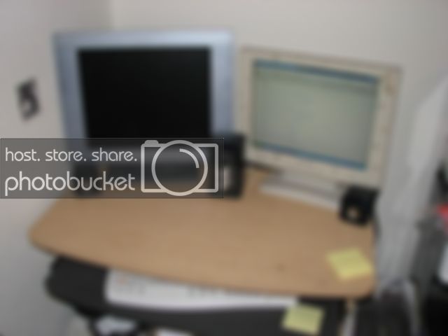

Here's how they sit now with my new (essentially) free 17" lcd monitor. A friend had it laying around broken so I took it and replaced the burnt out cathodes. Now I'm just waiting on a dualhead graphics card and power brick to run it.

As far as this set goes, they sound good a lower volumes, and with the bass on the amp all the way up, it provides good midbass without distortion. I'm sure a small sub would pick up the lower frequencies and blend well. Once the volume is turned up past 1/3 or 1/2 way, distortion is quite evident, and the bass needs to be turned down about halfway. They can get quite loud with the bass down and sound pretty good for their size. For normal listening volumes the combo is great, and certainly satisfies my needs. Once I can start playing around with the new drivers I can determine whether it's the drivers or the amp that's causing the distortion.
