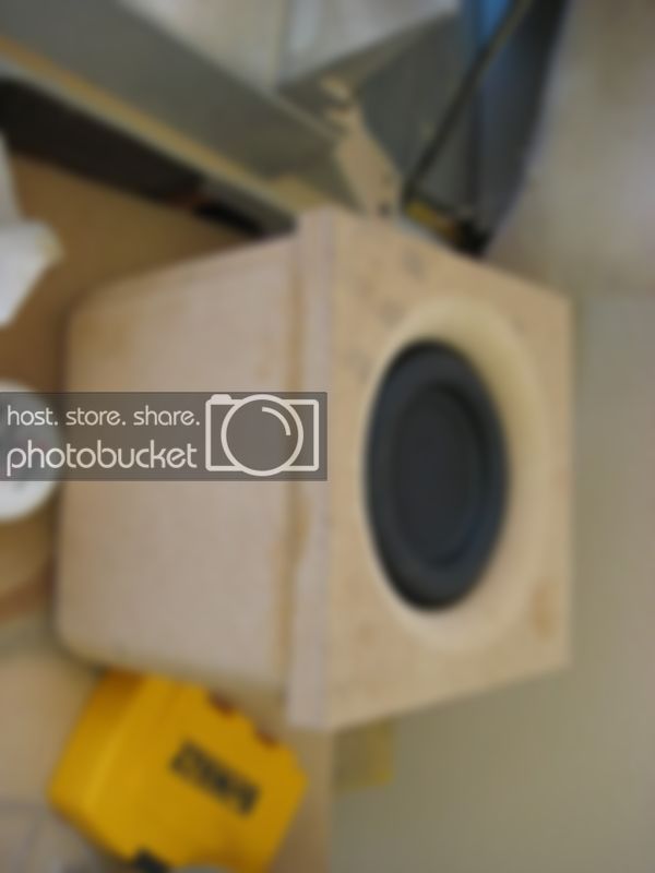

It's the 5.25. If it was for me, I'd be totally disappointed by its performance in its box, but it's for the gf, so she doesn't seem to care.
I did get to play around with it on about 600w, and the box seemed to keep the driver from destroying itself. Coil seems fine too, still nice and copper...y.
I think it'll do its job well though.
Oh shiz, forgot I bumped this thread.

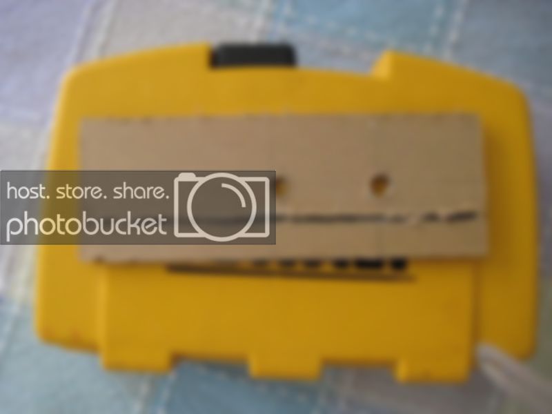

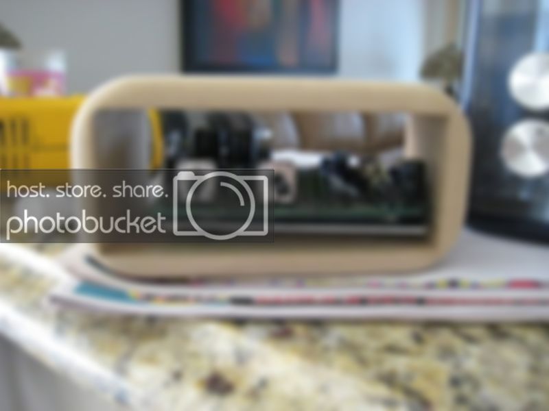

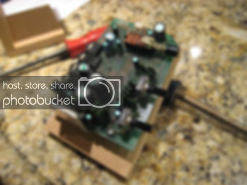

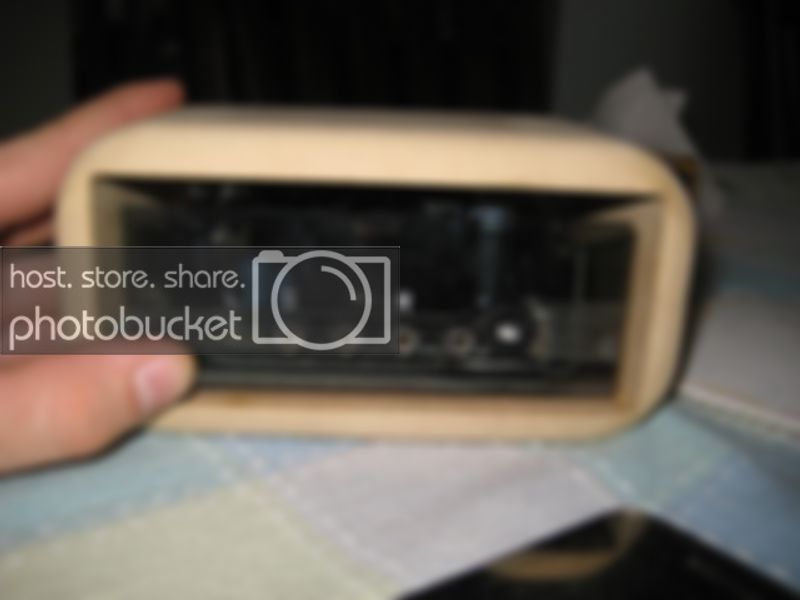

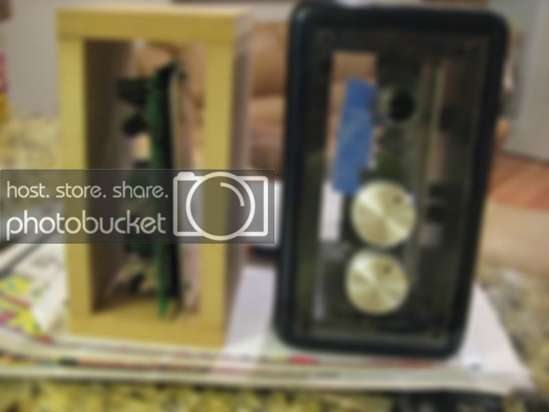

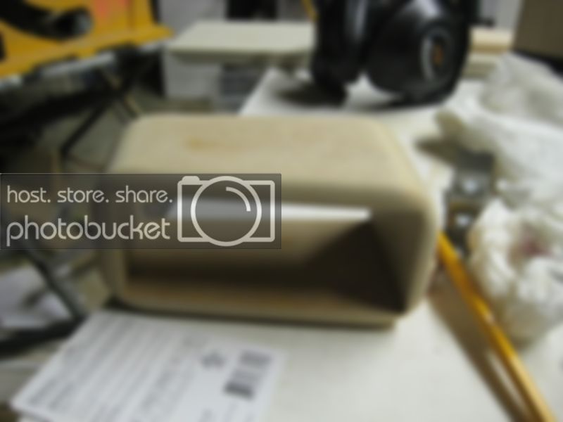

So while working on other projects, I decided to pick this one back up and finish it. I remade the amp box, with a bit of a twist this time. I used 1/2" mdf, with the same 1" roundover bit, giving it a pretty unique look. I don't have room to mount the plexiglass to the face of the box, so I'm going to have it float in the opening, attached to the circuit board and heatsink instead. I think I'm going to paint them a glossy super white.
And I think I've been shopping too much at Ikea lately and it's starting to show in my work....
Dryfit
Testfit
Compared to original

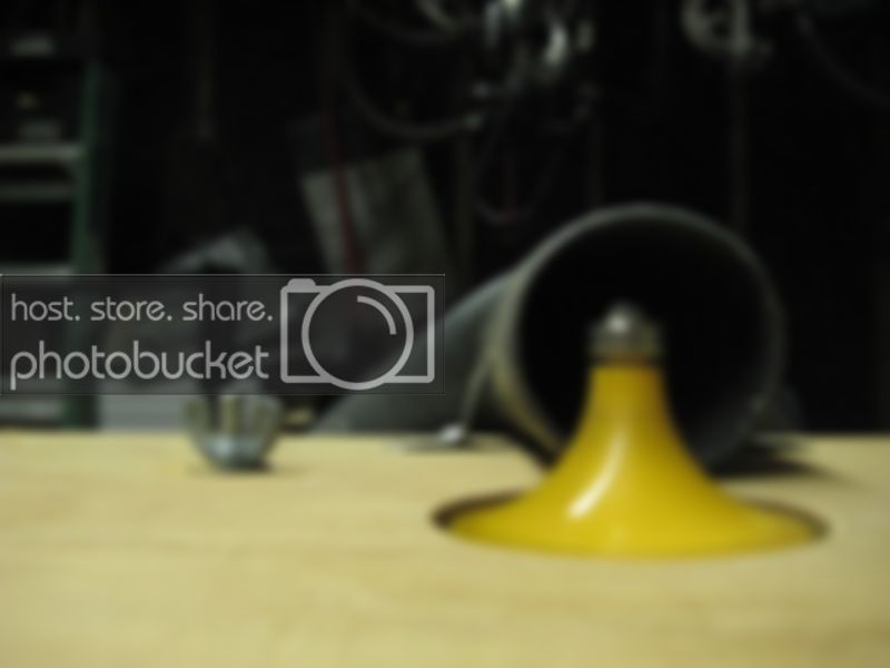

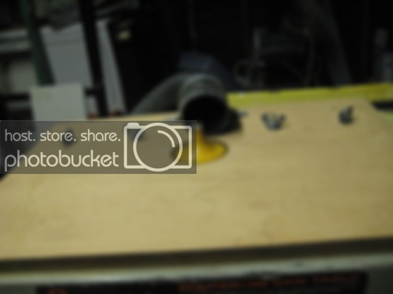

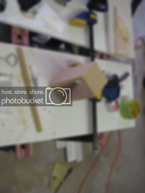

Handy table router + modifcations

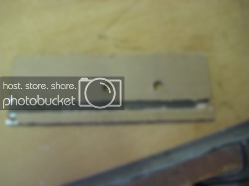

Routed & sanded

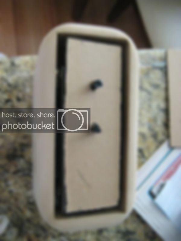

Groove routed for circuit board
Testfit
Wider groove

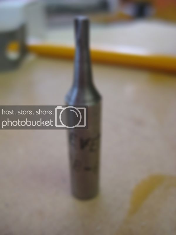

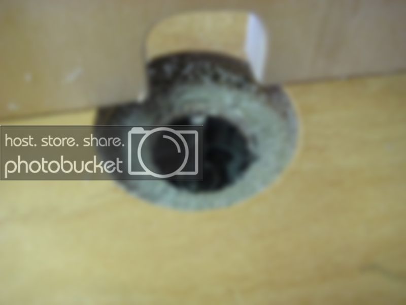

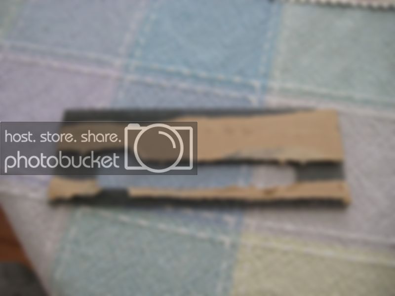

Broke my narrowest router bit while routing notches in the plexi

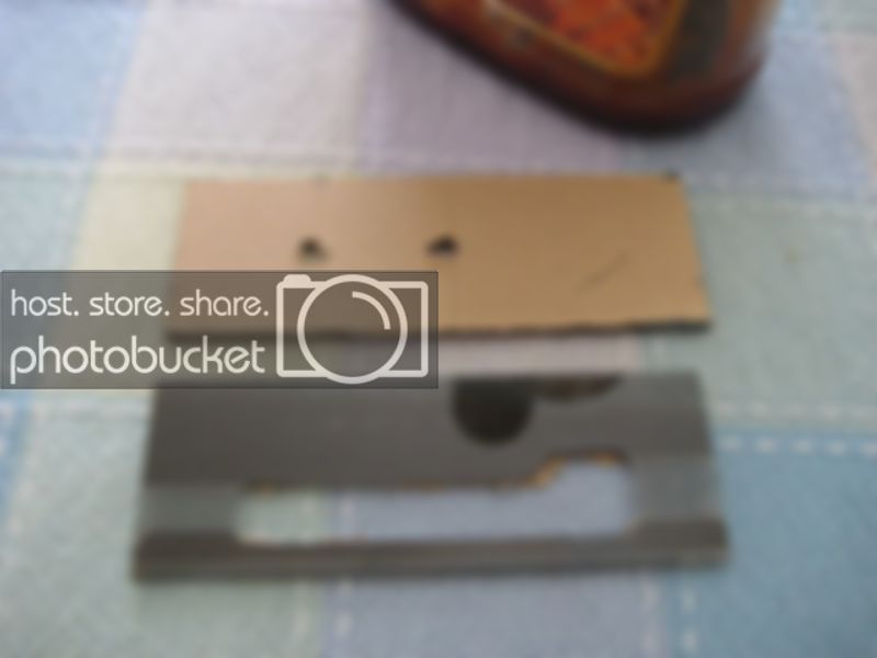

Going to have the front and back pleix "float"
Back marked out for routing
Front and back cut

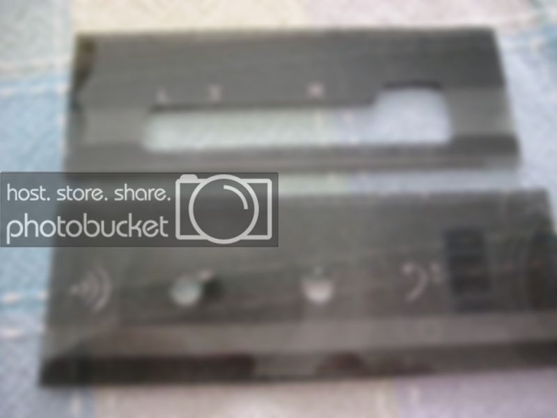

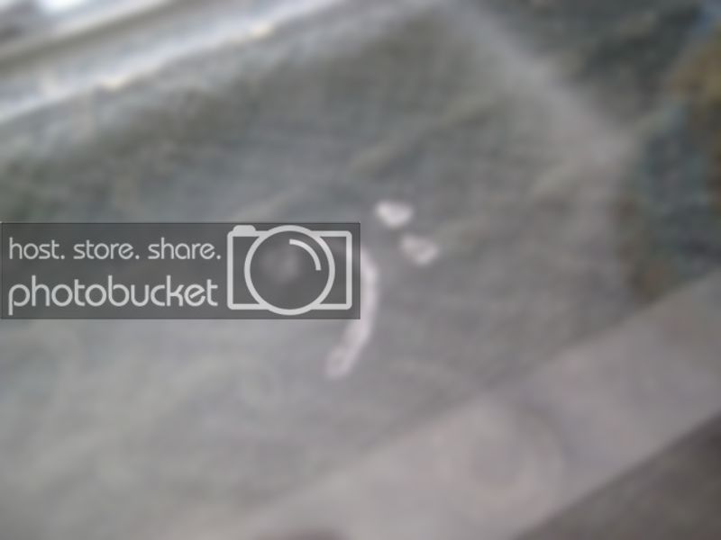

Etching marked out
Front and back etched
Bass clef

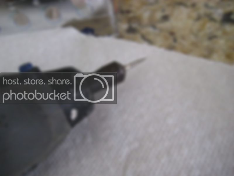

Diamond tip Dremel bit

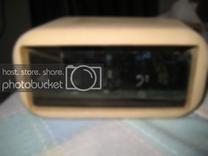

Front mockup
Back mockup
