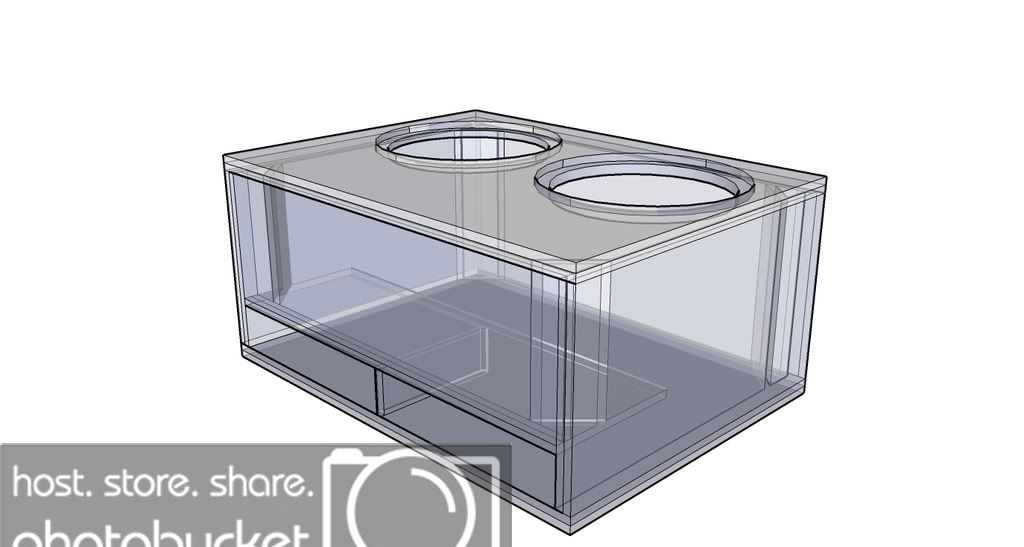

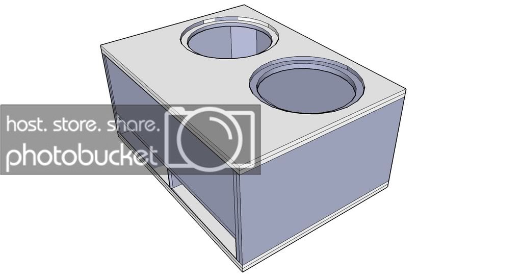

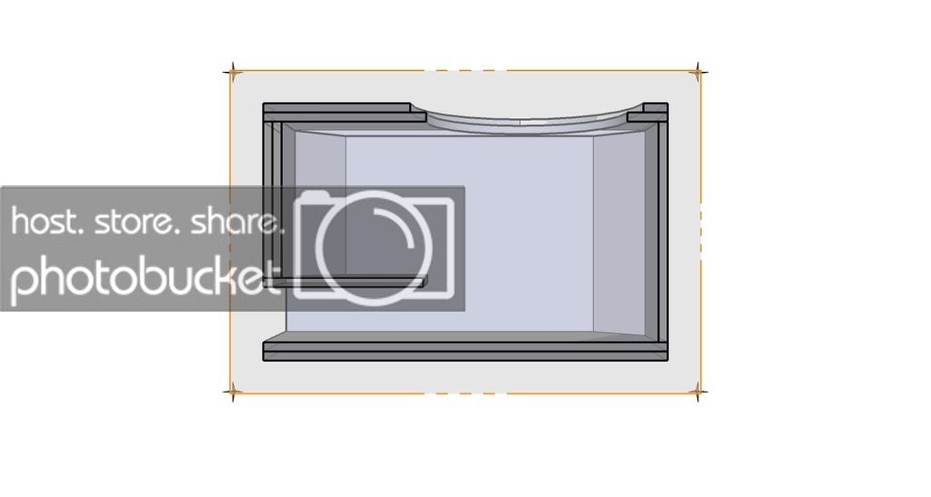

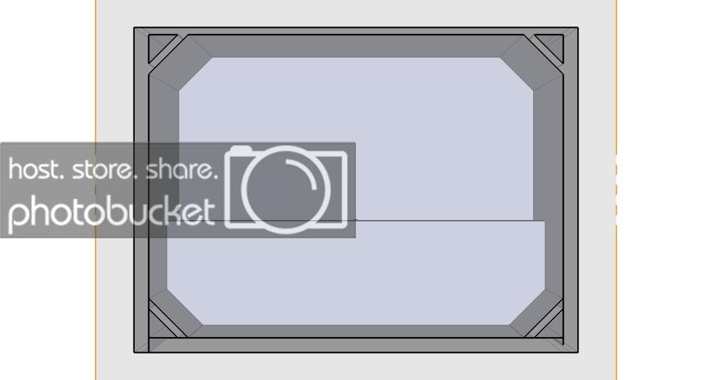

Who cares how he got the money that is not what is important. What is important is the box build. It starts tomorrow. I will be building mazzasec's box its going to be a beast. Here arew some pics of what the box will look like.
Box will be 13.125 cubic feet before port displacement and after displacement it will be 11.77 cubic feet. Port is 135 square inches tuned to 35Hz. All corners will be 45ed, and port edges will be rounded.

Looks nice Mike.....I know it'll be nice...You have some skillzzzz....
