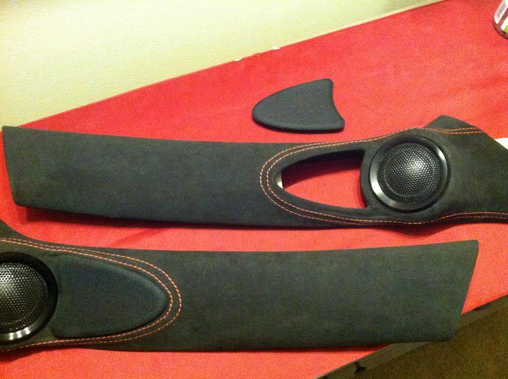

Here you go:

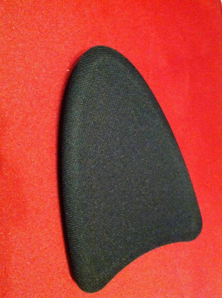

These a pillars house a Hybrid Audio Technologies Legatia L3PRO dome midrange with a machined aluminum housing. The matching L1PRO tweeters will be housed in the sail panels which are being completed currently. Pics will follow for them as well //content.invisioncic.com/y282845/emoticons/smile.gif.1ebc41e1811405b213edfc4622c41e27.gif

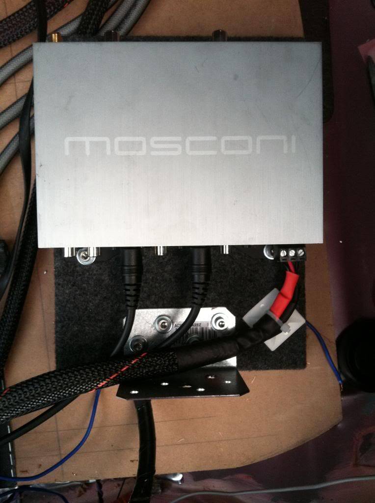

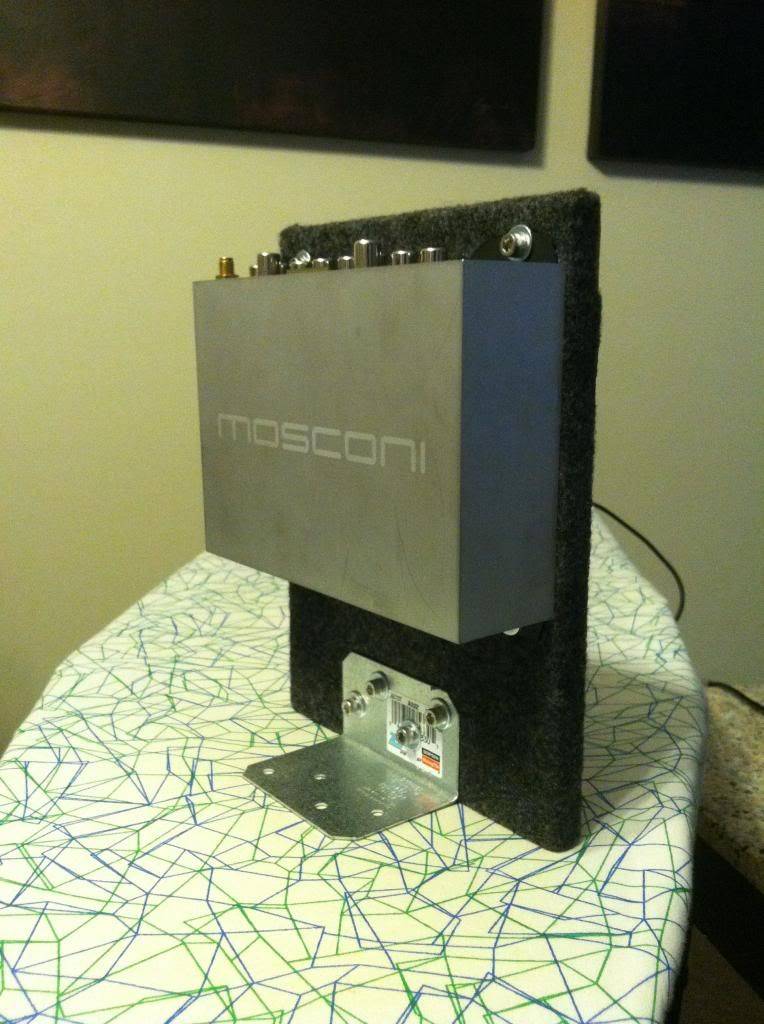

It's official. The P99RS is out and the new digital setup is on its way in. First up, I had to disassemble the trunk in order to reconfigure some wiring and to find a suitable home for the processor. The board was carpeted and pre-drilled for Hex cap bolts and lock nuts all around. To mount the panel to the trunk, I used (3) 1/4-20 bolts and lock nuts to secure it to the chassis.
I rand 2 new optical cables and a 6 conductor cable for the DSP remote controller.

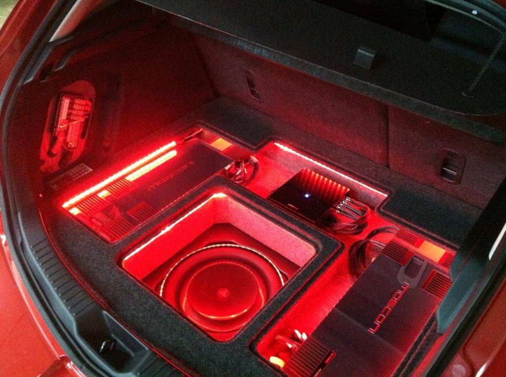

I realized I never posted the more recent updates. The Zed amps were removed and replaced with Mosconi AS series amplifiers. I also changed out the source unit to an Alpine D800 single din fold out which is their flagship model overseas (not available for sale in the states). I also added an Alpine H800 dsp and C800 RUX controller. The signal is now passed via optical digital from the D800 and volume can be controlled by the head unit as well as through the steering wheel controls via an Axxess interface unit.

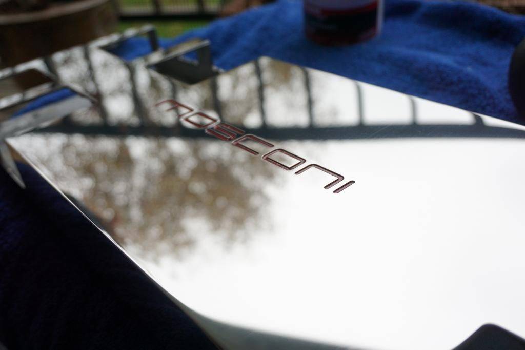

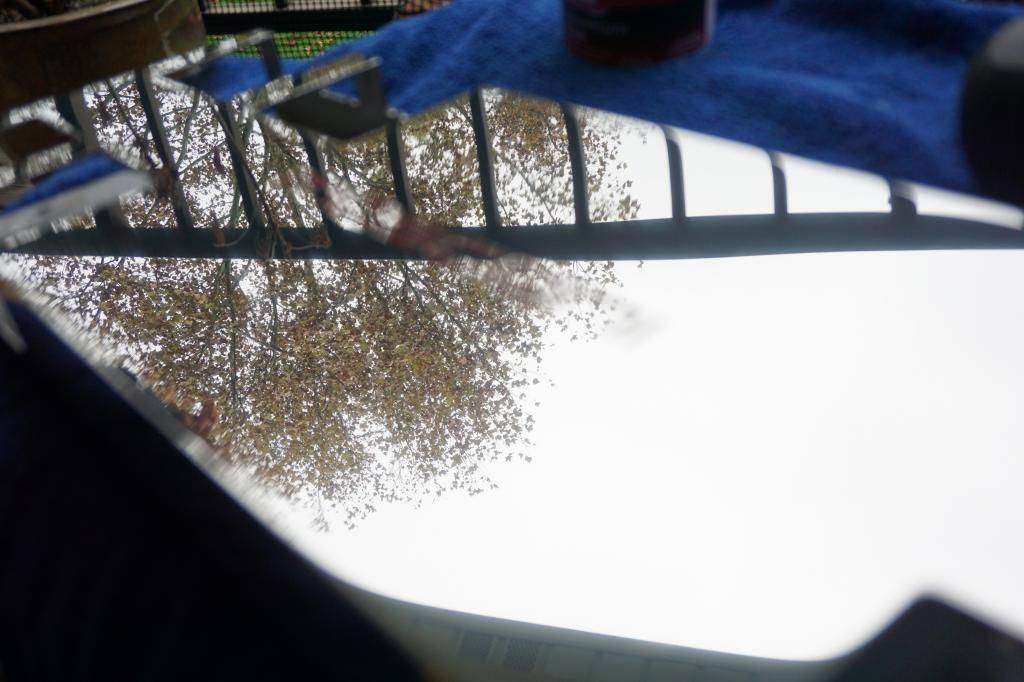

The Mosconi amps got a little cosmetic upgrade. I spent many, many hours hand wet-sanding and polishing them. To my knowledge, I'm the only one out there with polished Mosconi AS amps thus far. I like the look of them for sure.

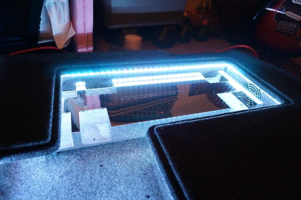

I also updated the LEDs to RGB so I can adjust the color output as needed.
