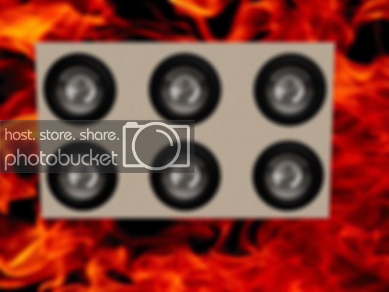

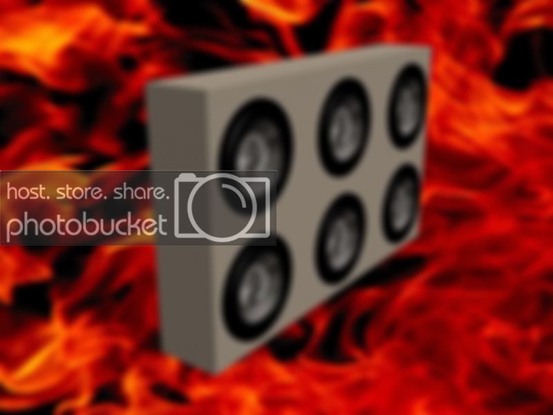

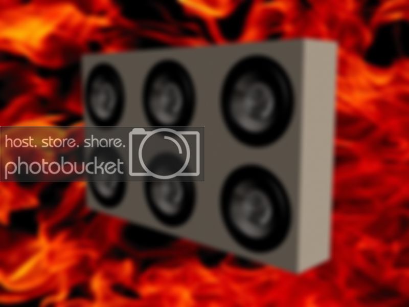

Lol.. well.. I miiight consider selling my two bnib Mach 5 SPL-12s. At the time I bought them, I was either going to do an enclosure like this
or a blow through.
However is it worth it to do a blowthrough for just two 12s? Although, My cousin had a full size GMC Sierra with a blowthrough for 1 10" Kappa.
So heres my "backup" plan, in case I don't do the 12s/blowthrough route.
Box diemensions
W:50in
H:30in
D:8in
3/4 mdf
Diamond Audio D1 12 (x6)
~6.98 cu.ft , leaves about 1.16 cubes per sub... Diamond Audio reccomends 1.2 per sub.
Diamond Audio D1
This is meant to go behind the seats in my regular cab Sonoma, and will come up past the window line a few inches.
