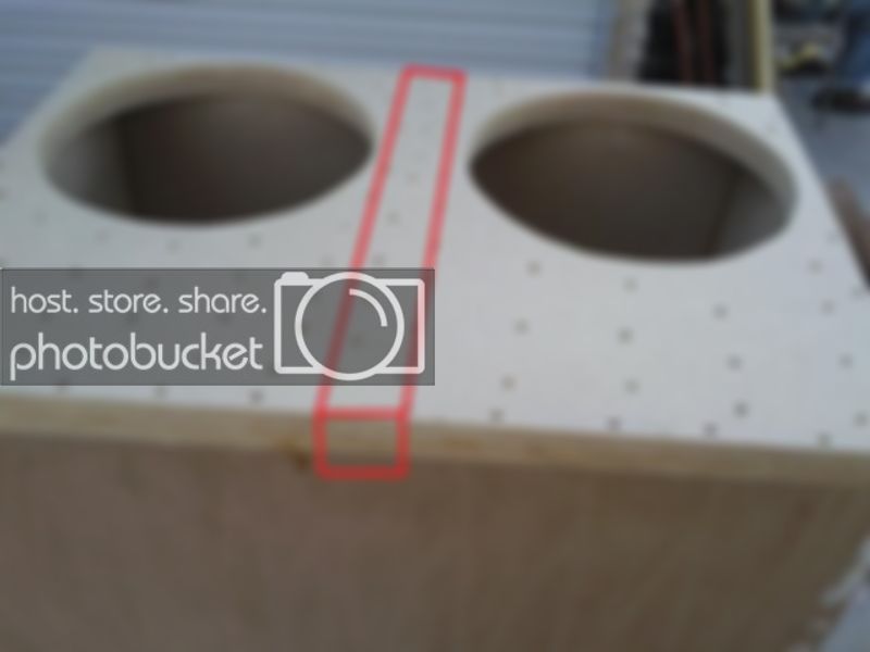

when doing your double baffle use WAY more glue and a lot less screws. Use a small paint roller or plastic scraper to spread the glue so the entire surface is covered. Then a screw every 4-6" will do the job.
Looks like you're getting closer....
nice progress dude. when you get this done i wanna be one of the first ones to get a demo! and u think it will be done this week end? do you need any help? if so let me know ill be there for sure.
also i agree with the not enough port area thing, but we will see how it pans out, maybe with the aero's you dont need much port area...
also ill bring my camera up and get vids of the beast!!!

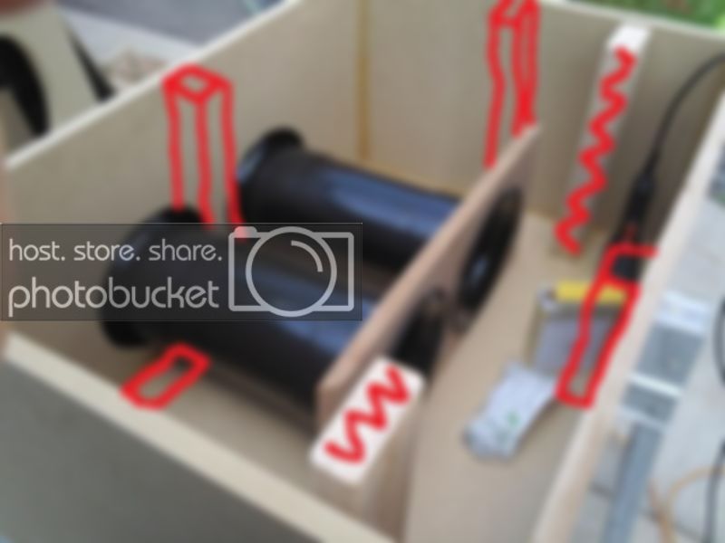

Why is there no bracing at all in that box?? Especially on that type of power youre throwing them, those 2X4's definetely arent doing shit all where you put them
Wiring need a little tlc or some trim panels.
