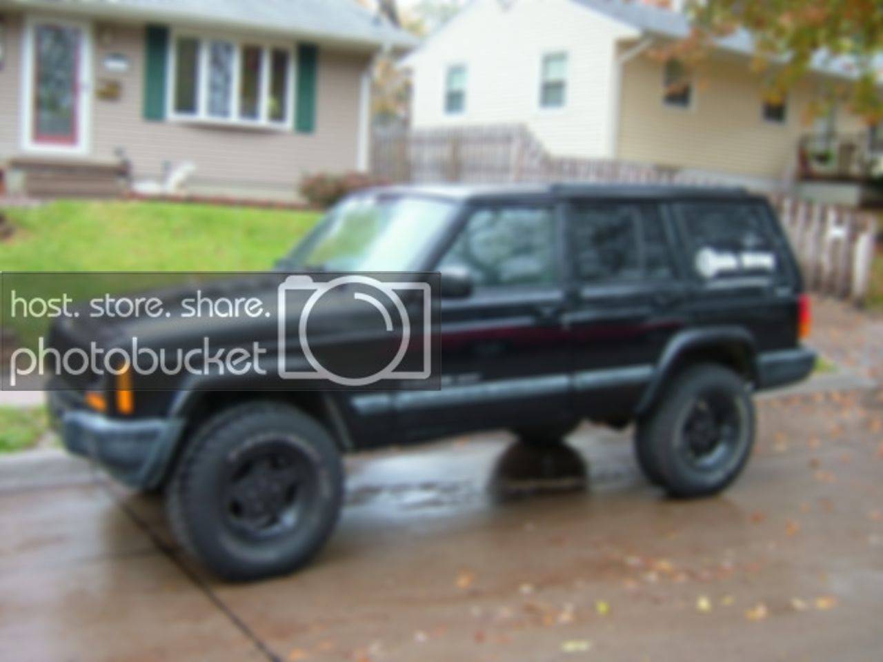

The Jeep it was originally going in....

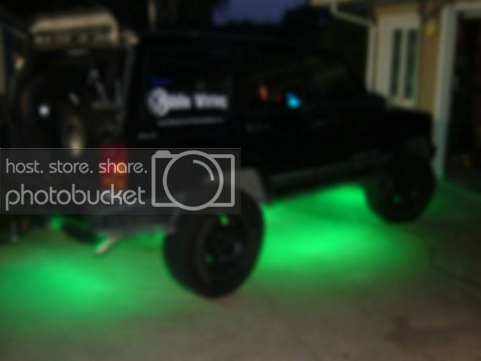

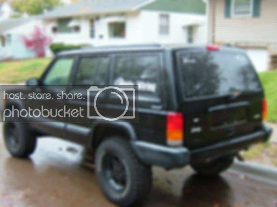

00 Cherokee. 3" lift with 31" Discoverer STs, Flowmaster exaust and K&N intake, varad ulx330 16.7 million color underglows.

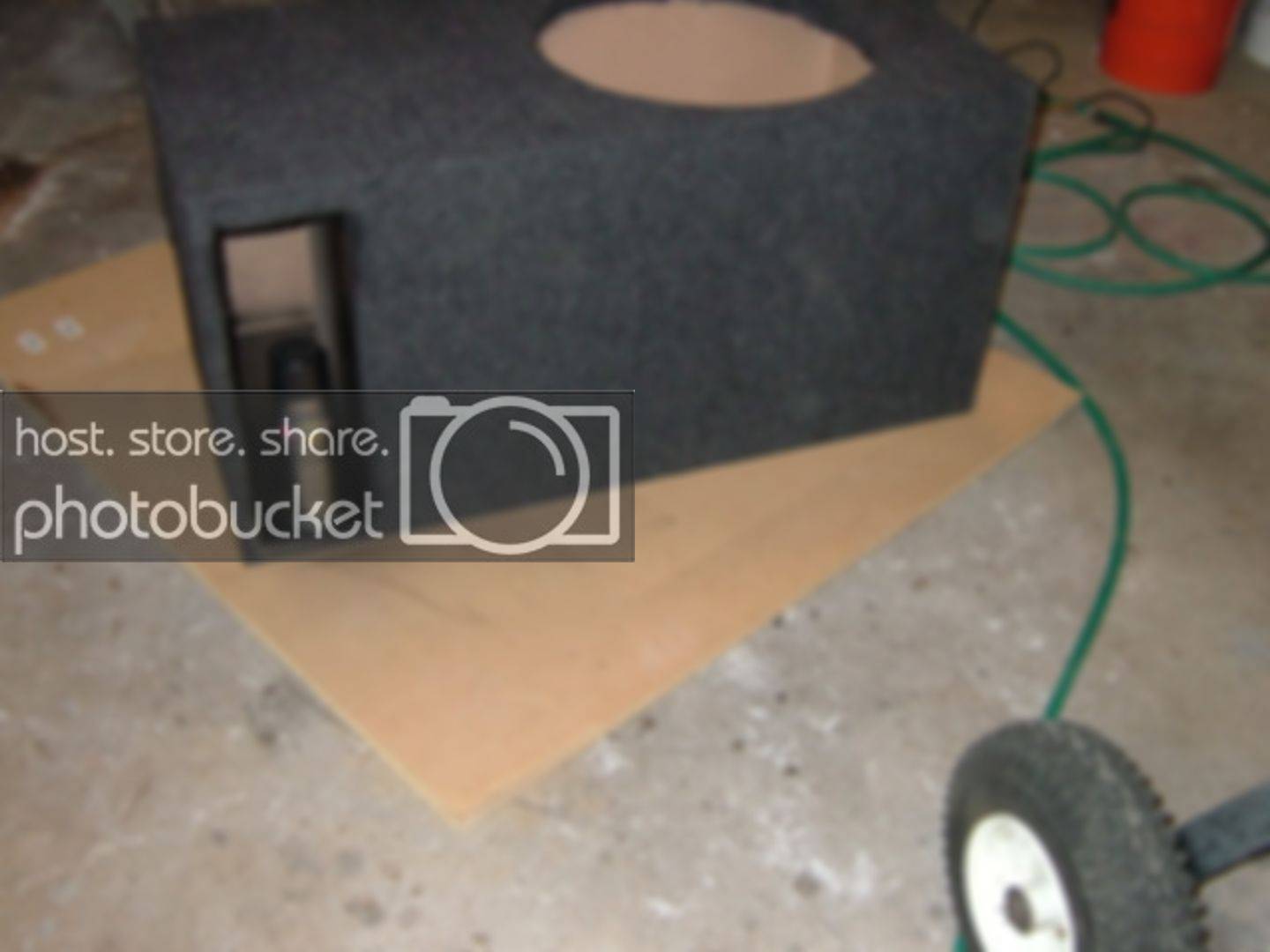

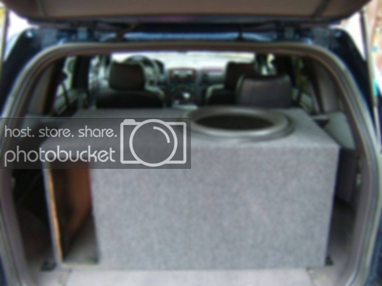

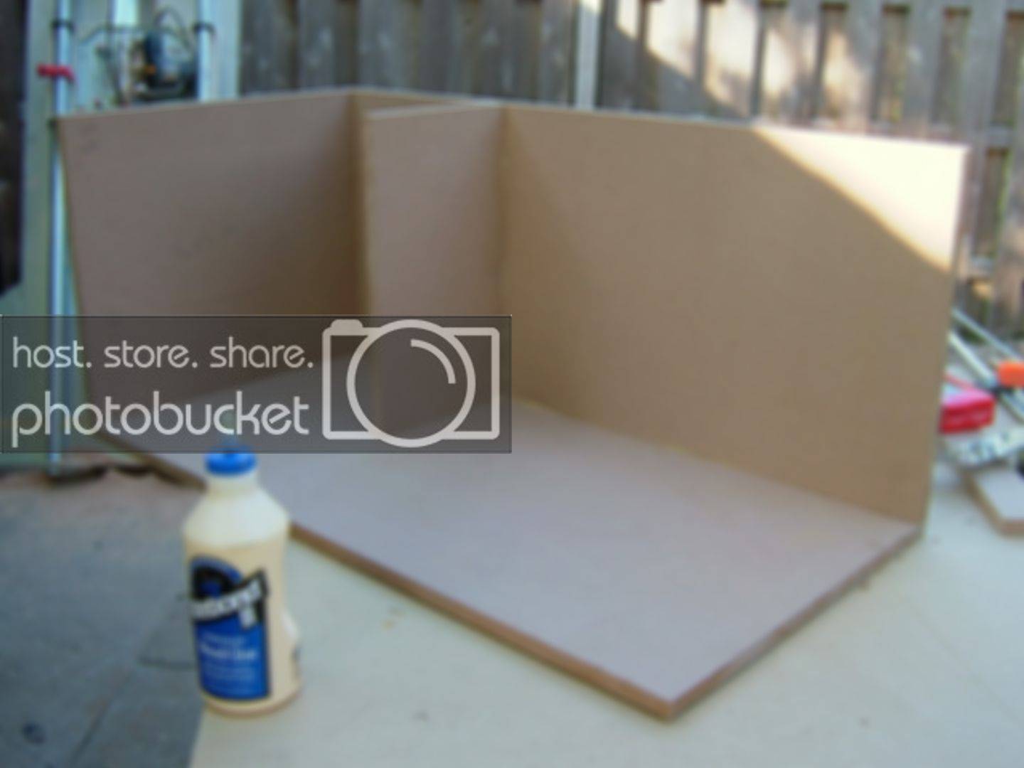

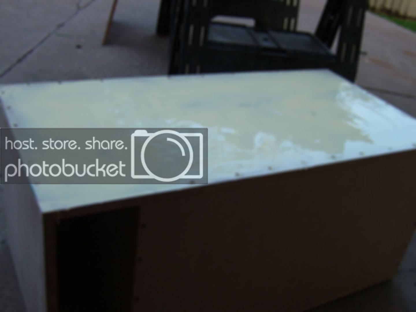

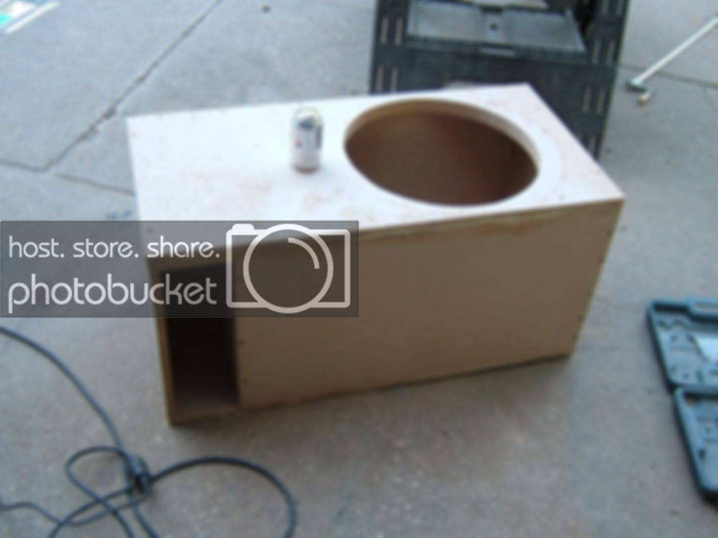

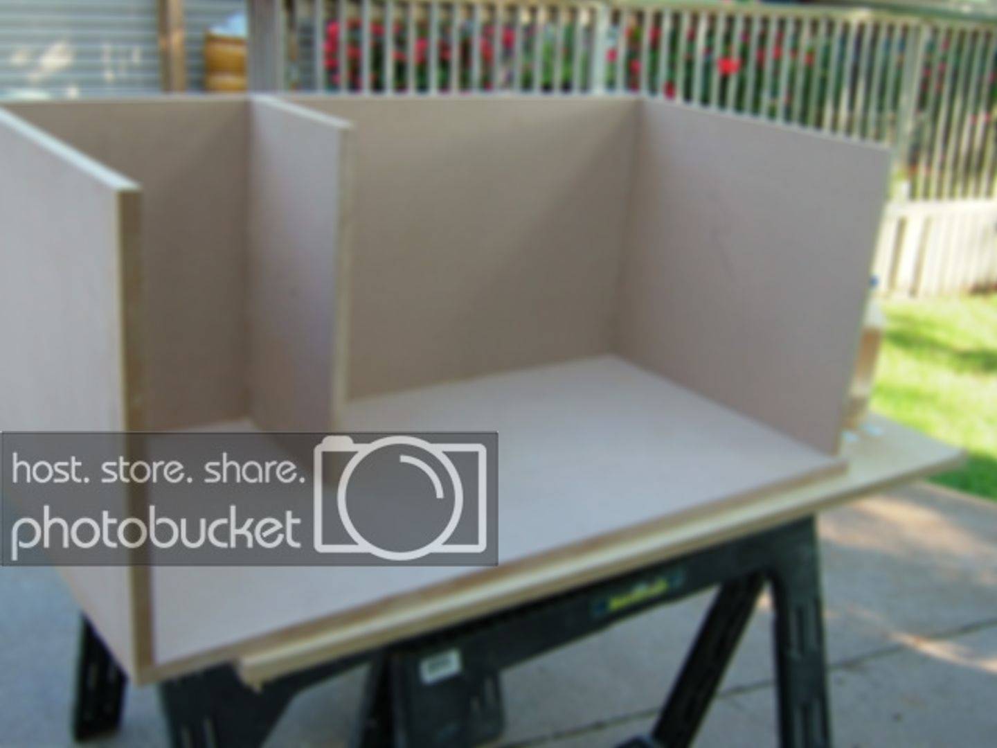

The Box is about 6cf tuned to 32 HZ with about 96 in^2 of port

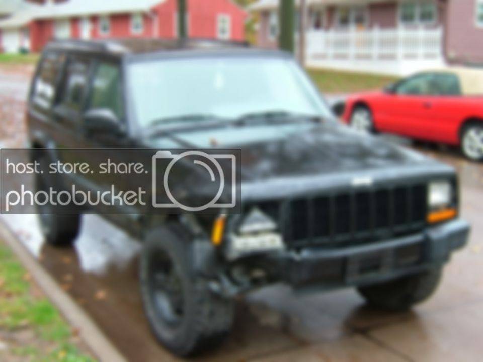

meanwhile, above mentioned accident happened. the jeep now looks like this (today is the last day i'll see it, im deff gonna miss the shit out of it. i dont even get to see it off cause ill be in class)

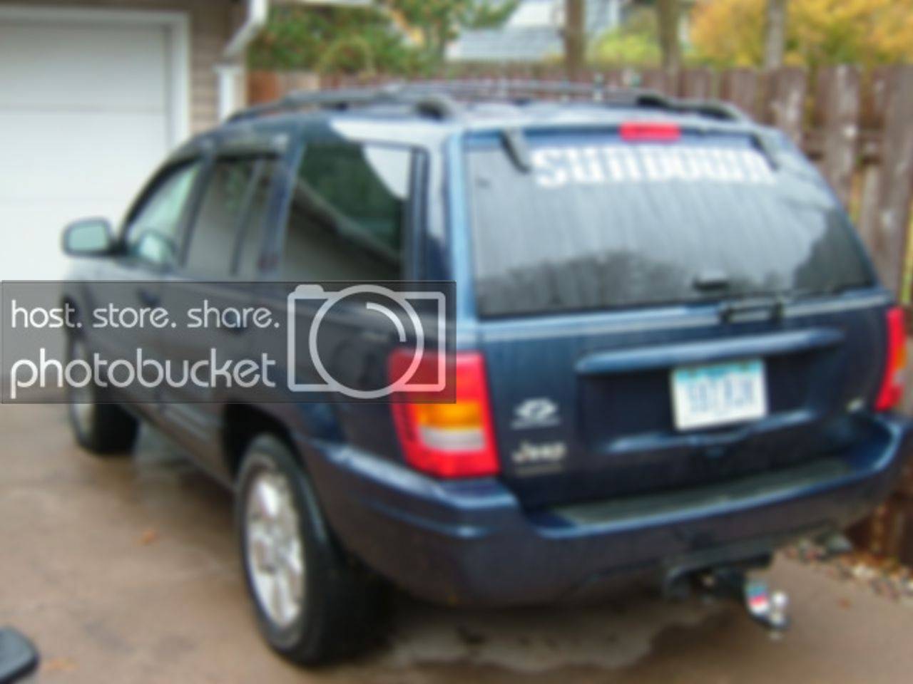

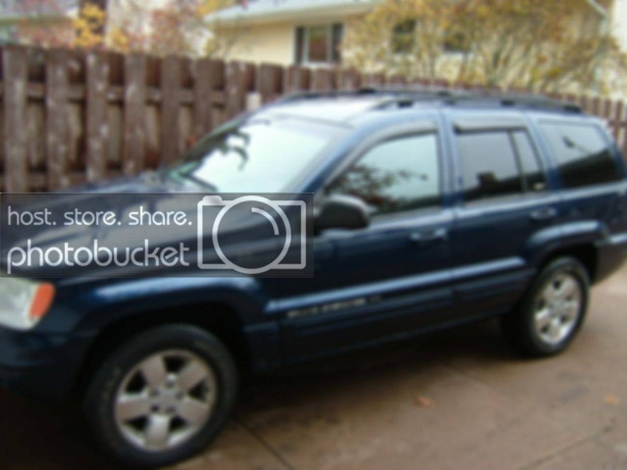

so i picked up a Grand Cherokee 01 with about 108k. needs new tires but those will come when i lift it 4 inches, ill put 33's on it.

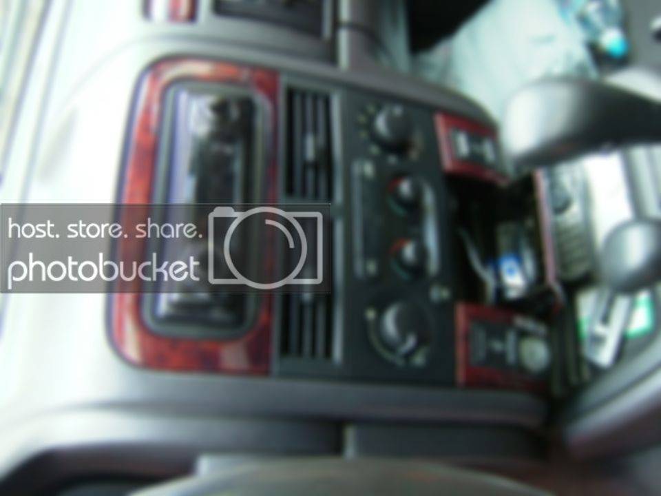

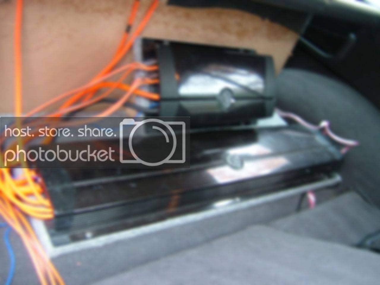

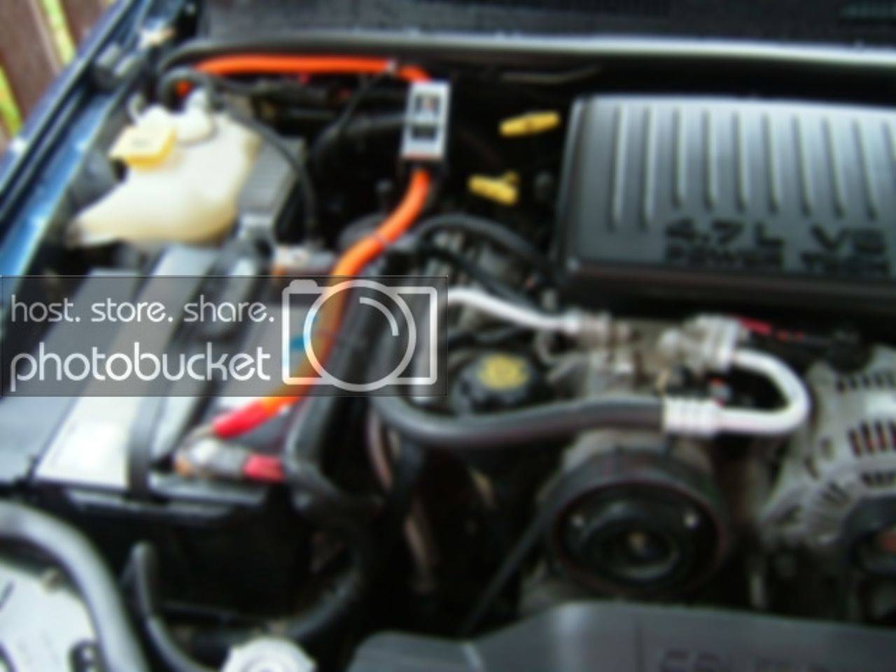

so then came the task of transfering my headunit (kenwood KDC-X993) underglows, speakers, and wire everything up.
how was that declared total loss? Did the chassis get bent or something? That doesn't look like an expensive fix, you should buy it from the insurance company and fix er up //content.invisioncic.com/y282845/emoticons/wink.gif.608e3ea05f1a9f98611af0861652f8fb.gif
Front axle was toast. Twisted frame. Lower control arms were pretty ****ed up. There's a lot of damage you can't see plus the ****** was on its way out and I didn't really want to **** with that.
I like the fluorescent orange wiring.
yeah, one of the few reasons i didnt go with hyperflex or knuflex
yeah the neons do look nice
thats surprising to hear, most people think they look ricey
so did thre insurance company come and tow it or did you call someone?
the insurance company sent out a flat bed from the auction company (qcsca i think it was)
glad to see you in another jeep, they are like a disease, much like car audio! what lift did ya have on your XJ!
it was a 3-3.5 inch. 3 inch coils up front with blocks in back, full OEM spring pack+2 helper springs (one to lift, one to account for the sag from the audio shit hahah)
