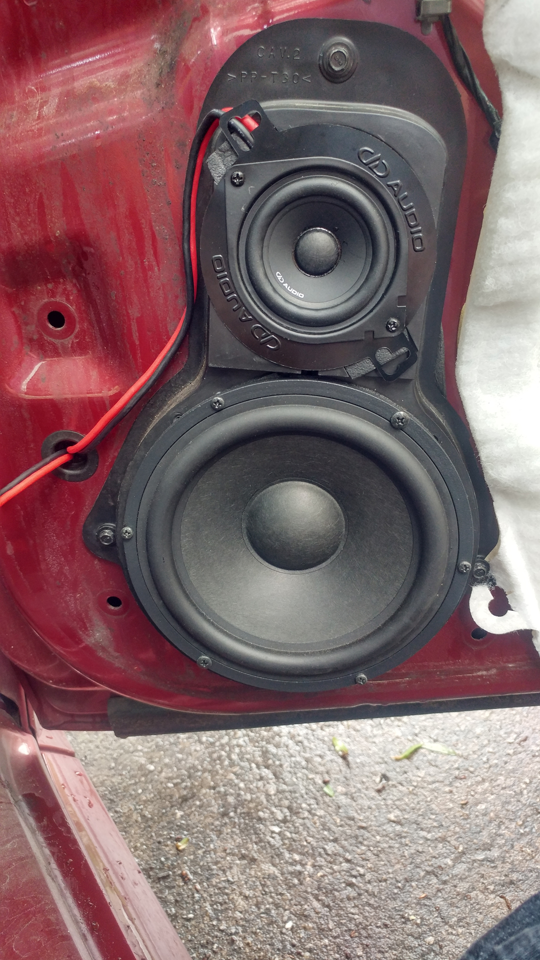

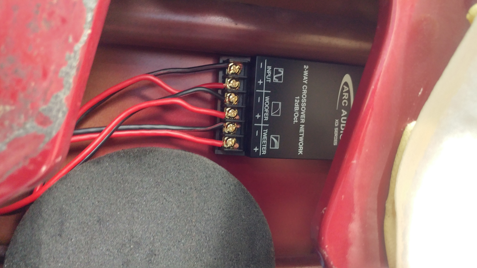

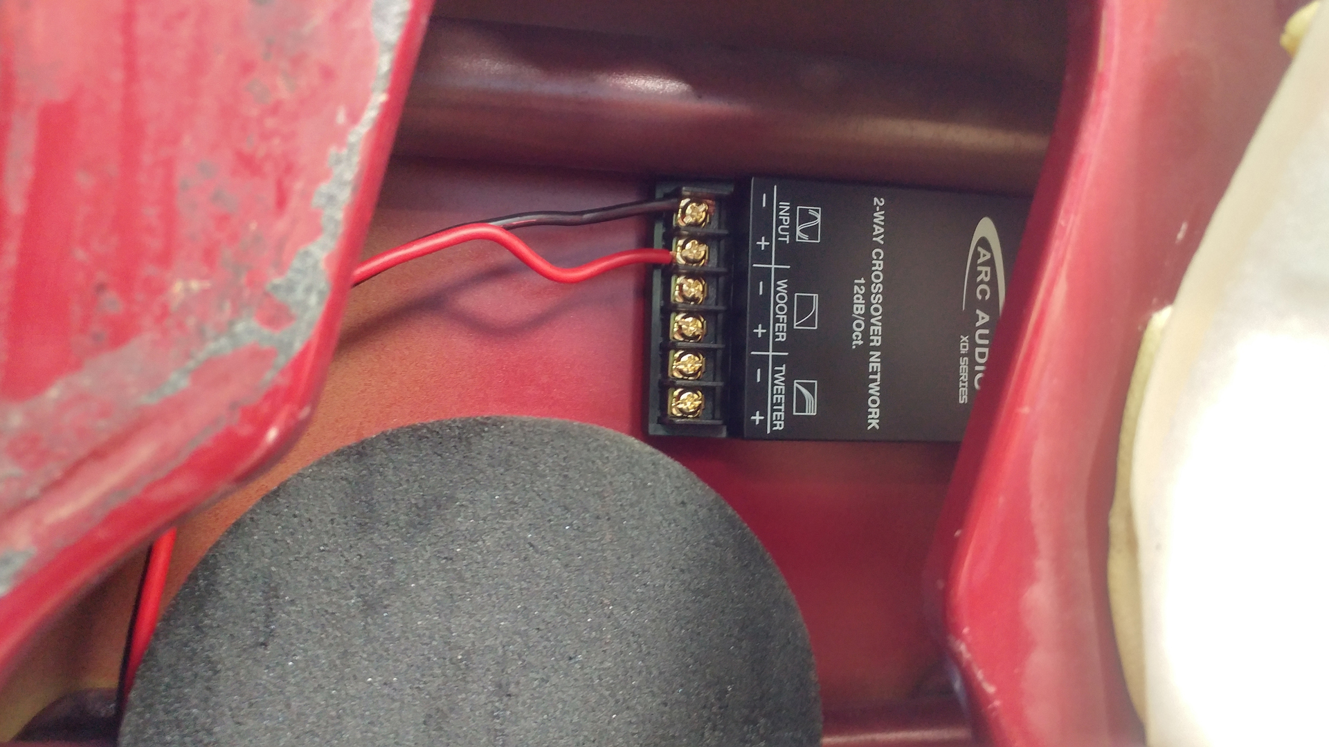

Got the second door done. Forgot the crossover pics from the left door so here they are for this one. They are mounted with 3M outdoor double sided mounting tape. The door was cleaned with 91% Alcohol. They are flush with that door brace and they are very secure. Breaking in the mids and tweets with full volume cause IDGAF. However, no distortion, no hiss... no nothing really. They just sound good.

I only got one door done. It got dark and the skeeters were biting. That tweeter is quiet as it should be with my current EQ settings. I did a side by side so to speak listening to each door. The one with the "Alpine tweeter" is still very bright. This tweeter is much more natural. Tomorrow I will do the passenger door the same way.

Mid is crossed over at 800hz into the Arc passive crossover and the Arc tweeter is set in the passive crossover at 0db.
