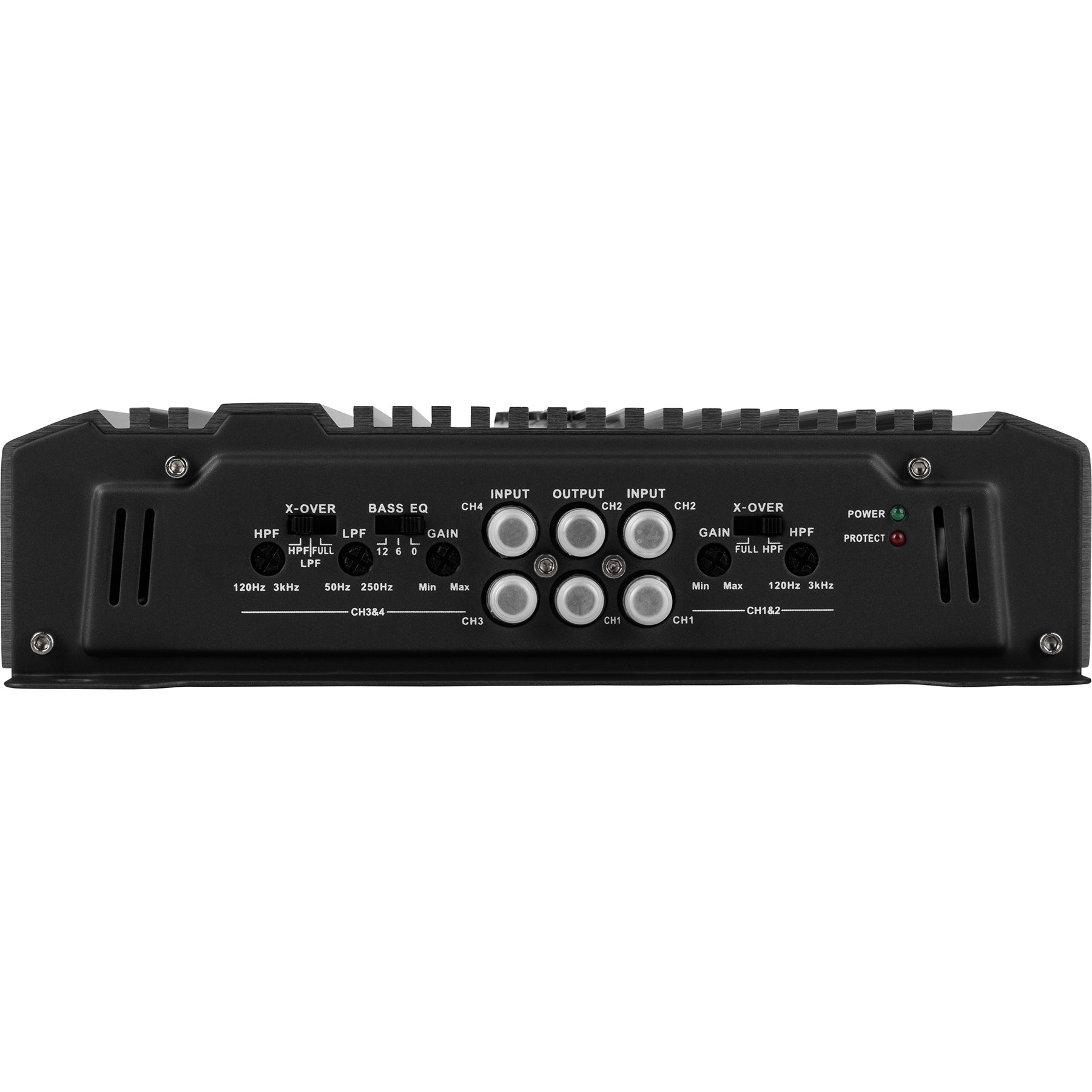

If it's not one thing it's another. I only have the 4 channel for mids and highs so when I was running the DD's and tweets at one time, I had to run passive crossovers on them. Right now I am full on 2-way active plus the sub. No passive crossovers. I think the gain may be to high on my front channels of the Barbara Ann... but dig this, when I measure or have measured at the terminals of the front channels... the voltage is not the same as the rear channels. Say the rears would say 20v on a signwave, the fronts would be like .93v or some weird **** so I kinda did them by ear. The owners manual is a joke so...
Here is the crossover section of the Barbara Ann... pretty straight forward so I am pretty sure I didn't muck that up. Full on everything as the DSP is crossing over the sound.
Full pass 1-2
Full pass 3-4
Bass EQ on 0
Gains are barely up
Full pass 1-2
Full pass 3-4
Bass EQ on 0
Gains are barely up
