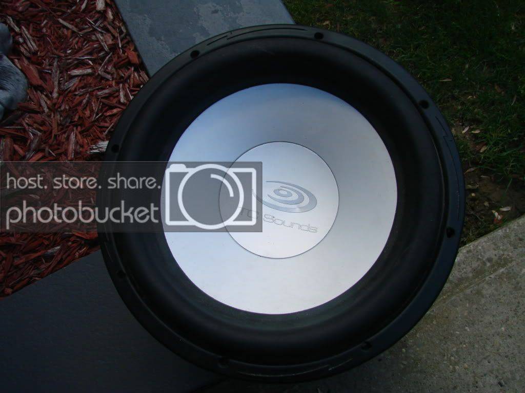

I have this tc3hp custom d2 I would be willing to get rid of. I'm running 2300 rms to it right now in a small ported box and it barely gets warm even after 10 minutes of tones at full volume. If you only have have 1400 on tap I would go around 3 cubes ported tuned around 30-32 and it would blow away those g5's. It will be a decent chunk of change under your budget also.
