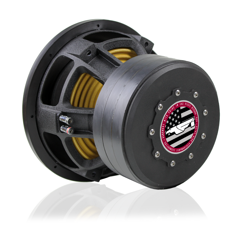

Here's what I need help with; I have $1,500 to spend on a car audio setup and I want to get the best bang for my buck. I want to be HEARD.
Could you guys recommend any sub + amp combinations? Size doesn't matter but My trunk can fit 2 12's, MAYBE 2 15's
Plan the spend on your electrical upgrades first the ask for recommendations Once you know your remaining funds left. Sa’s are a solid choice but Unless you’re specifically looking for a korean amp it would be unwise to spend over $500 bucks on an amp, specifically when you’re at pre electrical upgrade phase
It comes with wiring and a 1 year warranty. All he needs is an extra battery, neg and pos fuse blocks. He should only need a H.O. alternator if he wants to add a higher rated amp
I just spent $700 on a sa v2 15 a rp2000.1 and two crescendo 6.5s. My mids amp is a rockville db 45 which I bought for $80 (it’s ok for the price) and peerless by tymphany 6.5s I’m rear deck of 300. Still need a box for my sub.
It appears That rp Does rates based on all the dyno tests but will probably be less efficient than full bridge technology. Should still be sufficient for that sub. will still need big 3 wiring upgrade and agm battery. Should find someone to build you a custom ported enclosure
Yes they do rated and I’m currently waiting to get wire from my job for the big 3. It just sucks cuz the 300 has the battery in the rear. I’m gonna just build one to specs And eventually get a agm
that’s not too bad, you’ll run the alt power wire to battery then a long power wire to the rear sub amp so now you’ll just run a long wire from the alt to the battery in the back, then a short power wire from the battery to the amp. You can do battery negative to frame i. The rear most likely as well. Just use grommets
your battery isn’t going to last long if you try to run your system with the Vehicle off. Cool thing is running a dual battery Setup will be less wire since your primary battery is in the rear. That alt to positive run will be the longest run
