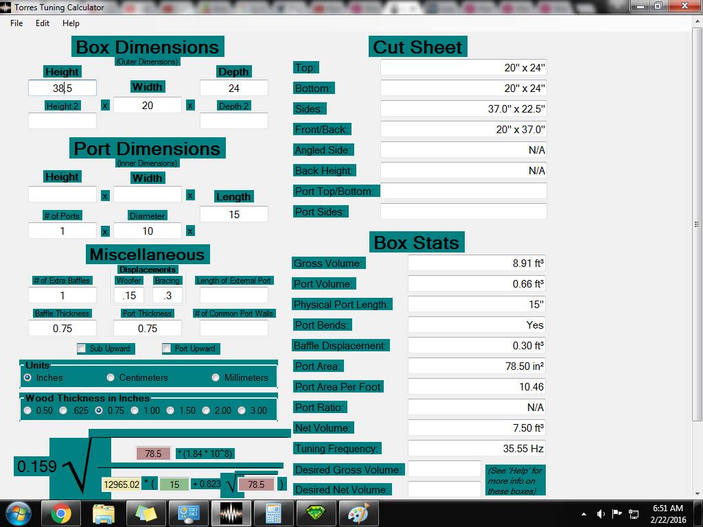

Whats soo hard about building a square box and cutting up a round tube and gluing it in?
Sample design right there with the cutout sheet there too. Just go crazy with the bracing however you want to do it to make the interior stronger.
Or this and use wooden dowel rods for bracing.
Is there a drawing out there that I can use ?
Just cut this to length and glue it to a wooden piece that you can screw onto the box and you can make interchangeable ports with varying lengths to get the sound and tuning you want. If you can build a slot port, a round port is like changing a lightbulb in comparison.
