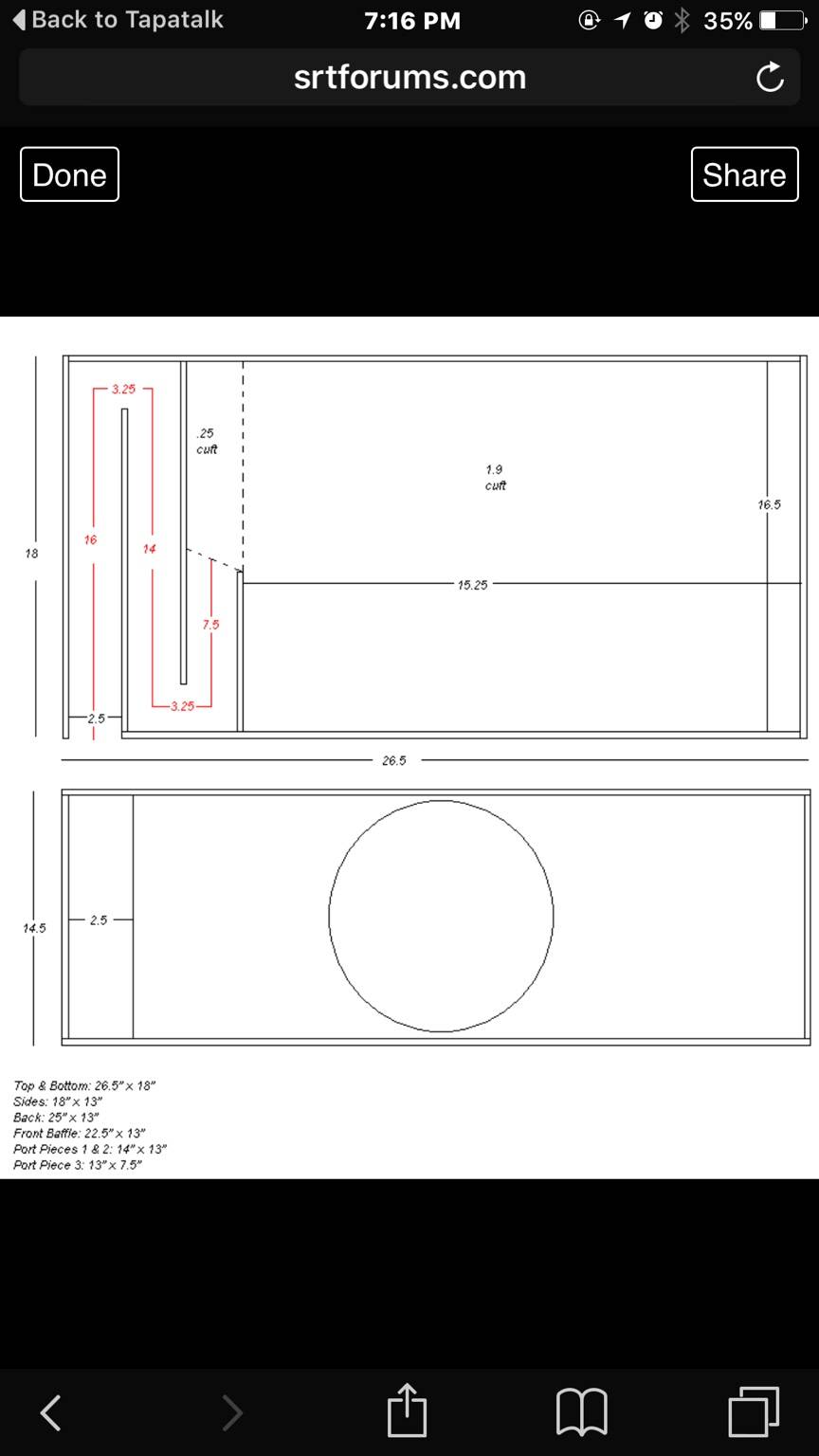

I dont think that sub is T line friendly. Its a 45hz and under sub, big ported box tuned to 30hz. Use torres box calculator to design your box.
I was going to use the link you posted above and go with 2 cubes at 30hz - birch wood , what glue do you recommend?
This is 2cu @ 30hz
So this will be my build - tomorrow I cut the birch wood. I don't see a double baffle on this drawing , how important is one? Also, will this be a good design? Does someone have something better ?

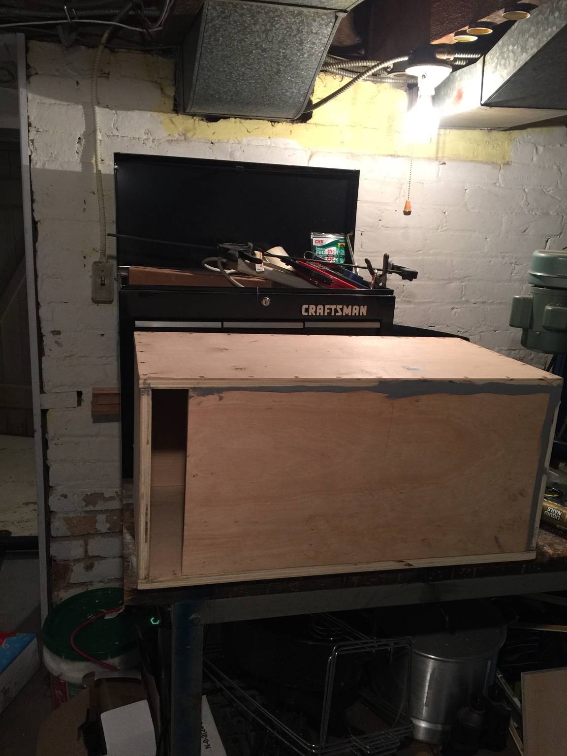

Here it is , I should finish tomorrow- going to carpet since I ruined the finish with this dark gray glue, lol . I'll keep you all posted .

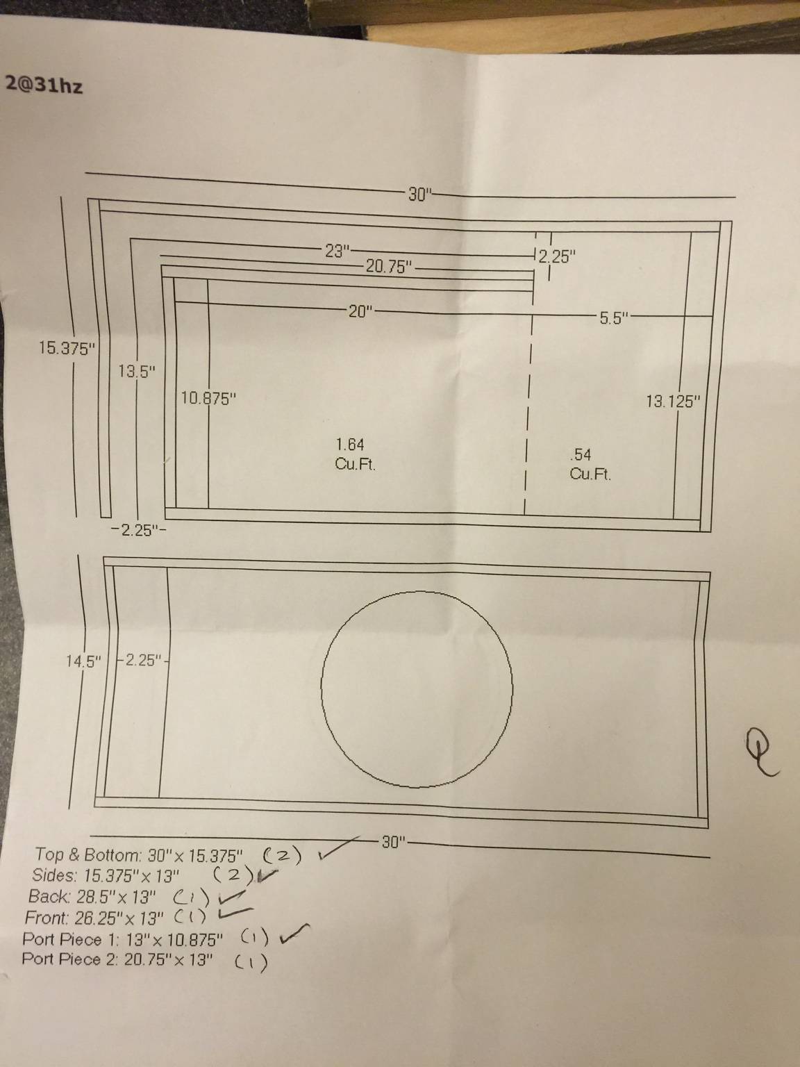

I changed my mind by the way and went with 2cu @ 31hz - want it low but read a lot comments in Google about people regretting getting that low - felt safer at 31hz.
you can always chop off port length if you want a higher tuning. Just telling you that that sub cant hit anything over 50hz for sh*t, no type of box will change that characteristic of it. I've experimented with too many box builds for that sub. Just dont be alarmed if you are missing those notes. Its natural.
Just play some 20-45hz music/movies and you should be pleased.
