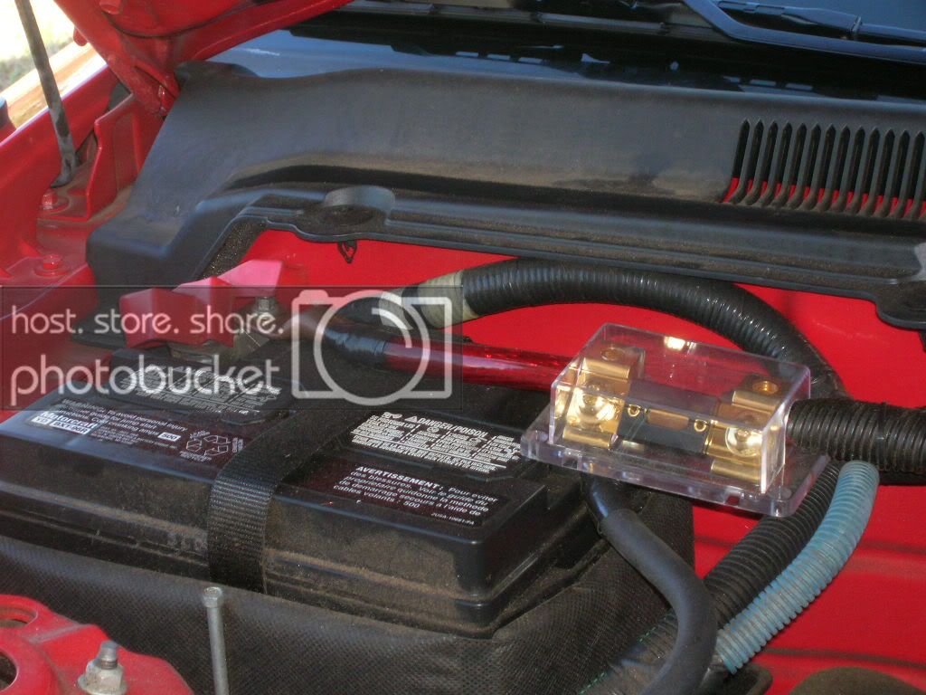

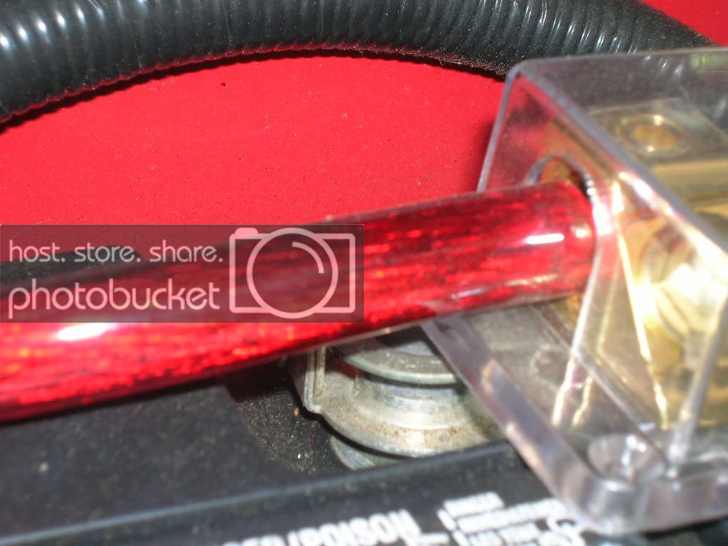

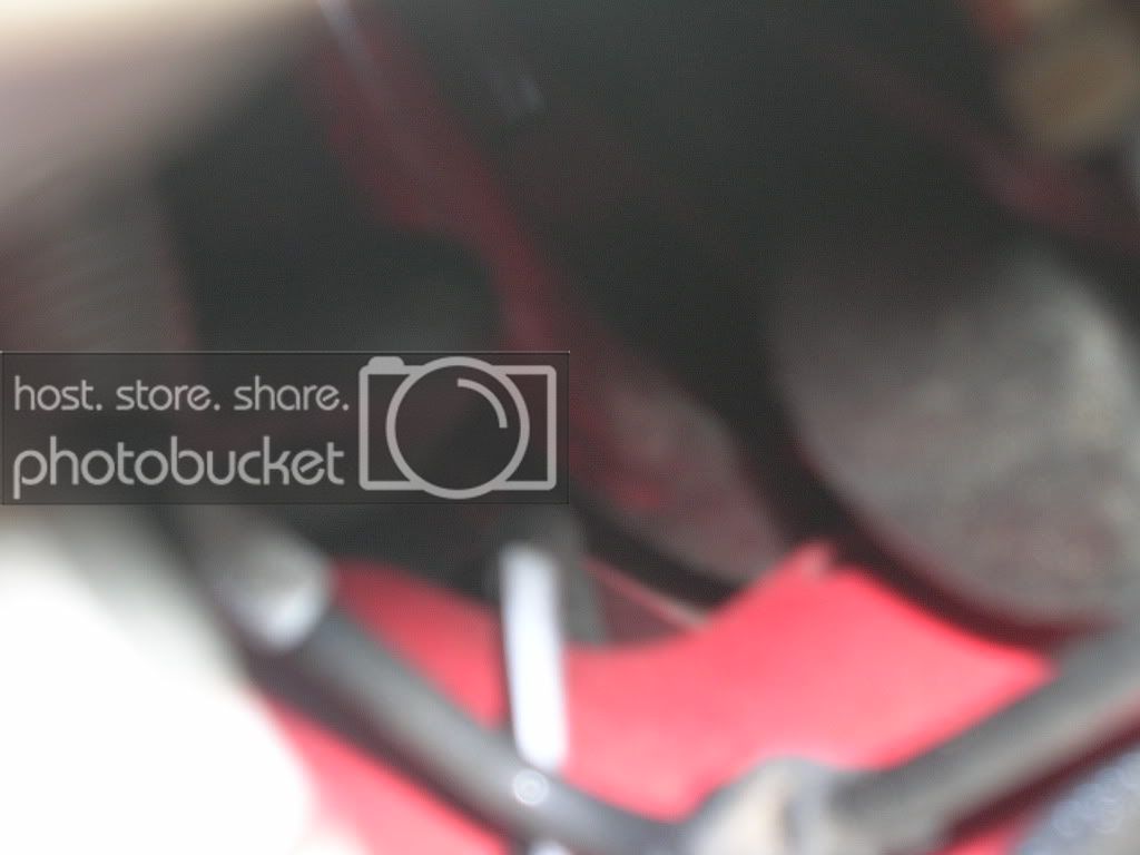

to start off, they ran the wire straight over the battery...if you cant see the problem....let me give you a closer view.
while the fuse is in a plastic container....its the fact any LOCAL SHOP would THINK about running a POWER WIRE over a NEGETIVE TERMINAL!!!
ah yes.....metal edge touching wire

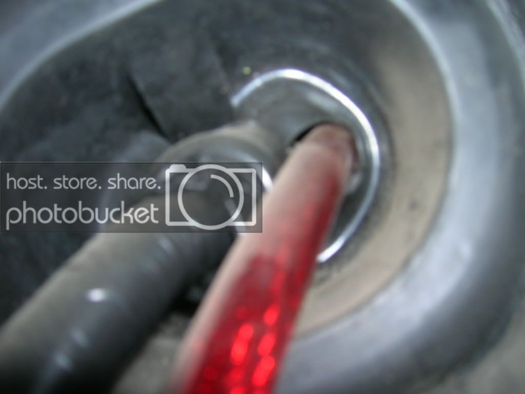

atleast FORD helped them a little....stock grommit with power wire through.

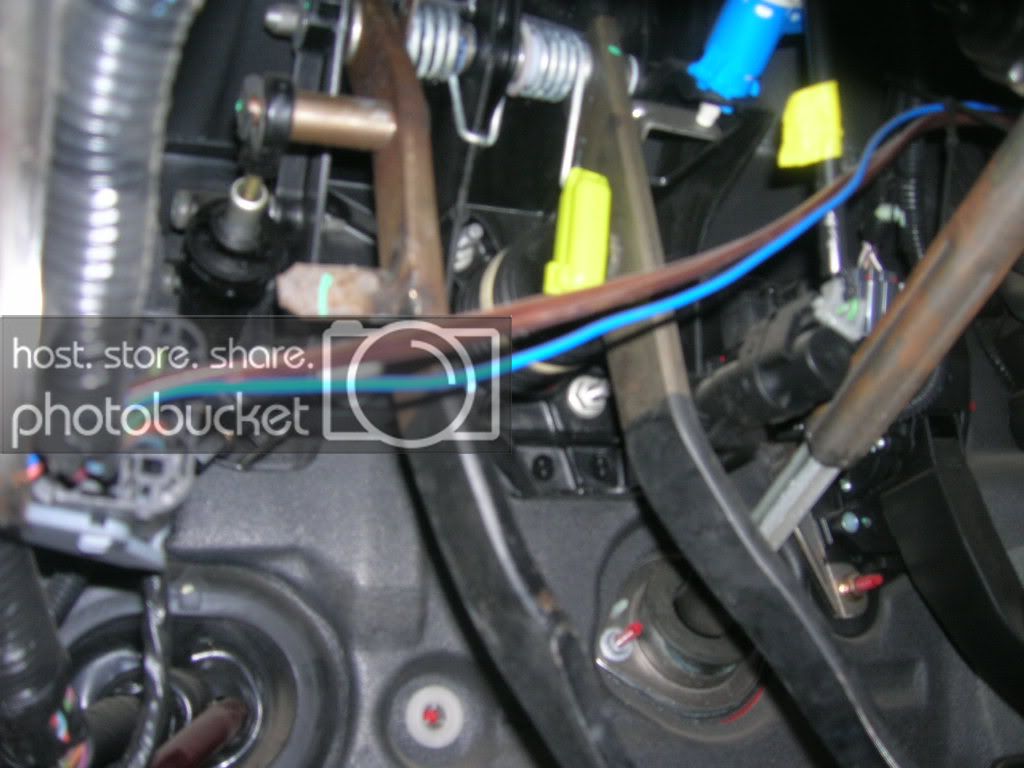

I had my head unit installed by a local shop in orlando and it was super clean. I had this shop remove the deck, install a remote wire, and run it. loose as a goose above my feet.

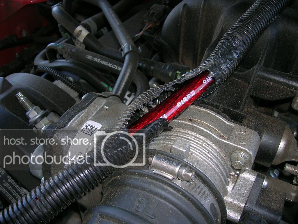

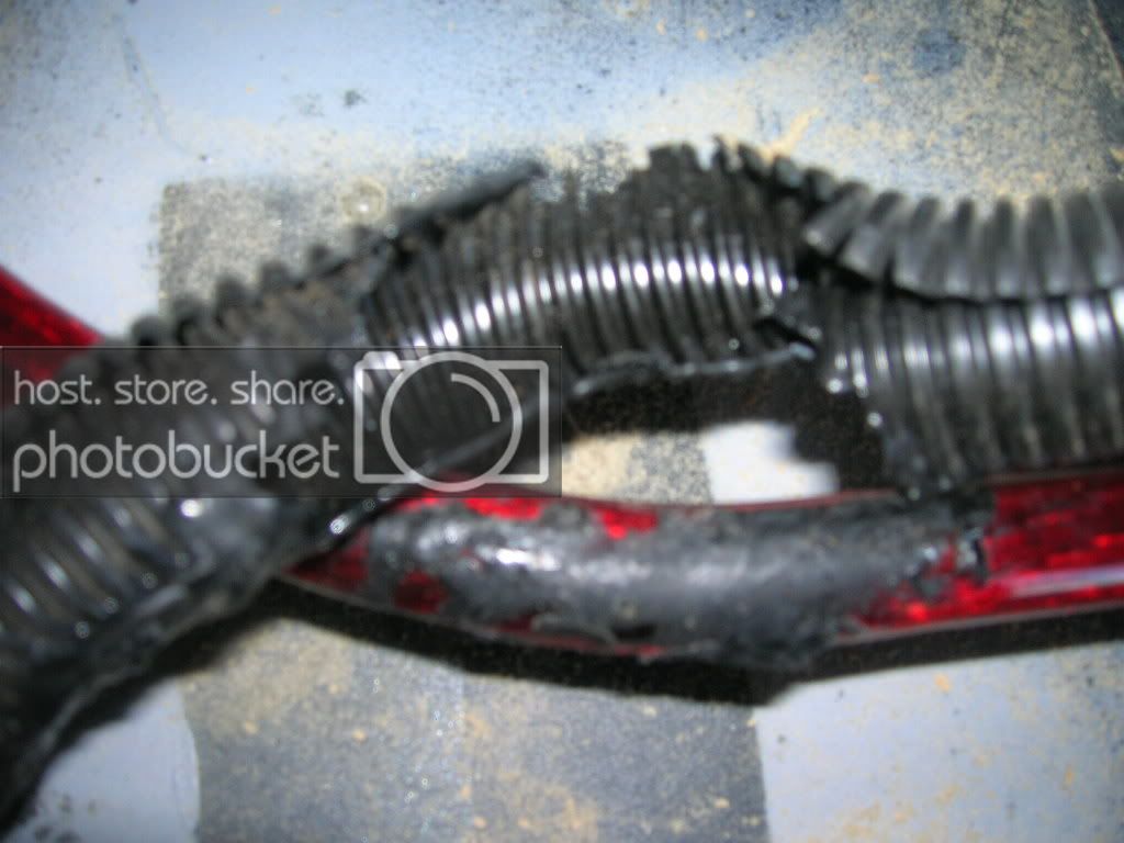

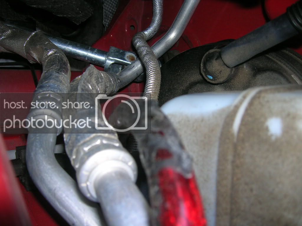

I decide to pull off the black wire loom that was covering my wire before trying to pull the wire through the dash, for obvious reasons. Well what I find is not what I expected. This shop ran the wire down by the header and cats, which in the end...resulted in this.
another pic so you can see more closely what happened.

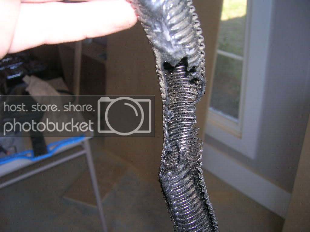

ah yes....where it melted.
aaaaaand last but not least.....a side by side.
