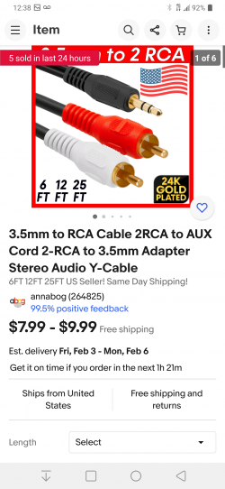

My amp does not have an aux input on it, neither does the LOC. but you did give me an idea. I could possibly buy a cheap lil aux cord and modify it with some speaker wire and connect it that way right? To test atleast
