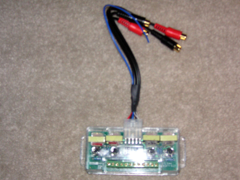

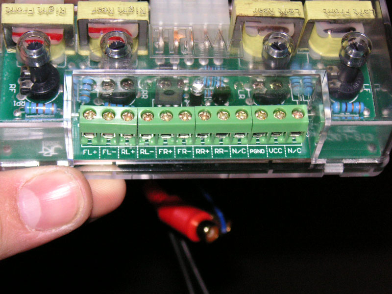

My 4-ch line level converter has ther normal 'RR-' 'RR+' 'FL-' and so on, but it also has four more slots for (in this order) 'N/C' | 'PGND' | VCC | N/C.
What are those for? I assume the PGND is to ground it. Also, the converter also gives me a remote wire to hook to my amp.
I know I'll probably end up talking to myself on this one, But I've got a humming I can't get rid of now. I have two line-level outs now. The 4-channel (for my active front) and a stinger 2-channel for my sub. When I hook my sub RCAs to the 4-channel LLC, no hum. But when I hook my sub RCA to the other LLC (stinger) it hums. I connected the ground, but it still hums.
Any ideas? Maybe a defective unit?
