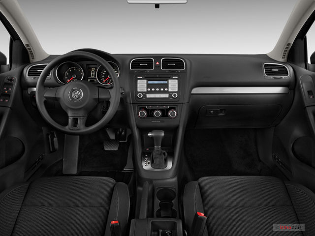

For those interested I have a mk6 golf with a factory base model head unit... thats right the lowest trim basic non touch screen one with a super tiny blue display and a simple selection of instantly responsive tactile buttons. The head unit does everything I want it to from a functionality and design perspective. I use my head unit for nothing but music and hands free calls. No android auto, no music over bluetooth, no massive touchscreen, no bullshit. I never text, know how to park without a backup camera and mostly play locally stored quality music off my phone via the line in and occasionally playing some cd's. Photo provided (although I drive a 5spd.)
