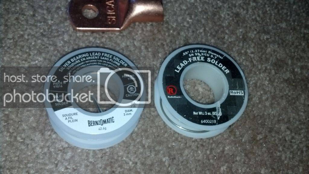

With the two in the pic though, the one that does not say silver bearing - there is no flux in it.

A lot of electronics these days are using lead free - so electrically I dont think there would be a problem.With the two in the pic though, the one that does not say silver bearing - there is no flux in it.

I was going to use the thicker stuff for the lugs. That's what says silver bearing. The smaller solder is what I use with my soldering iron on smaller wires.
