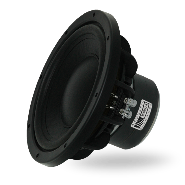

So generally speak-ering, You want the driver to be as close to .707 qts as possible and if memory serves me, you really want to be close to. .5- .6 to account for the coupling of the woofer to the cabin. Good xmax too, need to be able to move the air.
If you have the cash for four of them, I'd look here first.
If they're a little too rich for your taste (or like me, my back pocket) then take a look at their specs, try to find something close.
