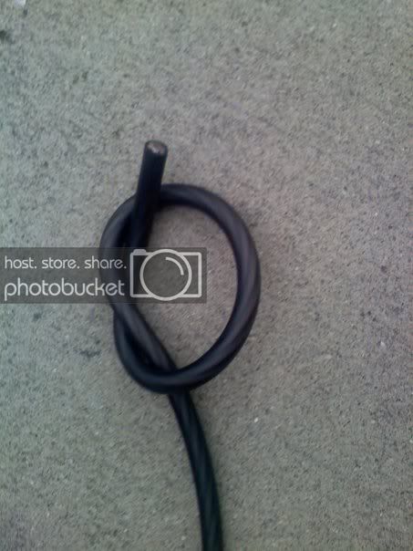

is the kolloseus worth the money? i have the klmx and its a pain.
let this be your answer. knu kolossus flecks 1/0^^^
