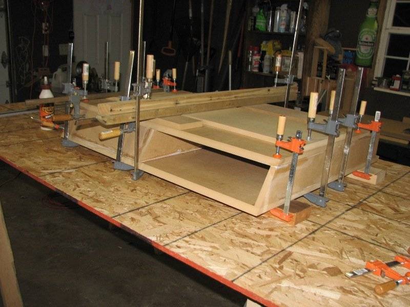

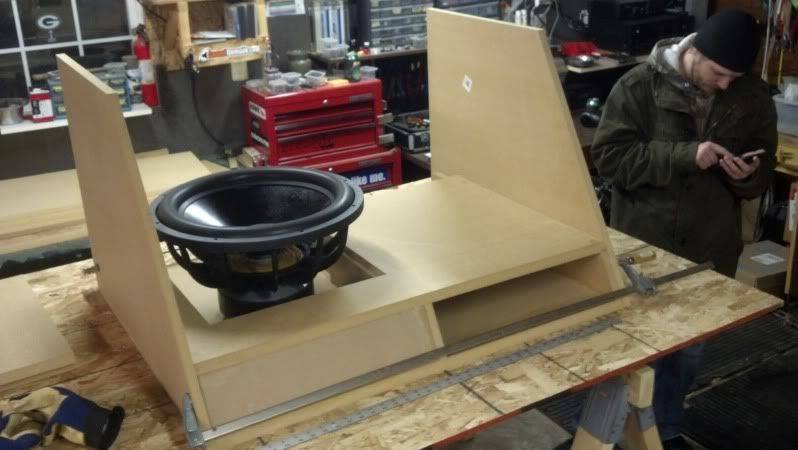

modified design. i want the sub on the bottom. so i'm mirroring the front.
did a mock up this evening. still have port work to do.
I need another 4x8 sheet of MDF. Two sheets in it so far, minimal scrap.

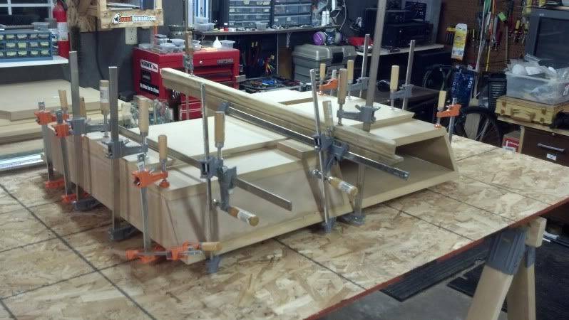

We still have a lot of work left. Besides gluing and bracing, i will be using resin and fiberglass at the seams and mounting location. then i expect to use bedliner for the exterior covering for both enhanced strength and protection. lots of work left.

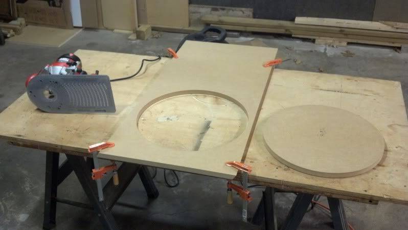

tonight i think we'll insert t-nuts for woofer mounting, cut the hole for the 45Hz port and put t-nuts in there, and maybe glue the fronts and tops together. i think it will be better to glue the layers together before assembling them - so i can clamp them tighter.

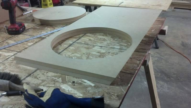

Why wouldn't you flush mount the sub? That generally gains AND looks nice.
you may notice that the front will have a lot of seams. I will cover it all with another board, either 1/2 or 3/4" MDF. that will be routered at the port and sub and edges. that board will come later.
