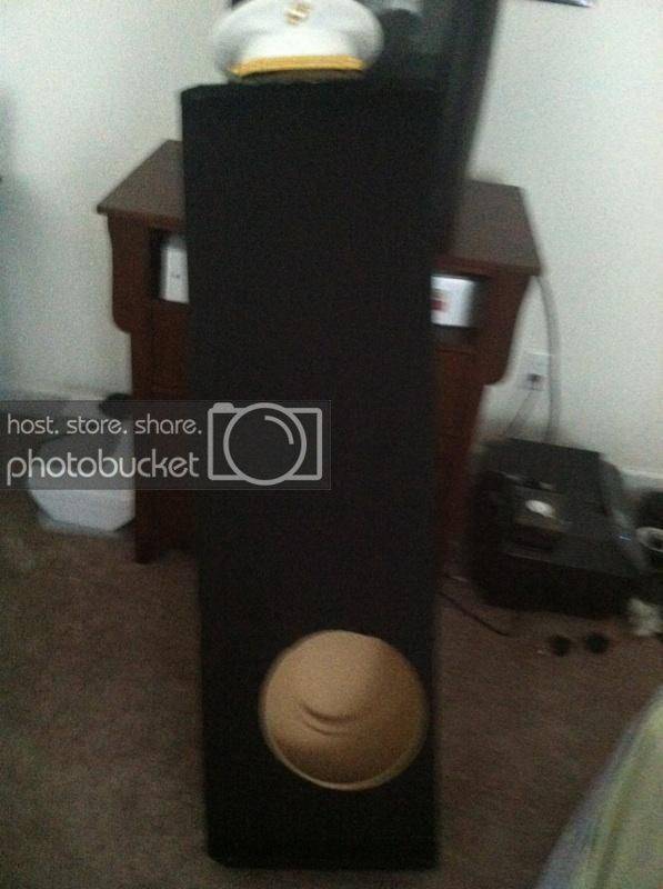

Box: 2.2 ft^3 @ 33 hz (under rear seat)

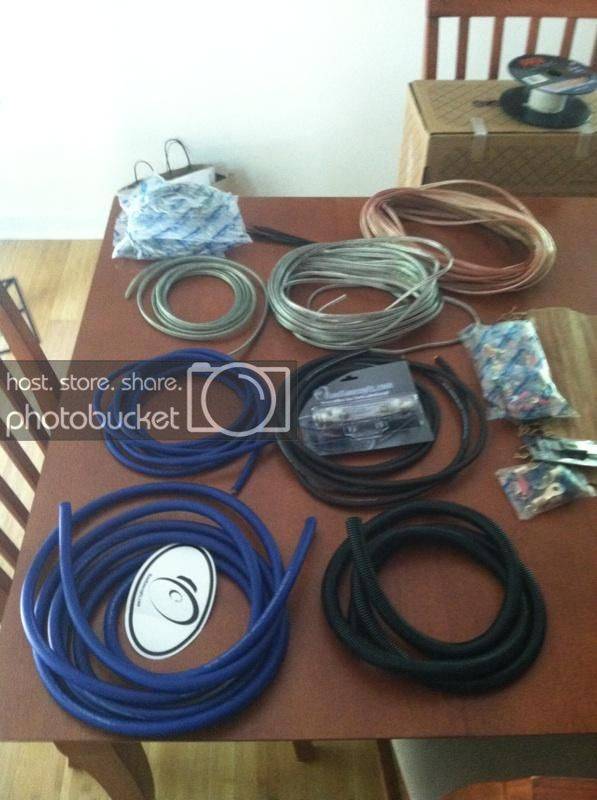

The Wires

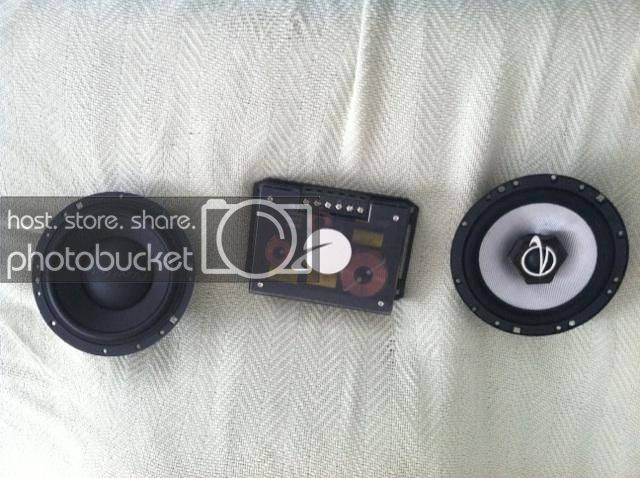

Front and Rear Stage

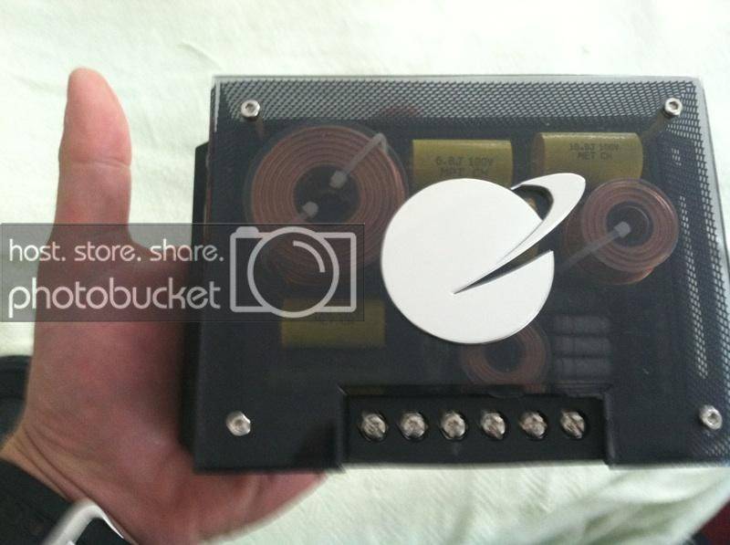

Huge crossover
Box

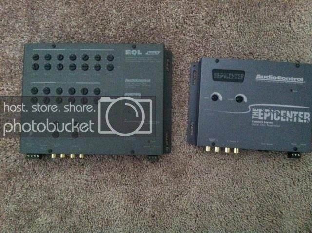

Processors

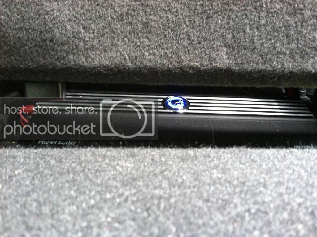

Sub Amp: Planet Audio BB4000.1
Front Stage: Planet Audio BB Pro 6.5 (Anyone remember these!?)
Rear Stage: Planet Audio BB650

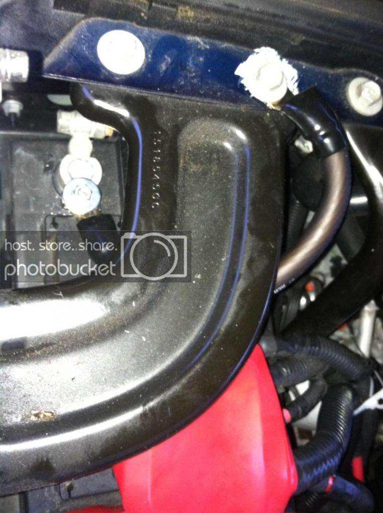

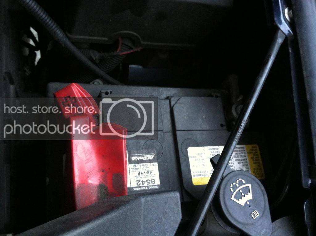

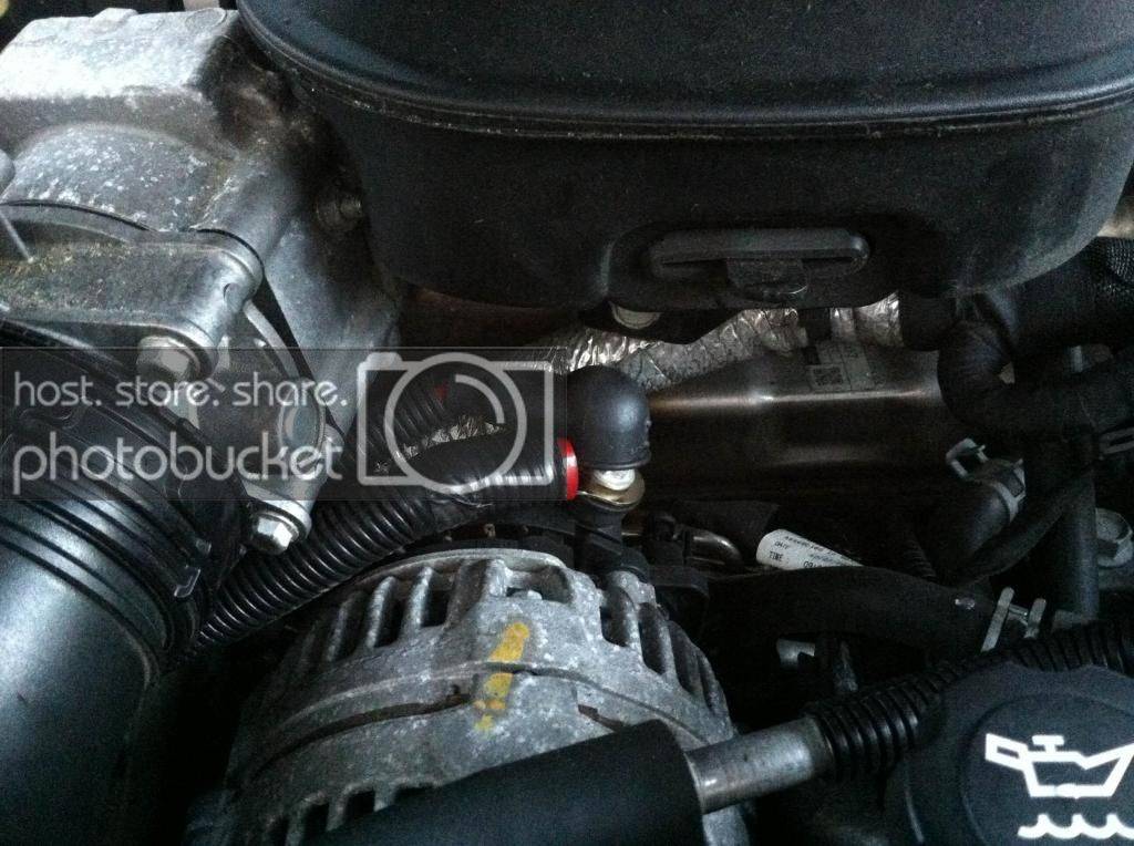

I did a little work on the electrical tonight. So the truck has two batteries, both batteries are directly connected via a 125A fuse and 6 awg wire. The main battery is 80 amp-hours and the second is 60 amp hours - I ordered a Duracell 100 Amp-hour battery, I am debating if I want to interchange my main battery, second battery, or simply add the Duracell in the cab. I decided to leave the connection between both batteries stock and upgrade the alt -> main battery and the main battery ground with 1/0 awg wire. Before the upgrade, I was sitting at 13.8 volts running, with the upgrades I idle at 14.3 volts. Below are some pics.
The upgraded ground - finding a decent ground was a struggle, I ended up bolting it to the hood frame stiffener
The second battery - pretty simple setup.
The 1/0 awg upgraded alternator connection - note that the alt is 230 amps, which should suffice for my setup.

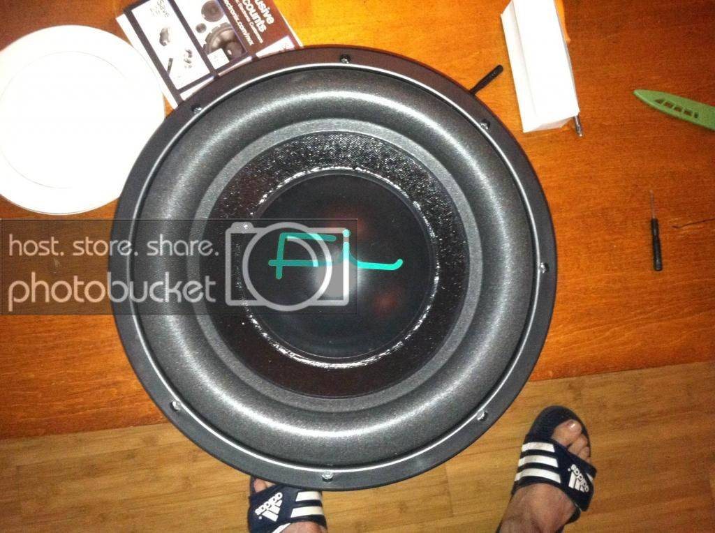

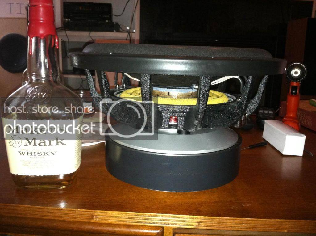

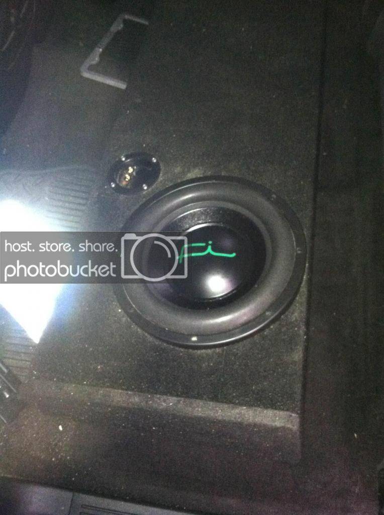

A bit more today, I got next to nothing accomplished due to beer and almost complete apathy after getting back from deployment. I did, however manage to receive the BL in the mail - I must say, this thing is way more beastly in person! Excellent. I put it in the box... it didn't fit, but that wasn't going to stop me form making it work. After some necessary trimming it squeezed in there with .25" to spare on all sides of the magnet. I think this is the biggest sub I've ever seen under a rear seat (the 12 BL has a mounting depth of 6.75 in and the max mounting depth is 7 in...). I put a high excursion grill for the down firing sup to straighten the carpet out, there should be no excursion issues with the 18mm xmax. Some pics:
Green Logo!
Full beast mode
In the box

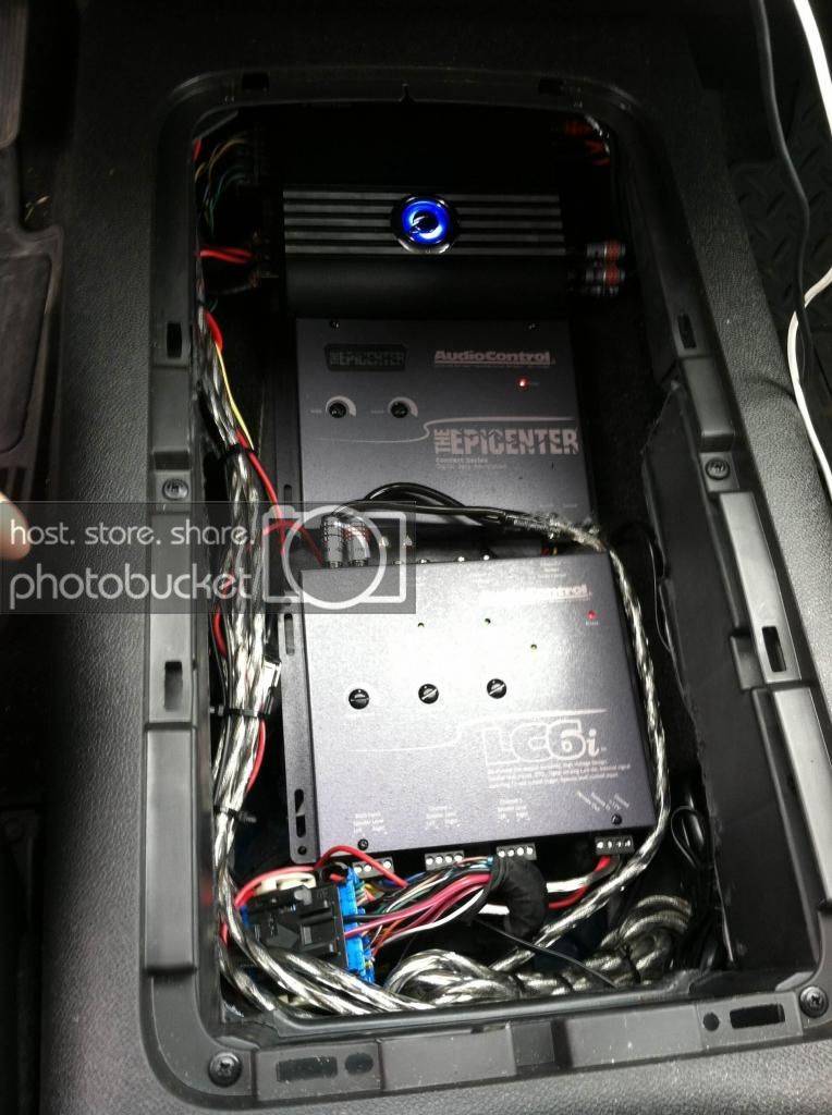

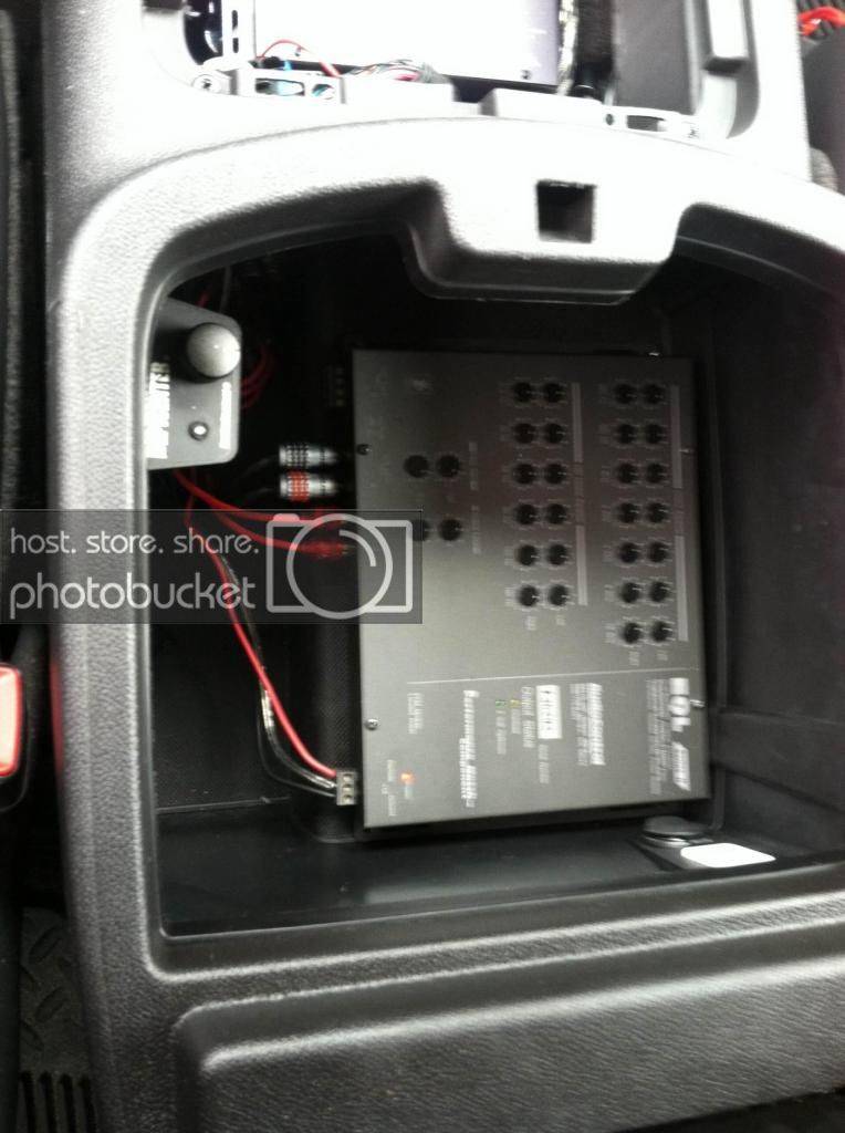

Hey guys, got the rest of the stuff installed. Had help from Jason locally, what a big help he was. The processors are under the console where that godawful Bose trash was and the EQ is in the center console for ease of adjustment. The epicenter is a bit of a challenge, it adds so much bass! For most songs, the epicenter seems impractical - but for theater and songs with a minimal bass signal I can certainly see the advantage.
Overall, I am extremely impressed with every component of the system, there was a lot of equalizing to do. The BB amps work flawlessly, I have the BB4000.1 wired at 4 Ohms into the BL... It is plenty of power for now - I would say at full tilt I am at about 80% excursion on the BL. The BB1200.4 also preformed excellently, it is clear with plenty of power to handle the BBPRO6.5's rated at 150 RMS/speaker. Speaking of the front stage BBPRO6.5's - wow, they can handle a lot of power and sound fantastic doing it, they remind me of the old RF Power 6.5's. Here are some pics.
The processors and 4 channel in the console.
The EQL in the center console
The BB4000.1 behind the rear seat
