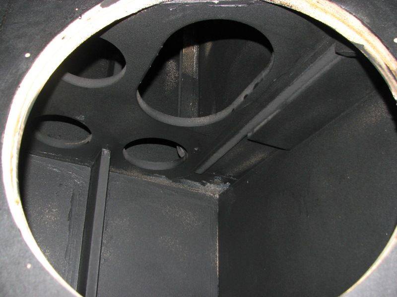

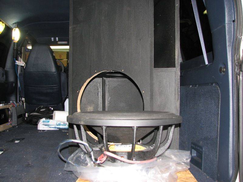

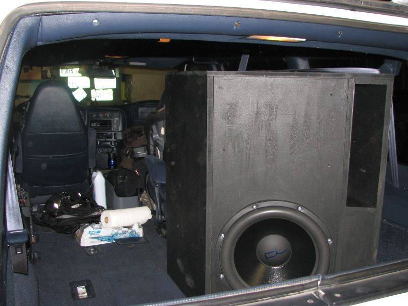

box is assembled and sprayed inside and out with bedliner

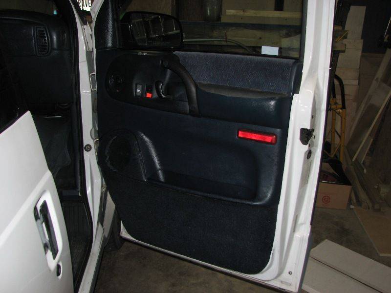

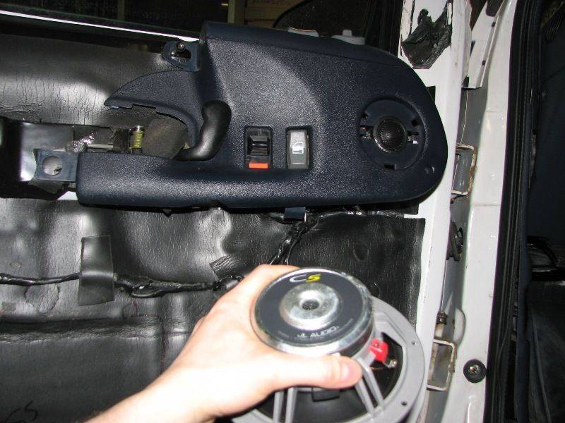

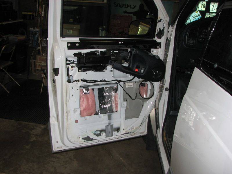

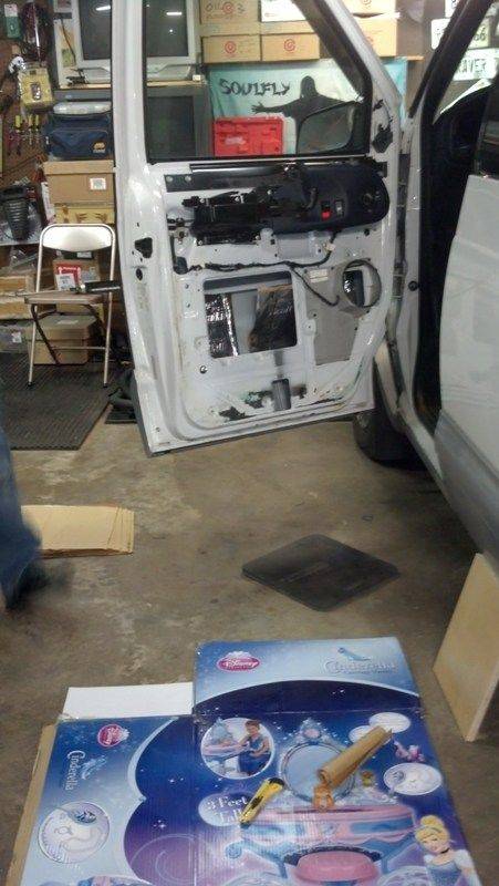

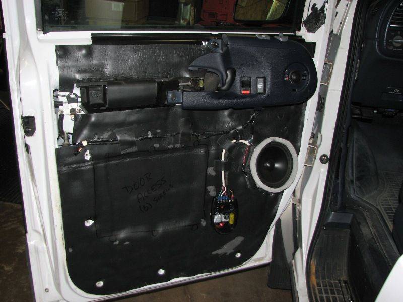

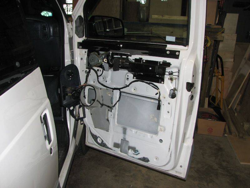

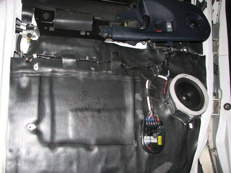

while that was drying, we worked on the doors. while this is SPL capable, it will be an SQ daily.
factory

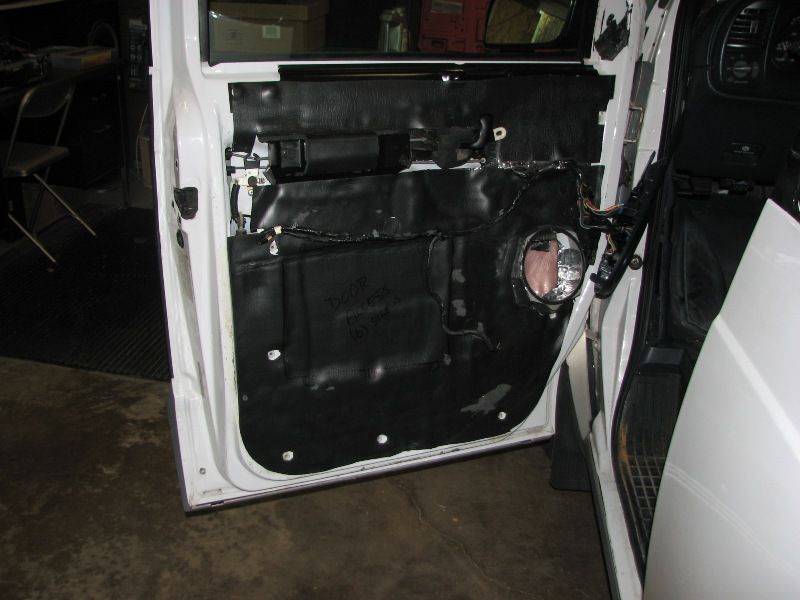

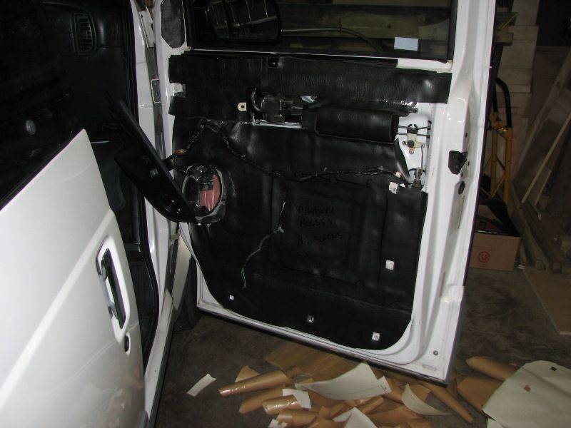

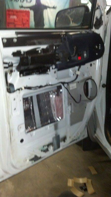

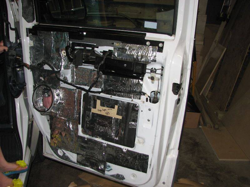

used a Trunk kit of Stinker Roadkill Expert, 20 sf total, used about 8sf per door.

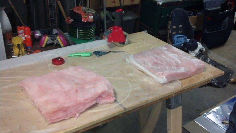

also did bags of 0.5mil PVC encased fiberglass batt insulation for sound absorption.

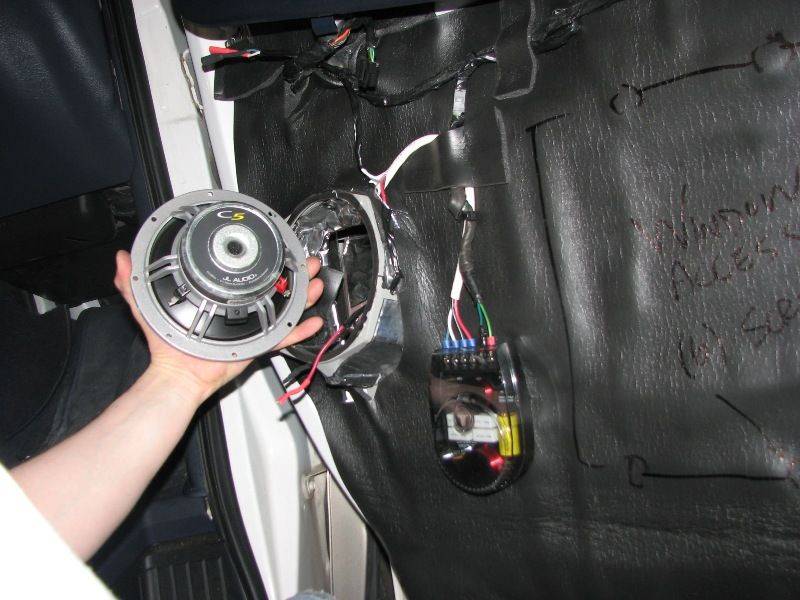

then covered the entire door with Stinger Overkill - this stuff was thick and heavy.

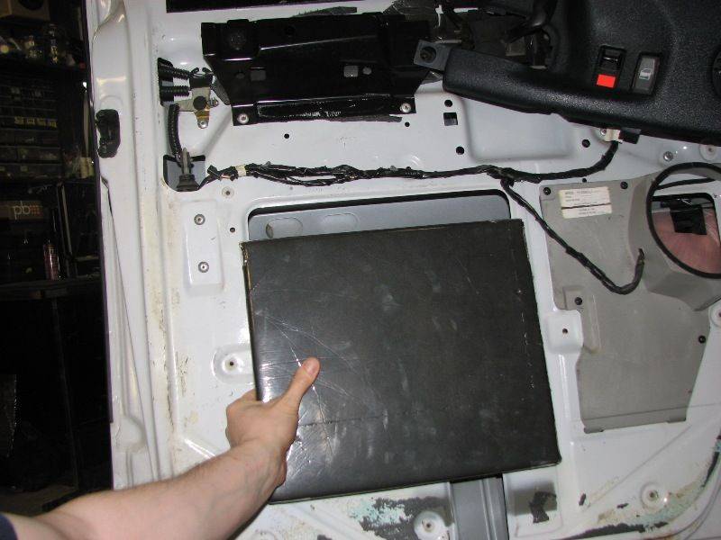

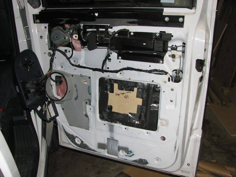

for the large holes, i had 3/4" UV treated birch that i wrapped in the factory closed cell foam sheeting. then screwed to the door, but located the wood on the inside. worked well.
both doors looked like this
foamed and sealed

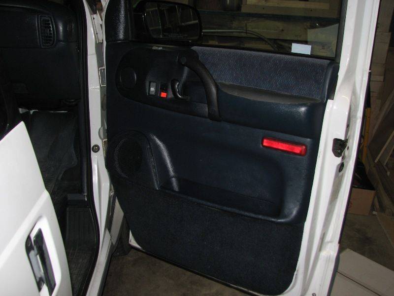

a beauty panel will follow shortly.

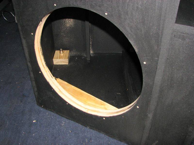

you may notice that we used a Grade 8 bolt to hold the seat belt clip to the box. this was extra insurance that the box wouldn't kill passengers. there are much larger Grade 8 bolts holding the box down to the floor, i can post this since no one would want to attempt to steal the box anyway and the time it takes to do so, you would be shot before you even got the sub out...
she wangs hard.

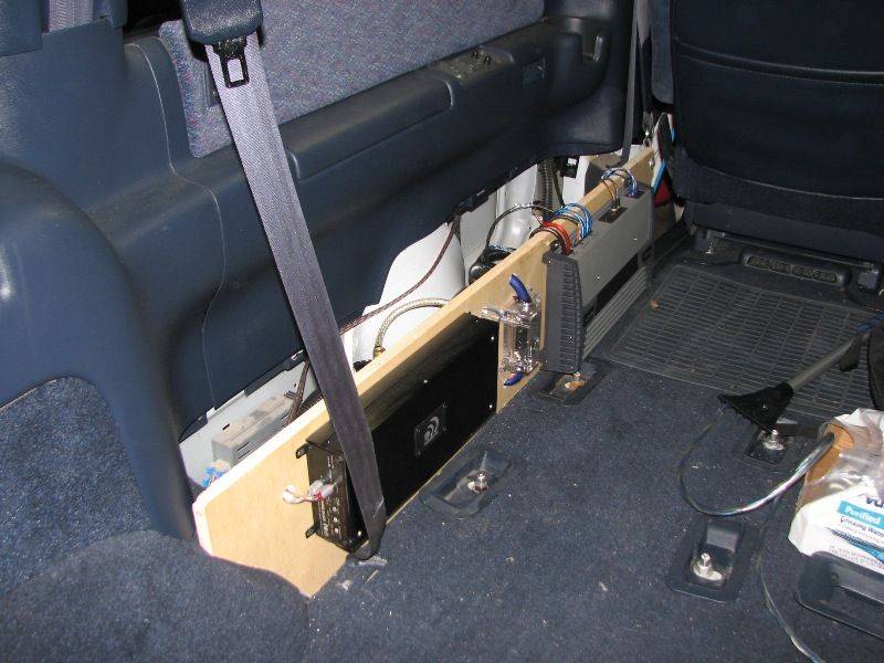

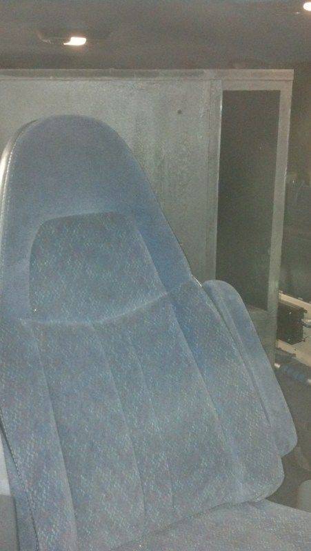

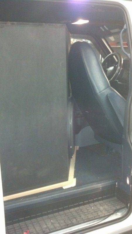

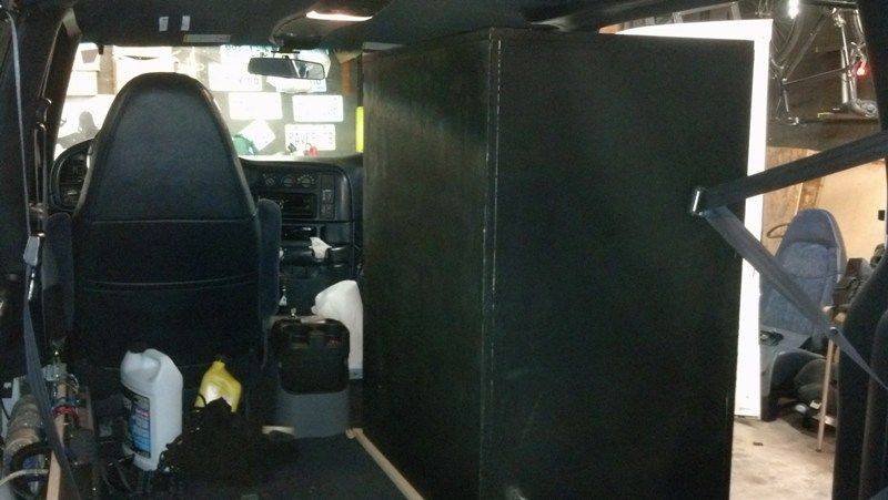

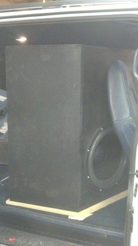

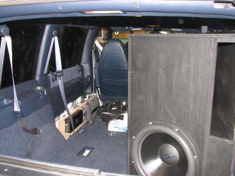

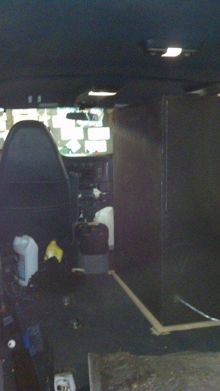

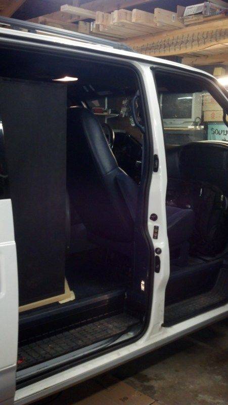

Last night we were hunting some loud rattles and found the jack/ramps/etc. were not secured. Also found a rear heater unit that was leaking coolant. so we had to pull half of the carpet up, which meant moving the box. I figured for the event we would want the box closer to the mic anyway, so we moved it here (still bolted for safety) - crappy phone pics at 3am.
passenger seat is reclined. the box is actually behind the B-pillars.
