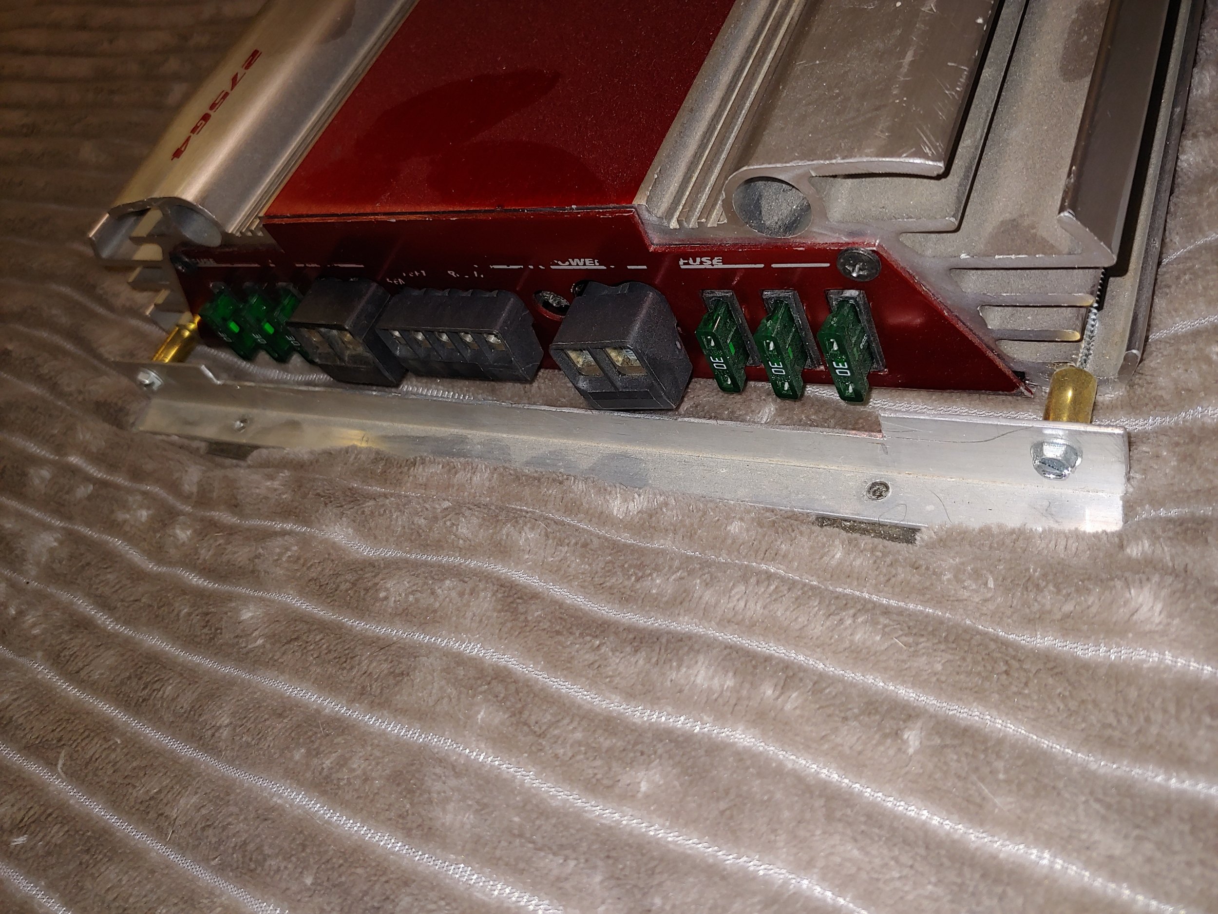

I actually got this amp in a trade. It too was burned out with a shoddy repair attempt. Guy put fets, diodes, & resistors that had no business being there. It is a two channel, so side 1 & 2 are mirror images. After months of downloading gut pics we were able to verify which components were correct and resurrected it. I acquired the side screws at Lowes. I also made the legs out of 3/16" aluminum angle gapped from the side panels by 1/4" ferrules. Does not look as good as in my mind's eye, but side panels are no longer being scratched.
