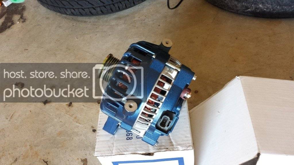

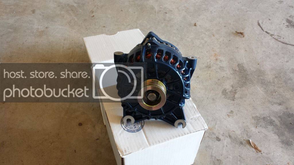

Js Ultimate Alts
It does 175 at idle and 275 at 1200 rpms. It's doing great on 2.5k. Starting at 14.2 dropping to 14.1 hot at idle at the up front battery, but 13.7 at the amp. Think I have a grounding issue in the back. Can't get the alt to drop more than a tenth. The real test is coming later this week when u run my 5k amp.
