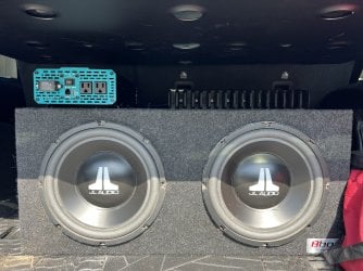

I am on a budget, and now that my son is old enough to drive i’m dusting off my old Gear. I have (2) old school 10W6 from early 2000’s and a kicker impulse 1252XI amp. The subs need new foams which I can have done cheaply but wondering how they’ll sound compared to todays budget subs like skar.
Thanks for the advice!

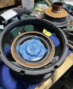

If you can find a diy recone kit for the 10w6s that is would I would do. I bought 2 10w6s off ebay for $150 and reconed them myself. It’s very easy to do. I’m running them in a sealed box with a JL slash 500/1. It’s the cleanest sounding setup that I have heard. I’ve also reconed a JL 12w3 and use it on a home theater setup in my home gym, it shakes the room lol!
