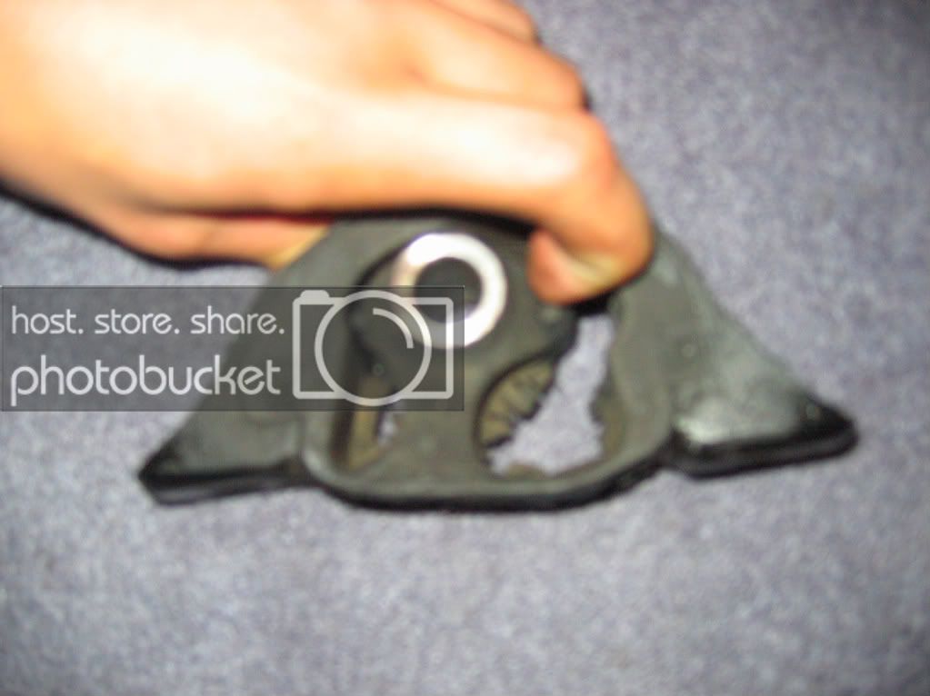

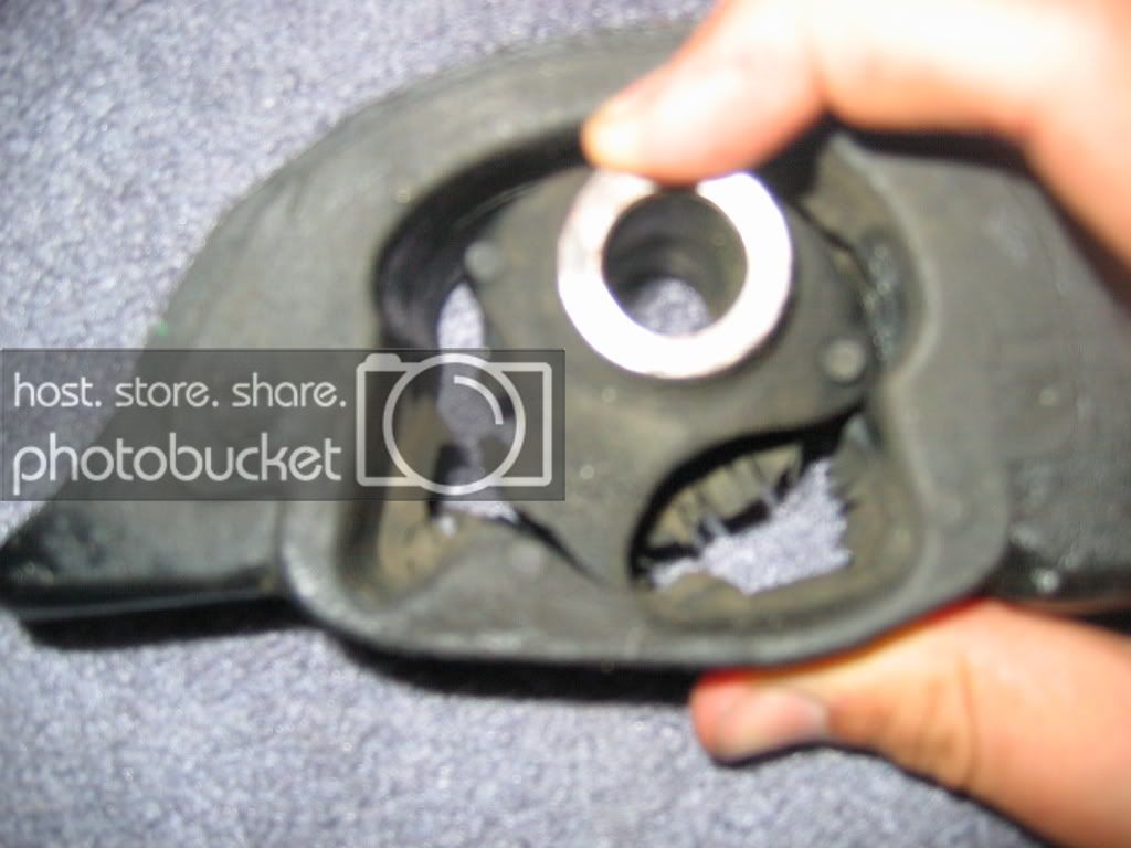

My Integra did the clicking too like drchronic mentioned how it occurred because the transmission mount. Mine looked good while the engine was in but when I pulled it out the spot where the insert would go was torn almost all the way off.

My ****** is still in mint condition and I even took it apart and nothing was wrong with any of the bearings, syncros shift fork etc. same with the clutch, pressure plate flywheel. I never would have thought it was the mount but I have a new mount for when I put my engine back in since mine was almost to the point of fully blown.
I'll show you a pic on how easily hidden the problem was with my mount in a few minutes once I find my old one lol

Everything you said that was happening like the clicking and turning left was how mine was. Mine would ONLY do it when I turned left which is probably because the transmission is on the right side in our engine bays.
My mount looked fine while in my car because the weight would push the two surfaces together and look like this( sorry for having a cheap digital camera that can't focus too well)
When I took my motor out I saw the mount was in bad shape and was like this with no weight
Maybe when you put your ****** back on again a lot of stress went on that part of the mount and separated like this
