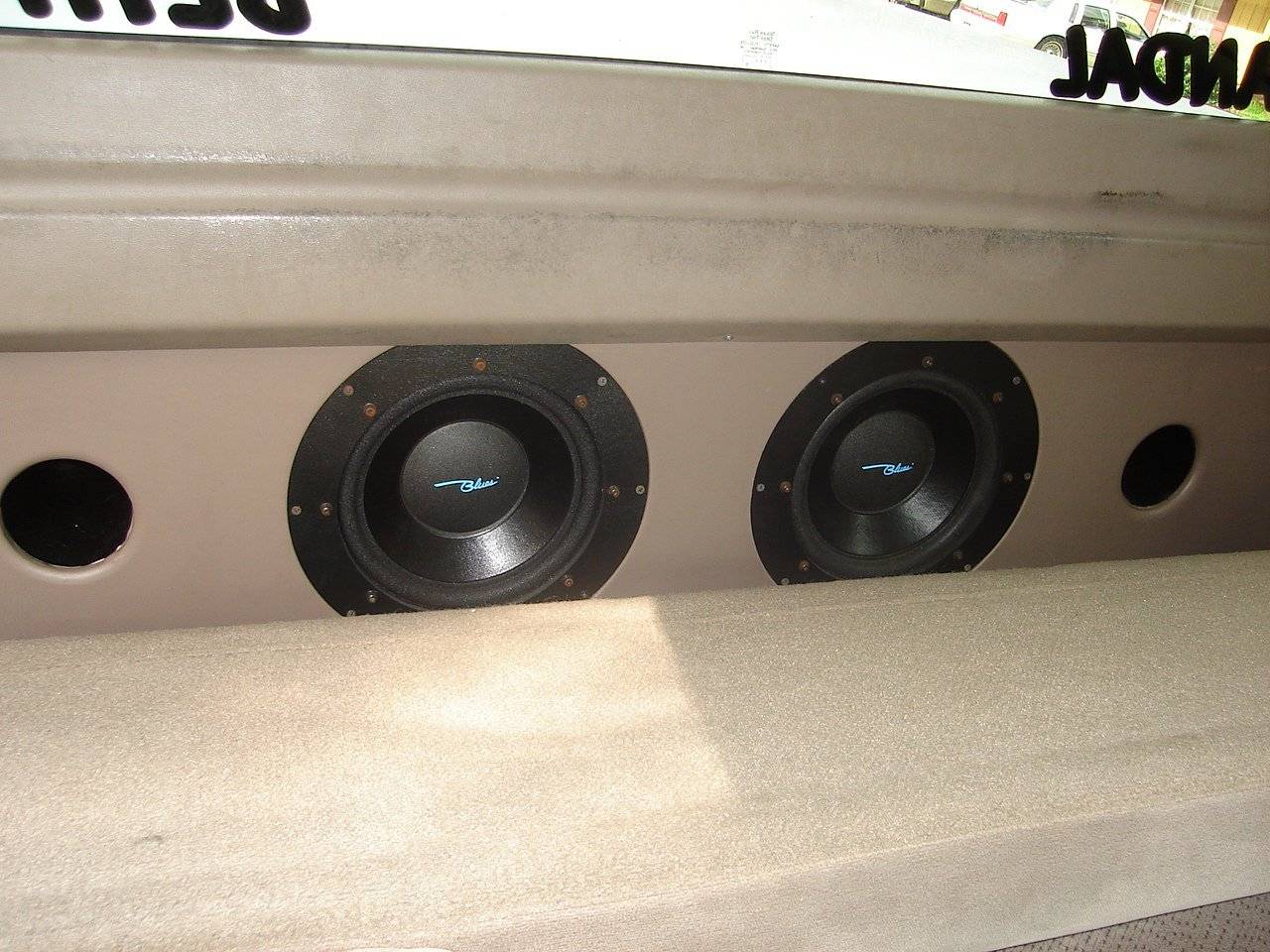

I'm running a pair of Isoberic enclosures in my truck ...
Really half the space of one driver for two in a isobaric load ? I've been told for many of years different.
Yep ... I quoted that from a trusted site. Plus, I've ran Isoberic enclosures for many years ... I'm running 4 10s Isoberic now in my truck ...
