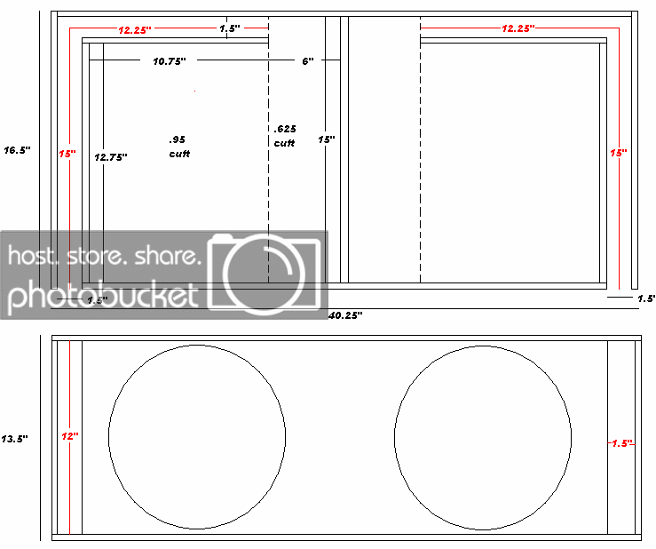

Is this a good design for these subs?
bassknocker23
2.9 @ 33
This should be the right pic.....

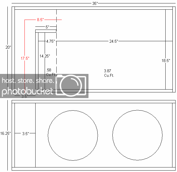

but Im going to put 2 12" type r's
ya 4.3 would do better.. i had my type rs in quite a few different boxes... my favorite was 4.8 @ 35 hz... any of the boxes over 4 sounded good tho
Thanks for some of your opinions guys. I think this is the box I decided on.
Also, is 32 hz good for just bieng loud to the ear? I pobaby never be pt on a tl. So this setup is just stricly for turning heads.
