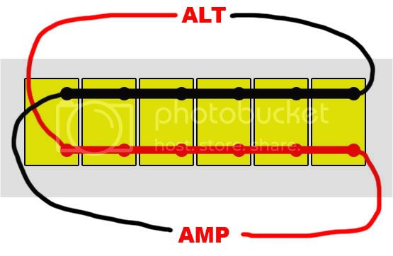

Is this a good battery diagram/battery bank

Actually, your drawing has some flaws.
You should always balance the charge and draw on your bank. If you charge at one end and draw on the other end, you are not spreading out the charge or the draw. The first battery would be charged more than the last and the last would be drained more than the first. The above graphic shows the proper way to balance both connections.

And by alt-, they mean ground, right?

I agree.
It is good to try and spread the load over the batteries in some form. In the OP's form, if he has a lot of current draw between the batteries and not too thick of wire/buss bar then that wire will heat up and cause resistance.
