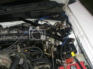

mine is zip tied horribly to the brace. just put it 1/2 way betweet the batt and alt. and yes it is needed.
