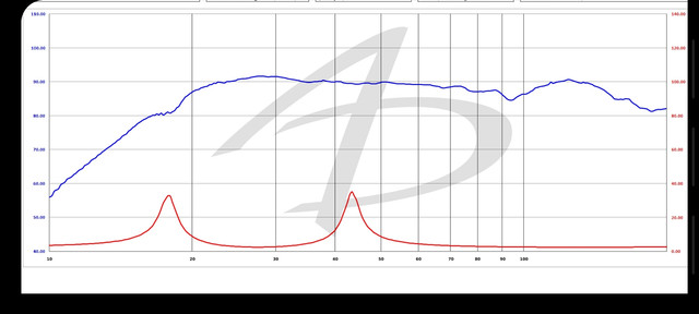

A large ported enclosure is what I would use for spl/sq. Tuned low. This will give you a flat response and higher output than sealed. Figure out the largest enclosure you can fit, then do the port so it is tuned low. I am tuned at 28hz. My box is over 3 cubes. Slot port boxes arent too hard to build.
Here is my box's curve.
