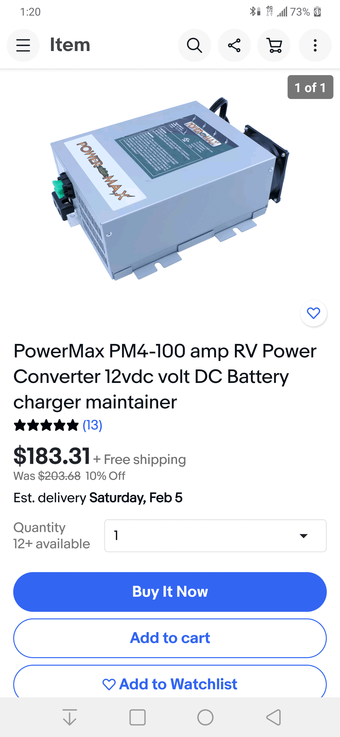

You could use a regular 50a Shumacher battery charger in conjunction with a battery. Maybe an 100a converter instead.
That PowerMax 100 amp looks like it would work well, though no experience with that brand.

Similar to that PowerMax shown above, if you wanted a little easier, you could find an old Cascade Audio APS-75, or APS-90, even better the APS-100 power supply. A lot more money though, but you can connect car audio power wire directly to its block terminals, think it accepts 4 gauge. This is a very simple solution. This style is about as plug and play as it gets. These were really good power supplies, were rather expensive but my experience they worked very well. I think a 75a would just about be enough for that amp in your garage. Though I'd still consider that PowerMax over this one since it puts out 100a.

I see now that there where more pictures on that link than I initially saw. It does have two nice lug style outputs on the side. That thing is actually pretty decent.
