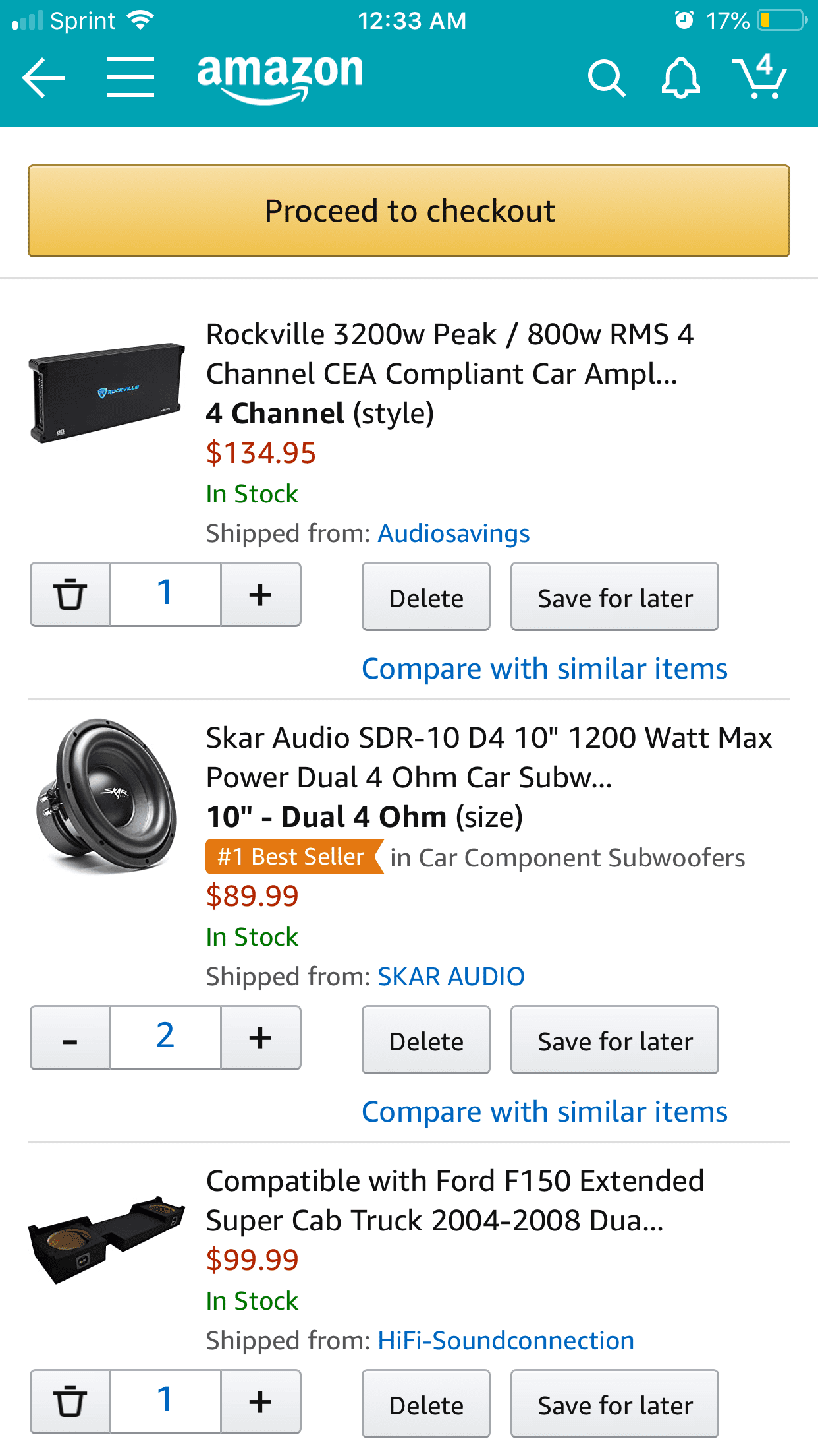

So the most i have ever done with any thing related to car audio was plug in my pioneer headunit and plug in my door speakers. Basically the wiring for both of those where already done. I used to have a powered small sub in the back but that was stolen....
Im trying to replace it with a new better subwoofer setup the basic idea is two tens under the backseat i found a box with the correct mounting depth for the skar audio subs i would like to get now i mainly need help with what wires to buy and how to find a good amp for the subwoofers. Ill post the information for the subs and amp i was considering below. Any help is appreciated like i said this is my first real step into car audio so if im missing any necessary information i will try to fill it in as best as i can
Amplifier power rating information
Rockville dB25 2800 Watt/1400w RMS 2 Channel Amplifier
  • Rockville dB25 2800Watt/1400Watt RMS Class AB 2 Ohm Car Stereo Amplifier With Optical Coupler Technology
  • CEA Compliant Power Ratings (Rated at less than 1 % distortion) (Use these CEA ratings when matching and comparing with other CEA compliant brands such as Kicker, Rockford Fosgate, etc)
  • o 2 Ohm: 350 Watts x 2 Channel <1% THD+N
  • o 4 Ohm: 230 Watts x 2 Channel <1% THD+N
  • o 4 Ohm: Bridged: 700 Watts x 1 Channel
  • RMS Power Ratings: (Use these RMS ratings when comparing with great brands such as Hifonics, Earthquake, Soundstream, etc)
  • o 2 Ohm: 700 Watts x 2 Channel
  • o 4 Ohm: 460 Watts x 2 Channel
  • o 4 Ohm:Bridged: 1400 Watts x 1 Channel
Subwoofer(s) power rating information
Skar Audio SDR-10 D4 10"
  • 10-Inch Dual 4-ohm Car Subwoofer
  • Peak Power: 1,200 Watts | RMS Power: 600 watts
  • 2.5" 4-Layer High Temperature Copper voice Coil
  • High Roll Foam Surround and Competition Grade Pressed Paper Cone
  • Frequency Response Range: 28 Hz - 300 Hz | Sensitivity: 82.5 dB
  • High Flux Ferrite Motor | Advanced Air Flow Cooling Design
