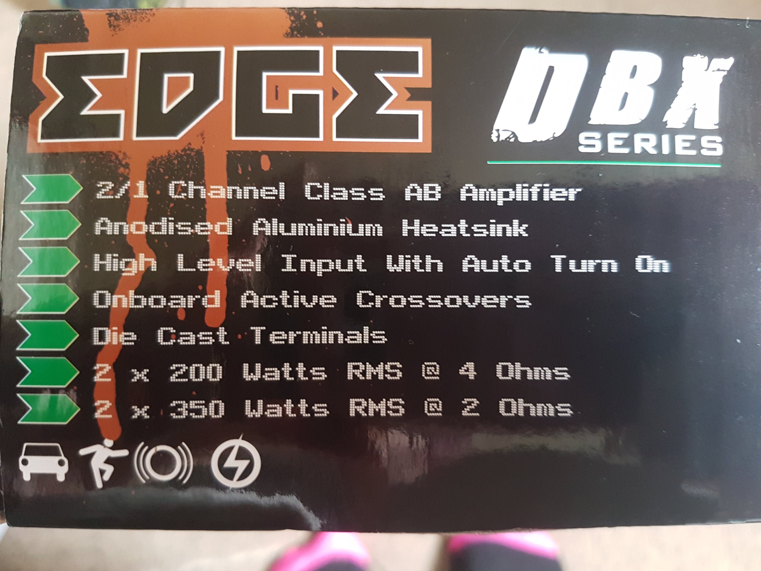

Thankyou for the info and advice :) i think a 5 channel is abit out of my price range hehe. I got a 2 channel (pictured) with the intention of using it for them, but after researching ive found people seem to recommend a class D for subs bc of the power efficiency. So i think im gonna get a mono amp (kenwood X501-1 mono is the one im considering atm, 500w rms @ 2ohms, though if i find a more suitable 300w rms powered one I'll probably go for that) for the subs and utilise the edge amp for the door speakers. Thankyou again!

Keeping in mind OP is in the UK so likely doesn't have access to the stuff we do at our prices.
Kenwood may be a safer bet than a lot of the brands you guys have access to over there. Even at 500W do be careful of pushing those subs too hard.
