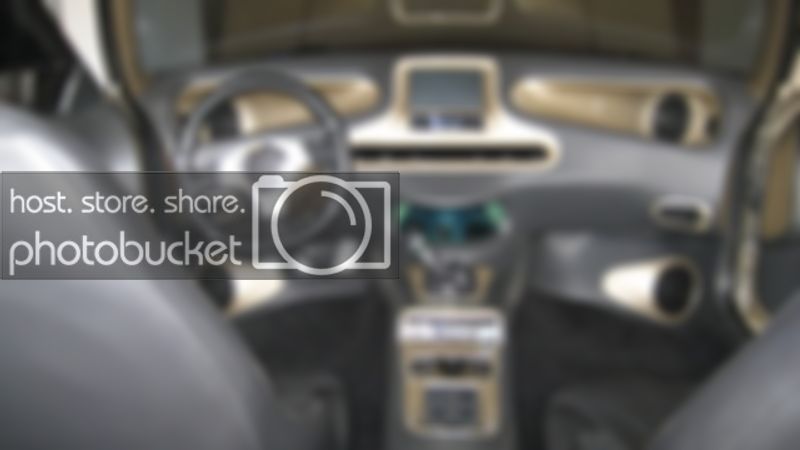

look familiar Ramos :p
We had the diyma meet at your team mates house.
Fooseman's new mustang. Haven't got a chance to hear it in person yet though //content.invisioncic.com/y282845/emoticons/smile.gif.1ebc41e1811405b213edfc4622c41e27.gif
