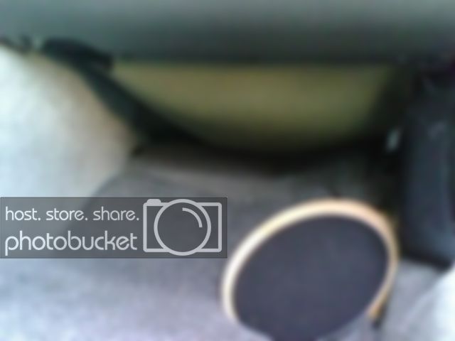

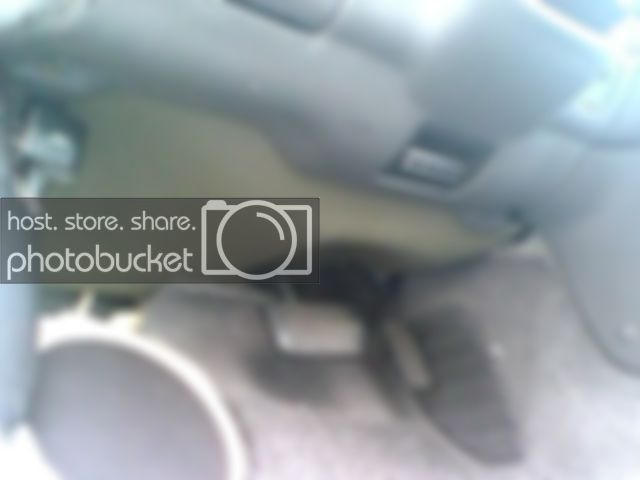

What did you make the underdash panels out of ? I have this crazy arse idea to try suspending some thick *** foam between a couple pieces of open mesh with no backing on either side. //content.invisioncic.com/y282845/emoticons/smile.gif.1ebc41e1811405b213edfc4622c41e27.gif
It's actually just 1/2" or 3/4"(forgot) CCF (camping pad) I had sitting around. I also stuffed (not too much) polyfill behind the foam.
I just cut the CCF into shape and did a pressure fit under the panels and against the firewall.
At moderate volumes, I can actually feel the midrange frequencies vibrating the CCF.
No more midrange barking up inside my dash. The stage(front of course) got much more higher and focused.
