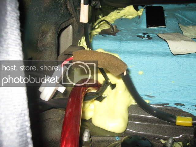

All of these products will aid in covering and sealing all the holes and gaps in the rear deck.... and there were plenty of freaking holes back there.
anyhow. off to the pics.

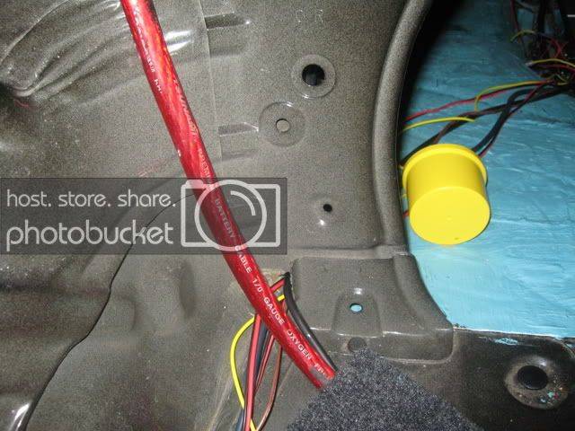

here's an old pic of the rear when i first deadened it
many hoes
I had to reroute some wires so they'd be out of the way and out of the middle section, which is where the birch baffle for the sub will be.

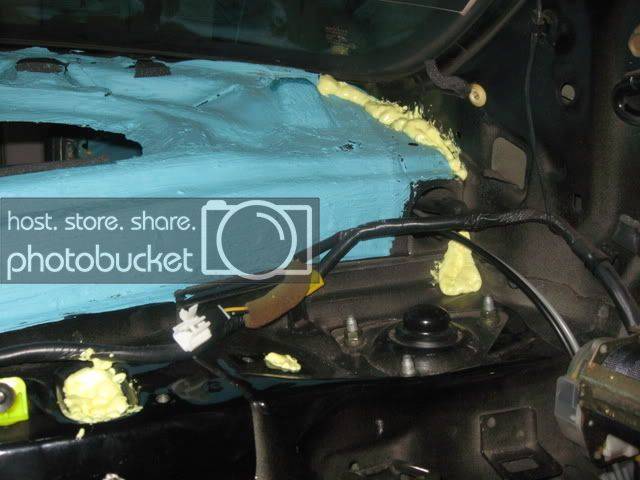

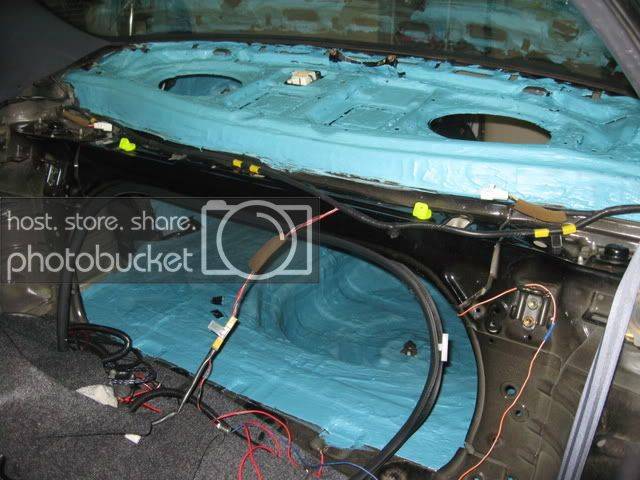

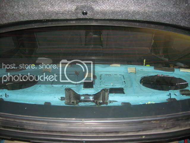

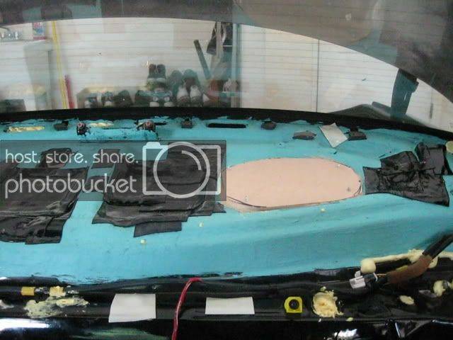

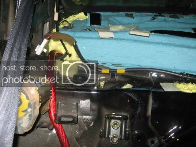

I pretty much got everything all sealed up already, but i need to take more pictures.
this sealing every took me 2 days so far and a lot of thinking/planning before that.
covering the big holes and gaps took up the most time. I wanted to make them as sturdy and air-tight as possible.

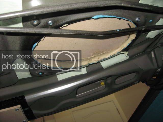

for the 6x9 holes, I took a 1/4" handy panel and screwed it over the hole w/ a lot of this liquid nails type of adhesive to help w/ sealing

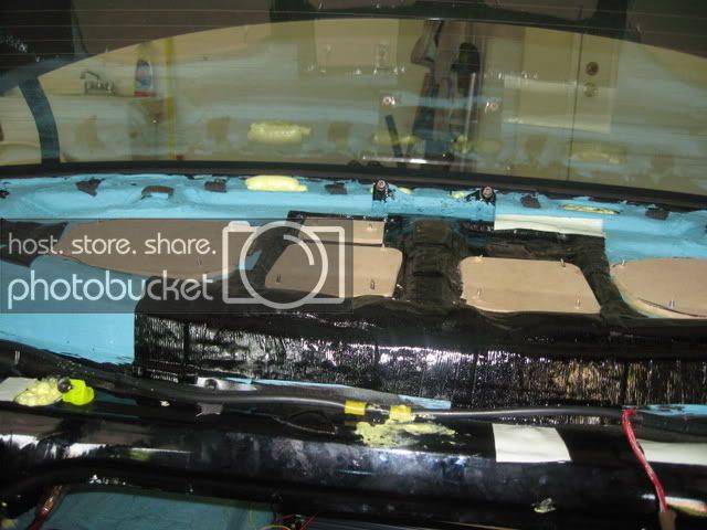

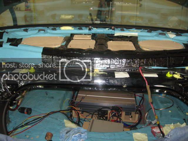

moving along:

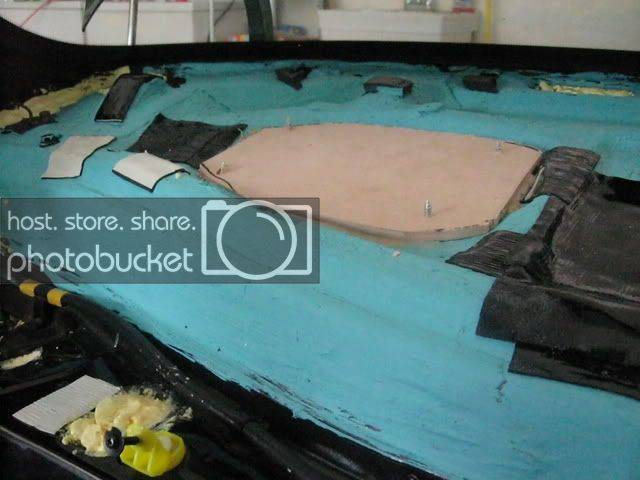

more 1/4" panels and deadener to cover openings.
please pretend you don't see all that crappy wiring. All of that will be changed once I come up w/ a design for the trunk.
6x9 undershot which show many more hoes/openings to the cabin.
