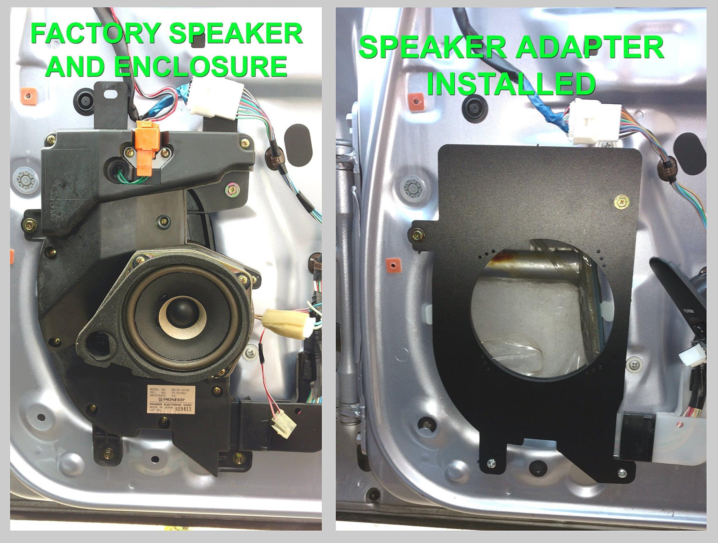

Hi All,
I own a 1998 Lexus SC300, which, like my MK3 Supra, features a plastic ABS sound enclosure inside the door panel. This enclosure is specifically designed to provide the 4" stock speakers with a properly tuned chamber, significantly enhancing their performance.
There are aftermarket adapters available that allow you to install 6.5" speakers in the stock location. However, using these adapters essentially turns the speakers into open-air setups. This happens because the door cavity provides far too much air space for the speakers to function optimally.
Below are images of the stock speaker and the adapter.
Am I better off using a 4" replacement speaker and keeping the baffle?
Also, if I were to replace the speakers, I would ultimately like to keep the stock wiring and amp as I'm not seeking more power to the system, just more clarity as I'm never really more than 1/2 volume in the car server, and while some more bass would be nice, the sub in the rear deck has it's own amp which I can replace.

The vast majority of of 6.5's are designed to be used in doors which is essentially infinite baffle and they'll play just fine.
I'd move up to the 6.5's personally
Here's the thing, I don't want to get into re-wiring the speakers. I'm going to use what's stock and do the stock sized wires offer enough amps for a 6.5 is my other concern.
I've done a few of these. I would us sound deadening material to seal about the plate and the entire door, inside and out. It sounded great. Of course, when I did this, we had to make our own plates. Also, you don't have to put the material all over the door, but I would at least put fill the gaps around the plate.
