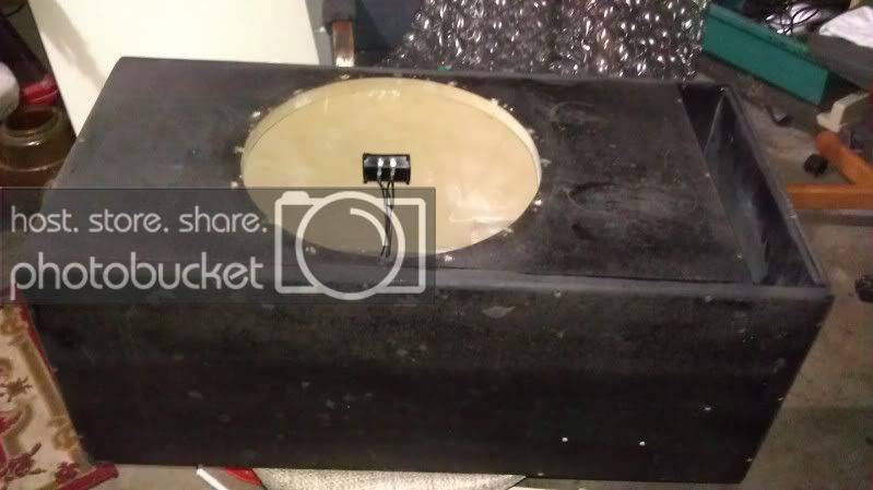

im going to capet my box..help

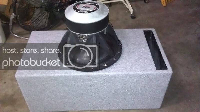

No need to sand unless you have edges that don't line up. Carpet is nice because it hides imperfections well. I like to spray both surfaces that will be in contact then wait about 2 mins to let the glue tack up then it sticks real well. The only thing I don't like about carpeting boxes is that its really easy to make a mess. Make sure to not get the glue where it will show on the carpet, you will never get it off and if you rub it, you just get a flat spot. Its very easy to do this too.

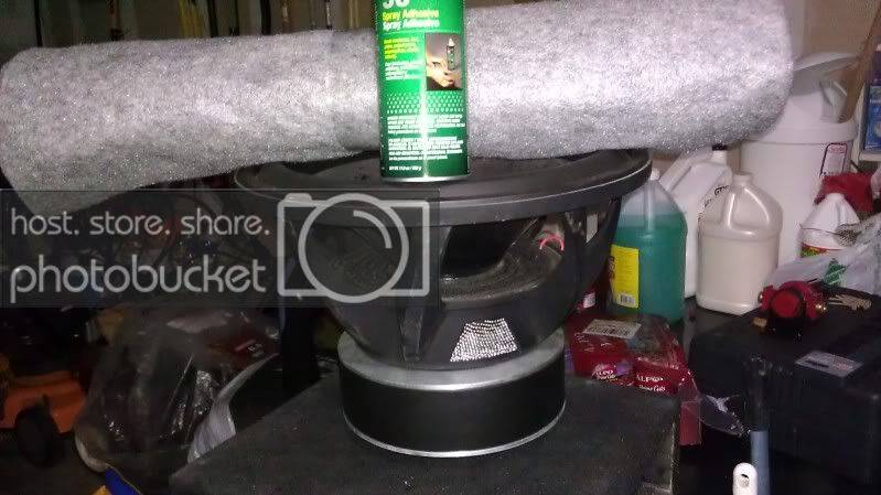

Bout to get sum adhesive here in a couple hrs....shld i be good with the 3m 77 or jus spend the lil extra and go 90....i do have a slighty rough surface the carpets gona b stickn to. Heard the 90 is worth getn...any other tips wld b helpful 2

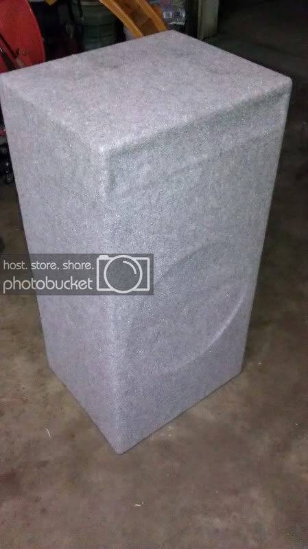

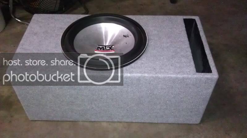

Well it turned out nicely for a first timer...seams could be better but it sure does look alot better than before..and besides not gona see seems in my trunk anyway. And yes my sub has a phat ***...pg xenon 1200.1 will be here to tomorrow! Sub was **** impressive off 500w...1200w should sound righteous.
