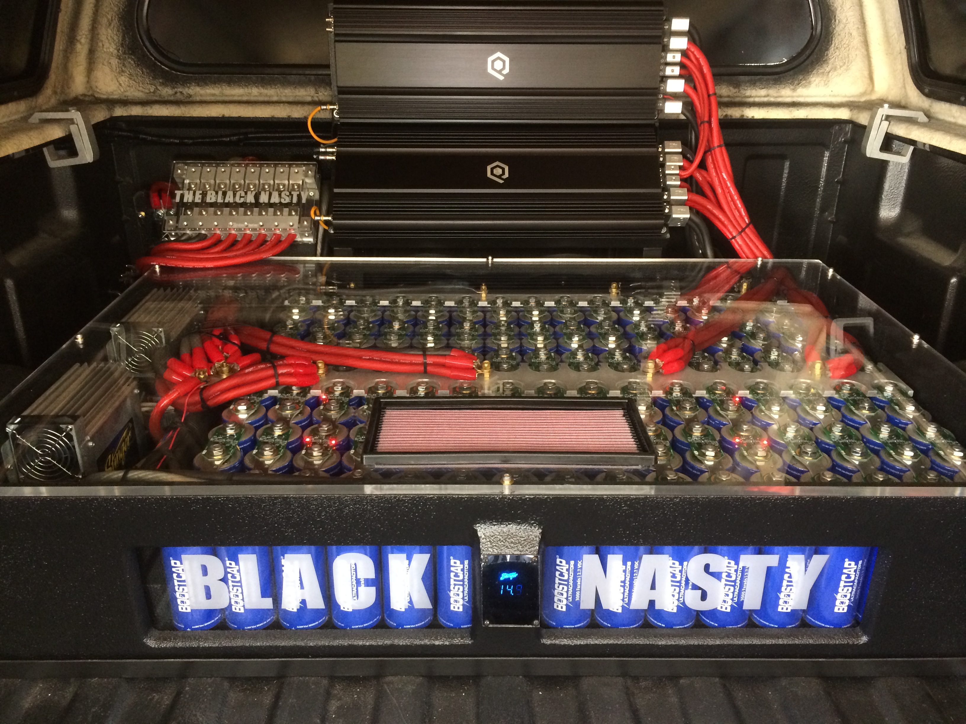

As far as I know, the "Black Nasty" uses only caps and performs great. I won't be big into competing, but after meeting some more local people I'll have access to a meter to see how I'm doing and tweak things.
Yeah, about 8 grand worth and how many alternators and how hard does he really push this for how long? Assuming you JUST need his bank plus another 32 to make each bank of 6 that's a lot of money, but that isn't even true, capacitance in series is the reciprocal of the sum of the reciprocals of the capacitance and you'll need even more energy stored to make power at higher voltage. If you are ready to gamble 10 thousand plus on capacitors my hat's off to you. Let us know how it pans out for you, and if you are going that big perhaps you can get a big group buy on ultra caps and sling a few around here.

Quad 340amp mechman alts and 32 banks
