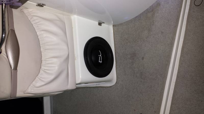

I receive m'y IA 20.1 today and m'y first plane is to run m'y fi ssd 12 d1 at 2ohm,but I think maybe upgrade with xcon and run a 1ohm,but Im scare about the power drawn by the 20.1 at 1ohm because the set up is in a boat and music play for long time with motor turned off,I have 4 batery 6 volts.

What size wire gauge are you using?
You dont have enough current or battery power. They need 12 volt batts. The IA is most likely putting out 10% of what it can actually do because of the lack of electrical support.
For now I have 2 gauge for power and ground,I will upgrade with 0 gauge,m'y battery's is at 14 feet of the amp and group direct at the battery,I also have 1.2f capacitor !

You bass boost is at max? That's why your clipping early.....
Wire can't cause clipping, that's just silly
You have NO power, 4 6V battery's is a terrible idea. You need 200AH of 12V agm power. Really 300
I put m'y gain and bass boost at max to obtain the same bass than m'y old zr360,Yes its crazy!
One 6 volts is 225ah so 900ah for 4x6volts ÷2 =450ah at 12 volts,in boat we ran 6 volts over group 31 deep cycle for better long term power,with m'y zr the 6 volts give me better result than group 31,m'y test is at 14 volts.
I have a old kenwood HU and I think maybe low rca voltage(3.2v with music) and I think m'y HU clipping the signal because at the same time I install à IA3.4 and it clip also at hight volume with hp filter on??
Thank's guys I will retry all that today with à good pioneer deck !
Your ssd isnt going to last long if you're turning the gain and bass boost all the way up.
This is what I think first so this is why I wired at 2ohm,but I try at .5ohm and the ssd take à lot of power and I don't think is to much, I Know this is a no sence!
This is not the first time I try other amp and m'y zr360 win every battle,I realy like this amp but it overheat and shut off //content.invisioncic.com/y282845/emoticons/verymad.gif.3f39c5c2fd57527b671fad3efdfac756.gif
But now I take no chance à buy great stuff and Im not impress with it!
Get a multi-meter and see what your VAC is reading is from the speaker inputs with a -5 db test tone playing. Also get a clamp meter to see how much amperage is going through your power wire.
Just to be sure,I install m'y dmm at input of m'y sub with ac voltage with the sub disconnected?,no problem the clamp meter I will do that!
Thank's again realy☺
