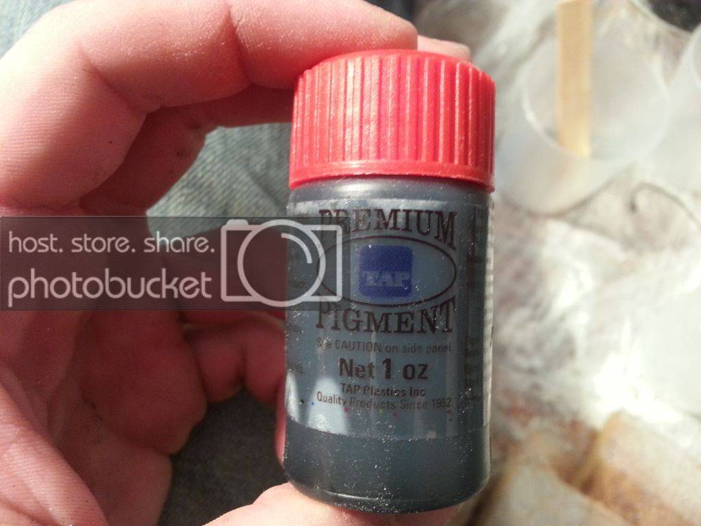

This is the pigment I used. I put about ¼ of it in each time. Maybe more depending on how much resin I am mixing up.

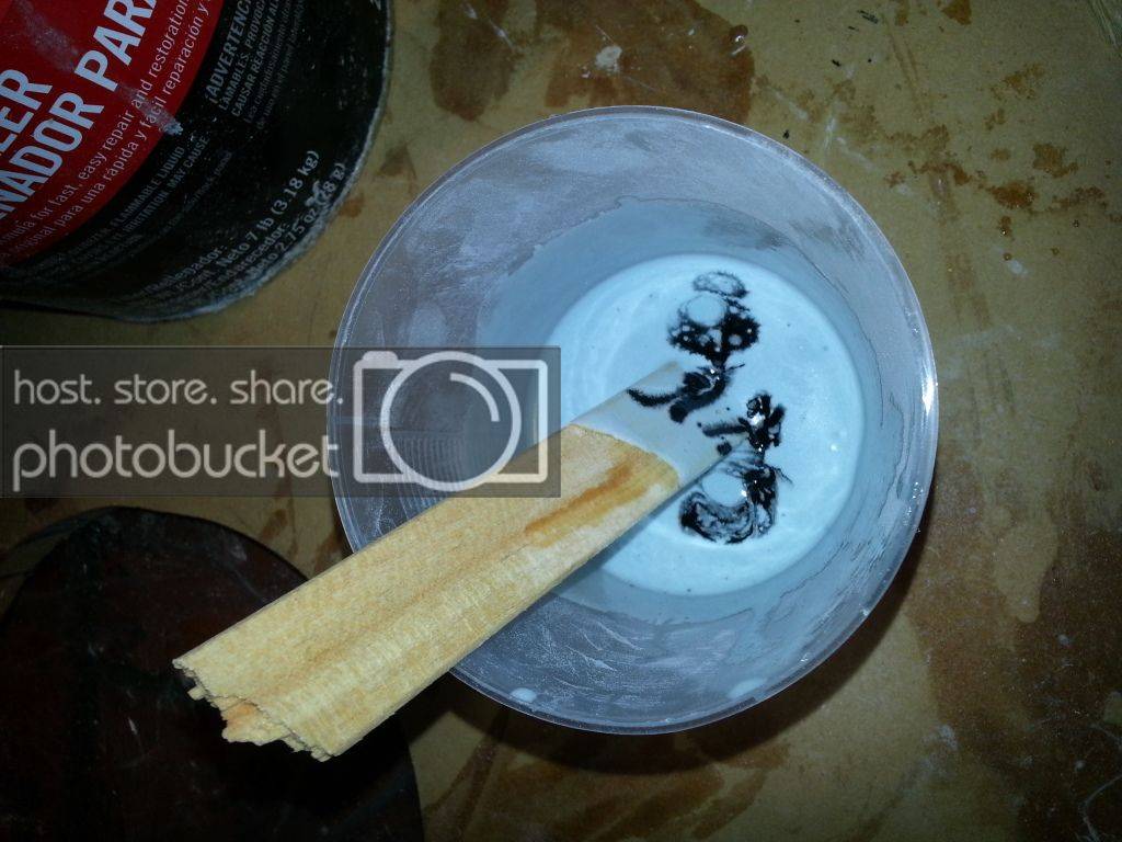

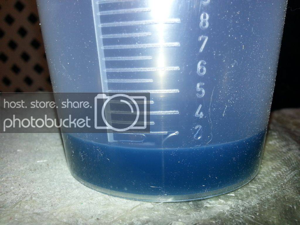

Pic of the resin with the pigment drops in it. You can see the spheres turn the resin into a blueish color

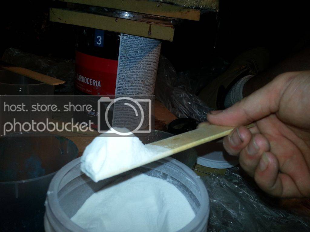

What I consider a scoop of spheres to be.

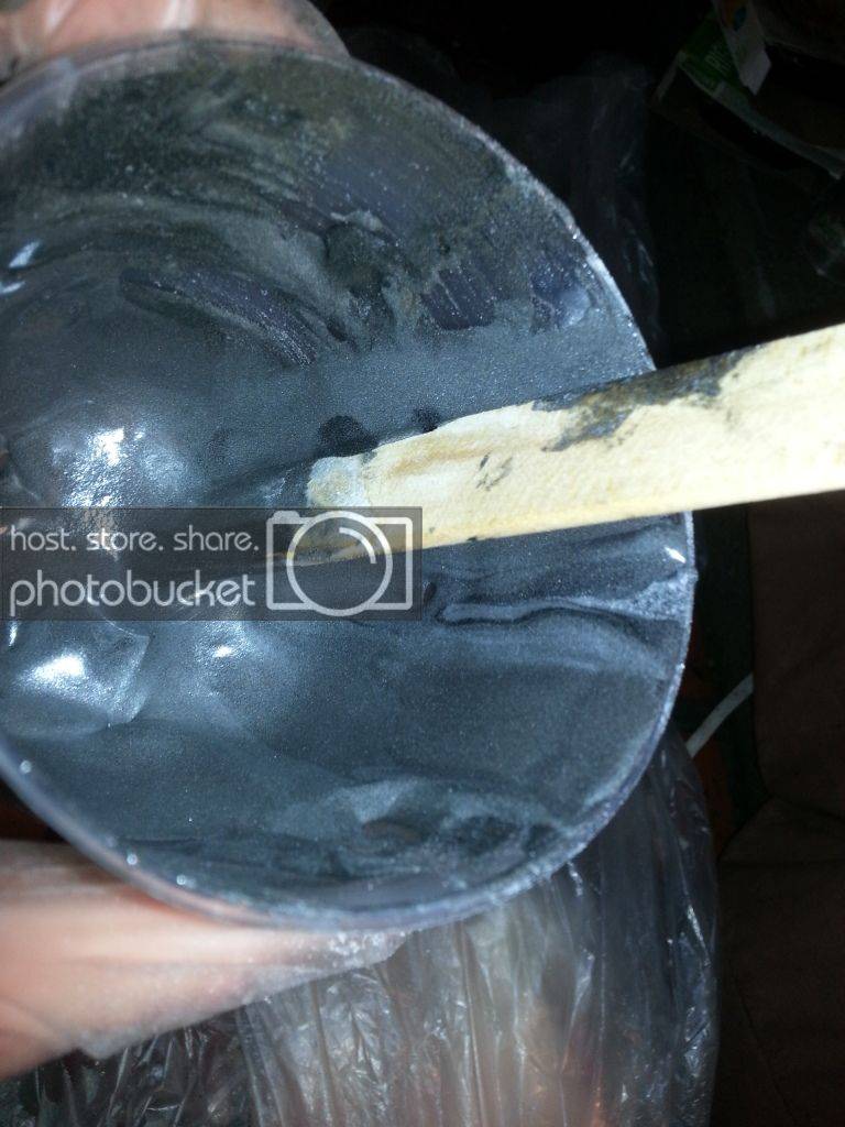

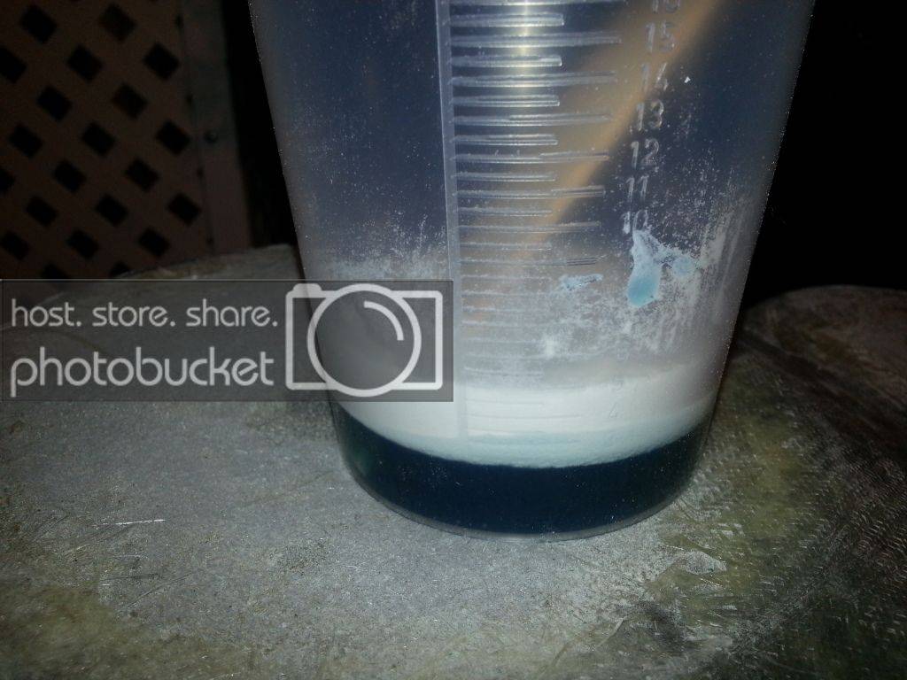

Here is what the resin looks like after you mix in the spheres and pigment

This is what roughly 6 scoops of spheres looks like. You can see how much space it takes up in the cup.

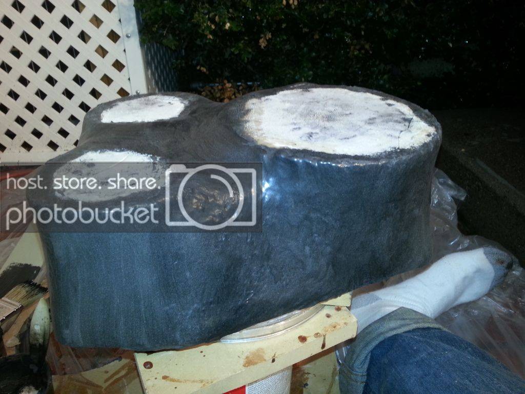

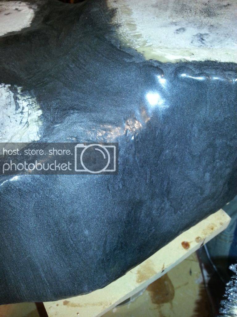

shot of the good panel after the 2nd layer of spheres

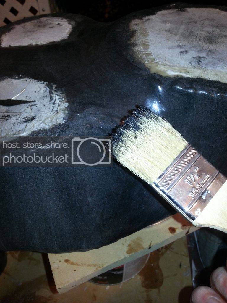

To spread the spheres mixture I use a new brush and gently sweep downwards, with the brush oriented as vertical as possible to get a long sweep with each stroke. I found the more vertical/drastic angle I had, and the cleaner the brush (I used about 6 brushes perfecting this layer of spheres...but I'm weird like that) I had much better and smoother results. Long, sweeping strokes were good for initial orienting of the panel, but as I really wanted to perfect it and it got drier, what I would do is short, gentle strokes. I would use this drastic angle on the brush and take areas of buildup that were higher than others on the panel, and gently move, with a soft sweeping motion, the areas and spread them out to other areas of the panel. It might take 40 strokes to go from the bottom of the panel to the top, but it made for a very, very smooth panel and finish.
