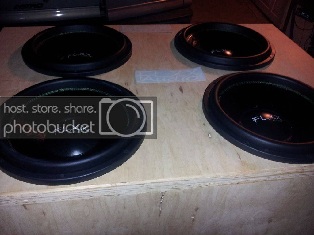

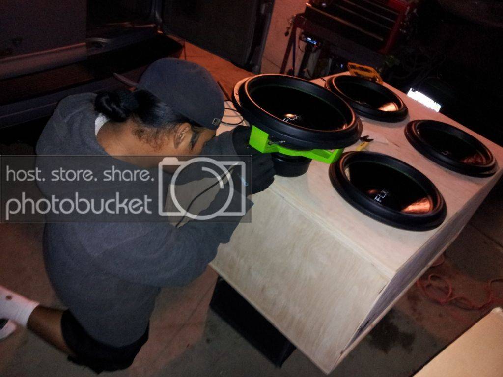

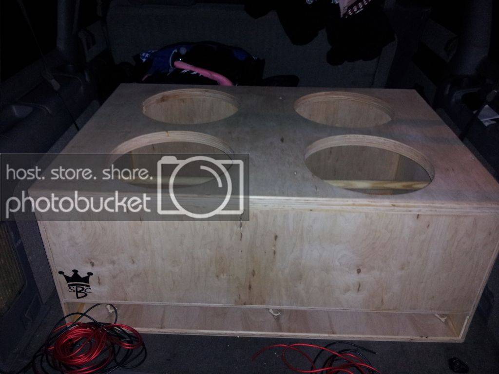

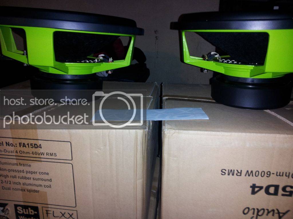

Been occupied with other **** lately but anyway, got my box from Steve Beats double baffled birch wood box tuned to 35.5hz
Very satisfied with the box & subs i just got the box today an installed them i have 4 d4 subs wired at a 2 ohm load, i havent tested for box rise or clamped power yet but ill add numbers later.
All & all Im very with the subs an box great clean bass,
have the gain on the amp at around 50% at 2 ohms plus i haven't accounted for box rise or did clamped numbers yet.
Nothing extreme i have a h/o 240 amp alt yellow optima up front 2 cnc 470 batteries in the back with 2 aw welding wire power ground ran from up front. i have constant 14.1 14.0 when playing, i have the amp set at half gain at the moment at 2 ohms just installed tonight. im on prs 80

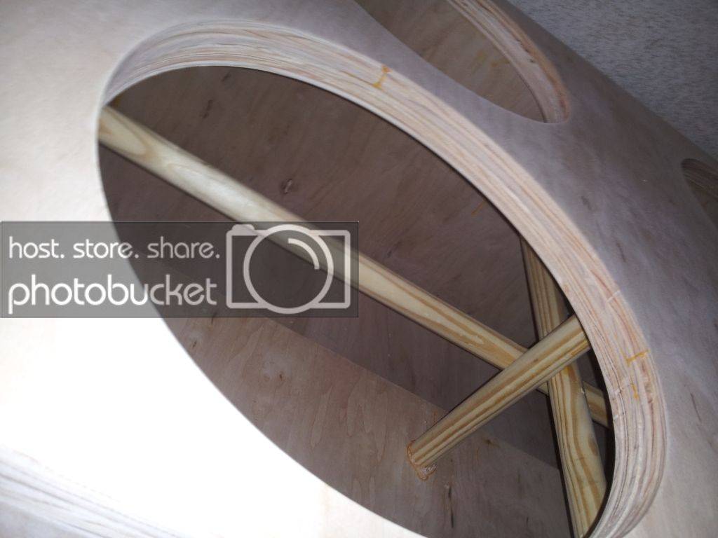

I love how those subs look. Color scheme alone makes me want one LOL. Heard good and bad things about them but every time a new sub comes out you get that. Would love to try one for myself. Box looks good but I would have done some tougher bracing myself. I'm sure as you aren't chasing numbers though it sounds just fine
